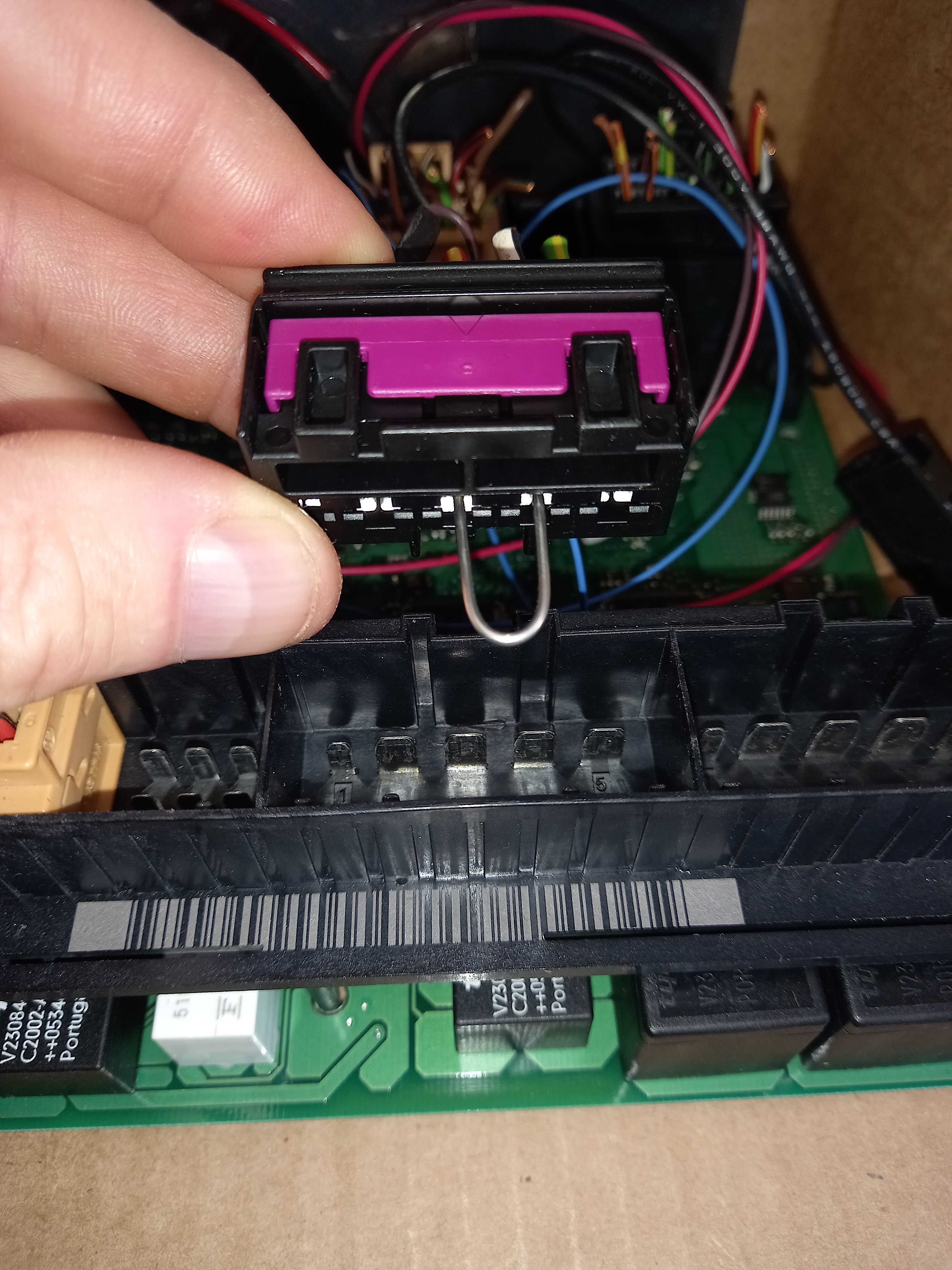

If you can hear the relay clicking, try bypassing the relay as follows:
Open the car but don't put the keys in the ignition, keep them in your pocket.
Unplug the connector (black 5-way) that goes to the plug above the relay, it will be labelled XP4 on the control unit cover. Link pins 3 and 4 (red/grey wire to white/black wire on your car) as shown here. The wiper will start immediately at slow continuous speed, and only stop when you pull the link out again. Refit the connector.
Just a warning to avoid surprises - when I did this exact test as described on my 9N Polo, which has very similar electrics, the wipers came on as expected. But the radio did also, which startled me a bit.  Not sure if yours will do the same, but don't be surprised if it does! :D
That connector includes the main earth connection to the control unit, which is why I suggest not having the keys in the ignition, and replacing the connector after the test before doing anything else, to avoid unnecessary errors being generated.
I don't have a photo of the control unit in a LHD car, but imagine a mirror image of this, over on the left side above your clutch pedal, instead of the right side above the accelerator:

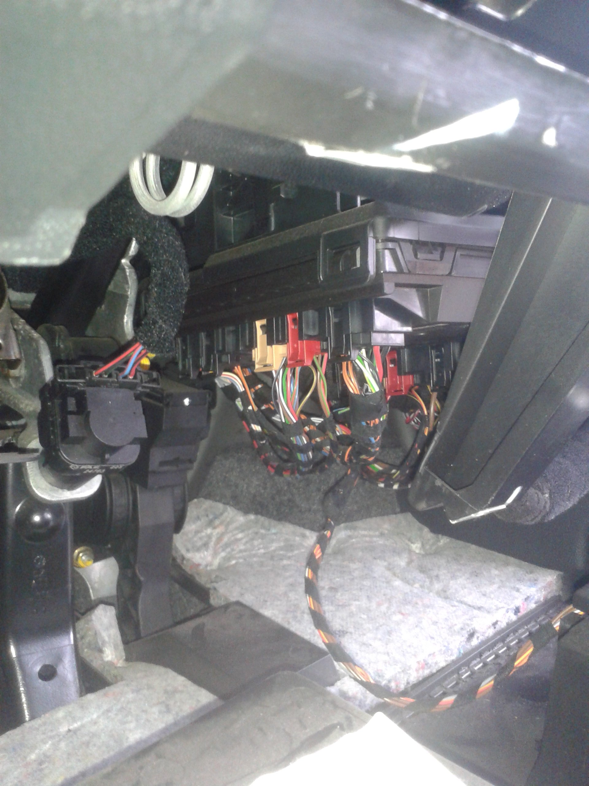

Okay so this is the control unit? And inside this there will be a relay, that i need to replace?
Yes. Have you looked at your car yet to find it?
