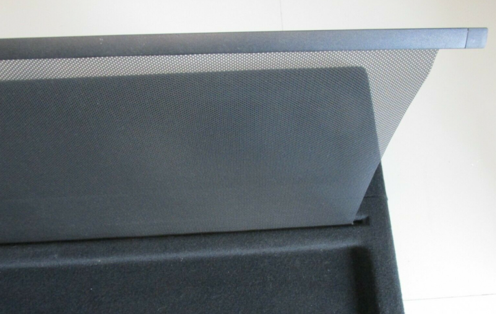

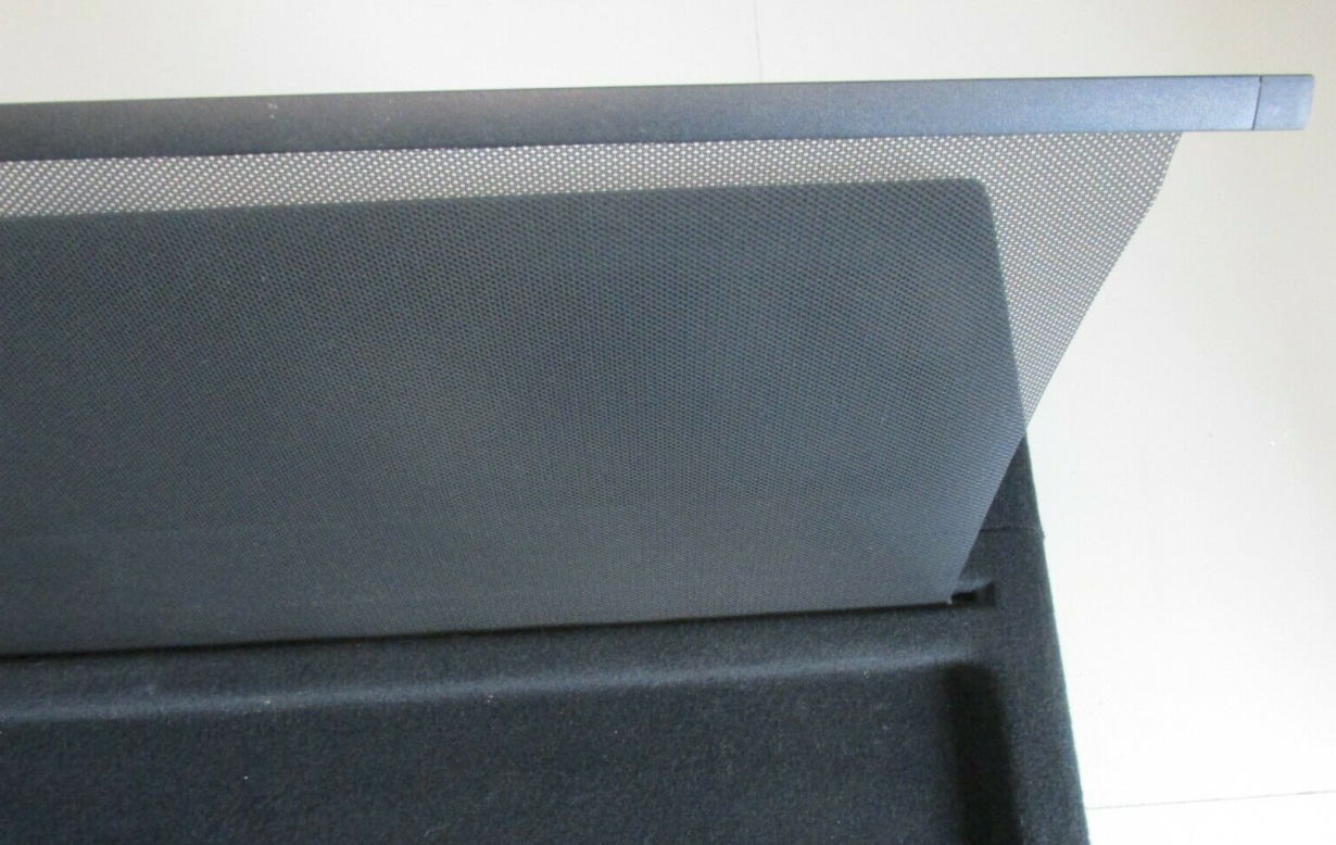

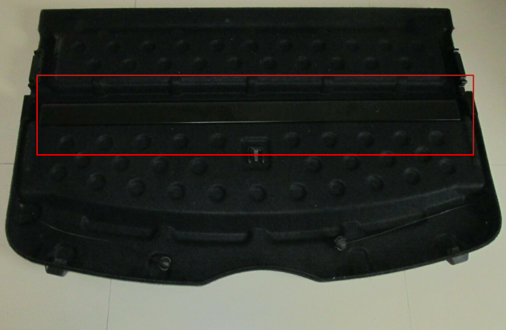

  - My problem starts when the sunshade placed on parcel shelf stop folding back, its folding 50% only and nothing more.
  - I went to official Skoda dealer for this issue and the answer i received was not very nice (it can't be fixed and that i need to replace entire parcel shelf for 250€)
  - I decided to google it and that's how i ended here :D
  - From the research from briskoda i've take things in my hands and i have repaired it my self
  - Result was sunshade on parcel was working 100% for around 30 days, and after that im back at lvl 1 and same problem all over again
  - My question now because i want to put an end to this issue(im driving with sunshade on all the time 😛 )
  - Can i replace only the sunshade with the mechanism under the parcel shelf if this is possible please give me the part number
  - For things to be clear pictures are here.

What did you do to resolve this the first time?
I’m not sure how they work but I’m guessing they’ll be a cog somewhere which has broken a few teeth maybe?
Id also lube it to death with silicone lube spray and see if that fixes it, if it does then you’ll need to see if you can apply a grease for longer term fix, if nothing is broken that is
There is coil inside the metal plug with 2 small plastic pieces and tiny aluminum handle. Nothing was broken its just displaced but this parts looks and feel like they will crash any second. I just had the feeling that after fixing it that it wont last long. P.s. its a 2 men job you cant doit alone
Just had a look and your dealer is right, there's no replaceable parts 😞
There does seem to be revisions though so most likely better plastics inside so it doesn't break again.
What P/N is your parcel shelf?
