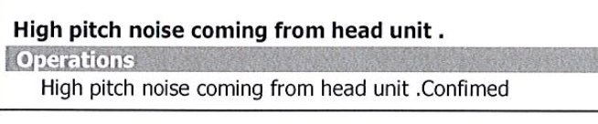

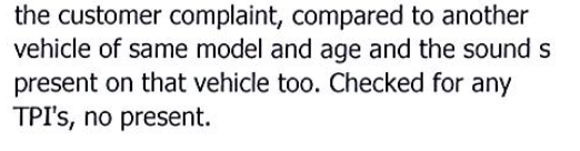

Have the same issue with our  late 2019 Model Fabia and reported when we took for 1st service a year ago now, wasn't impressed with the response from the dealer, see snip from the service report, basically fobbed me off as if I was an idiot,  explaining nothing wrong as they all do it, I did say what's the point having crystal clear DAB radio if all you can hear is the electronics oscillating above the volume. They said nothing else they can say or do about it. Great thanks for your help😆
