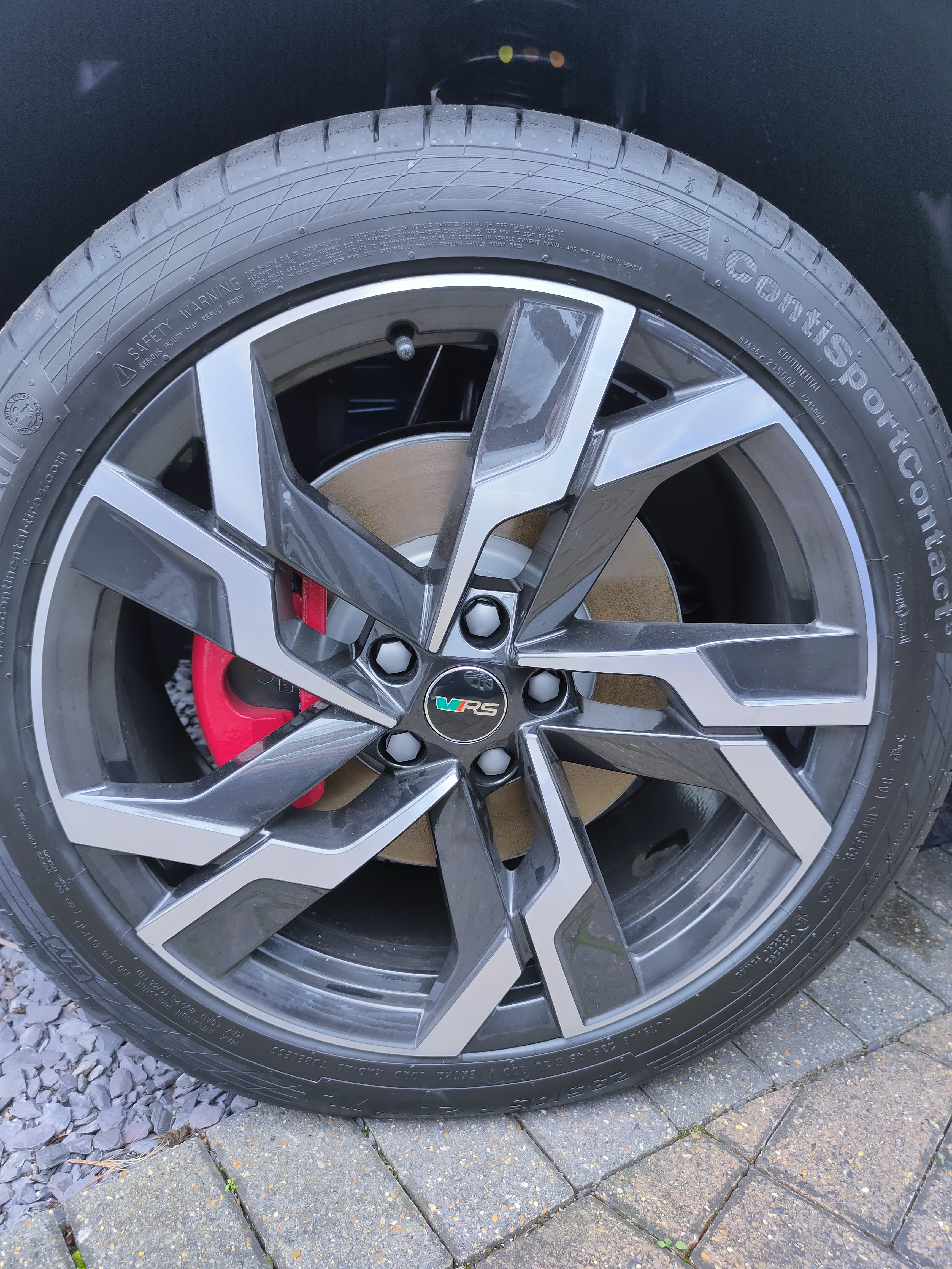

  • Here is mine with aftermarket centre caps they were a little loose had to wrap electrical tape around the prongs but they fit a treat now

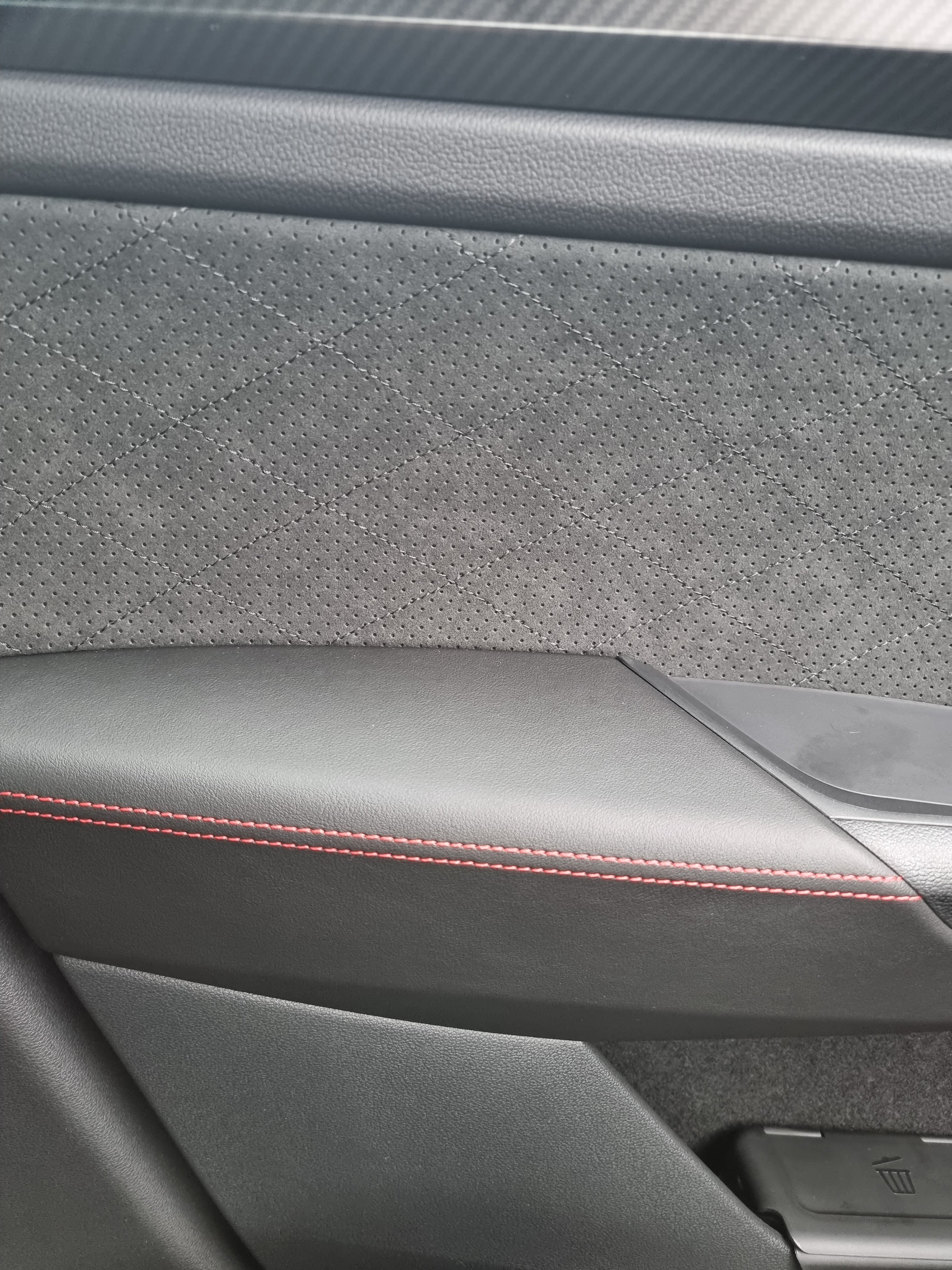

43 minutes ago, shotto29 said:
That's a little annoying though red stitching all over except on the door card patterns
lack of micro chips 🤔😆
(Its funny you mention this, when i looked at mine yesterday i thought something was different, but couldn’t work out what. Now i know, mines the same as yours, just grey).
Personally, I'm good with that. It would be a bit much if you ask me...

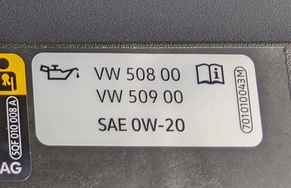

What oil are you putting in it?  0w-30?  0w-40?  5w-30?
I prefered it when all cars used Castrol GTX in a white tin whether they needed it or not!
Plate under the bonnet of the VRS calls for 0w20.

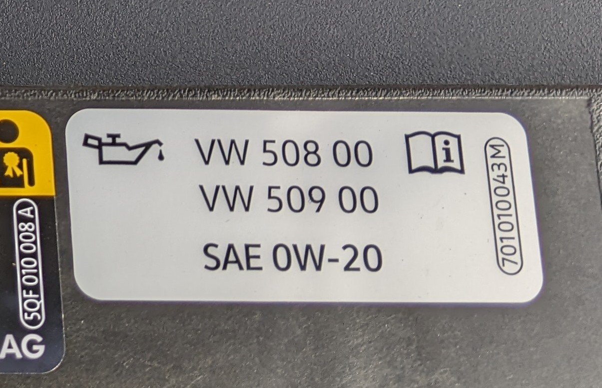

Are you sure?
Or does it say VW508.00/509.00?
11 hours ago, xman said:
Are you sure
Yes it says both, definitely including 0w20 as well as the VW type numbers.

15 hours ago, roottoot said:
Many are now using 0w 30 FS.
What Oil did your Skoda dealership use in your car?
Are you saying garages are using 0w-30 ( VW504/VW507 spec ) on newer engines? Which gargages?
Both my cars ( 1.5tsi ) were serviced at franchised dealer in November - just checked the paperwork, both used 0w-20 as stated.

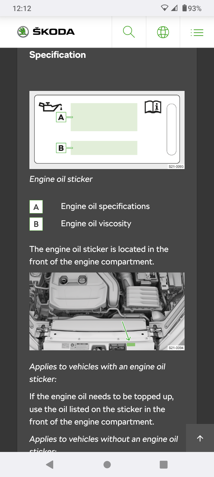

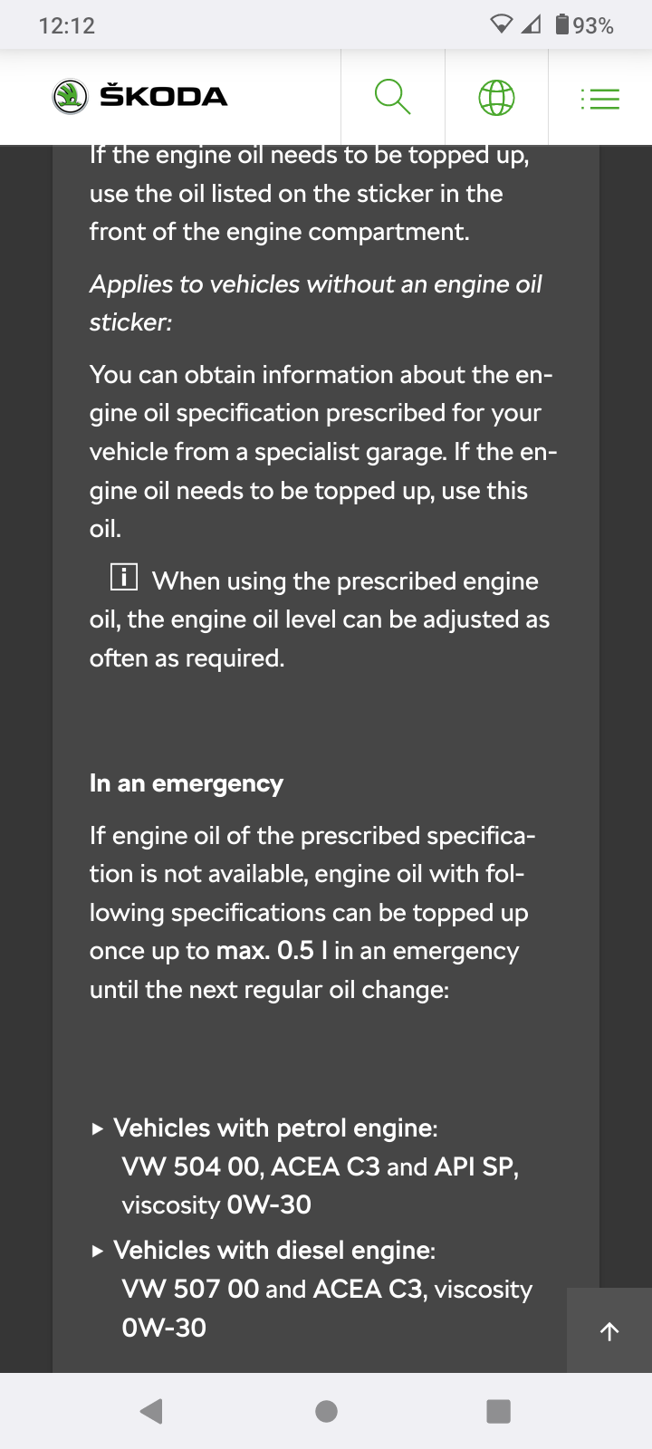

Latest Superb manual now states use the oil specified on the slam panel sticker, if there isn't one then consult a specialist garage or use 504.00/507.00 oil 0w30. This applies to all engine variants (2021/11 onwards) not checked earlier manuals.
Screenshot_20220208-121223.thumb.png.0c3b5e409cfd560b06c7dfdce9ce18de.pngScreenshot_20220208-121241.thumb.png.4fb5dd8ca6e554a0bfbf22f707c1920d.png
It will be interesting to know if that might be for non EU WLTP Certificated cars like in Australia.
