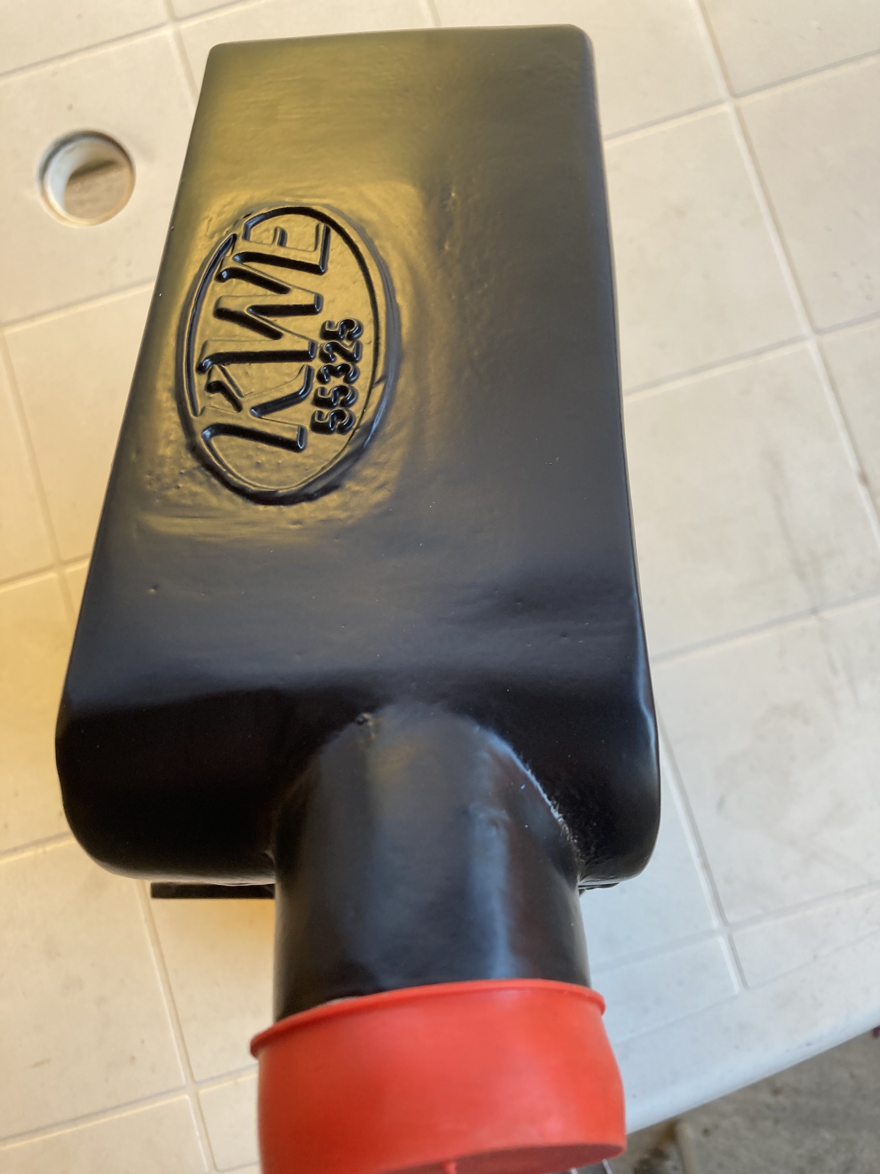

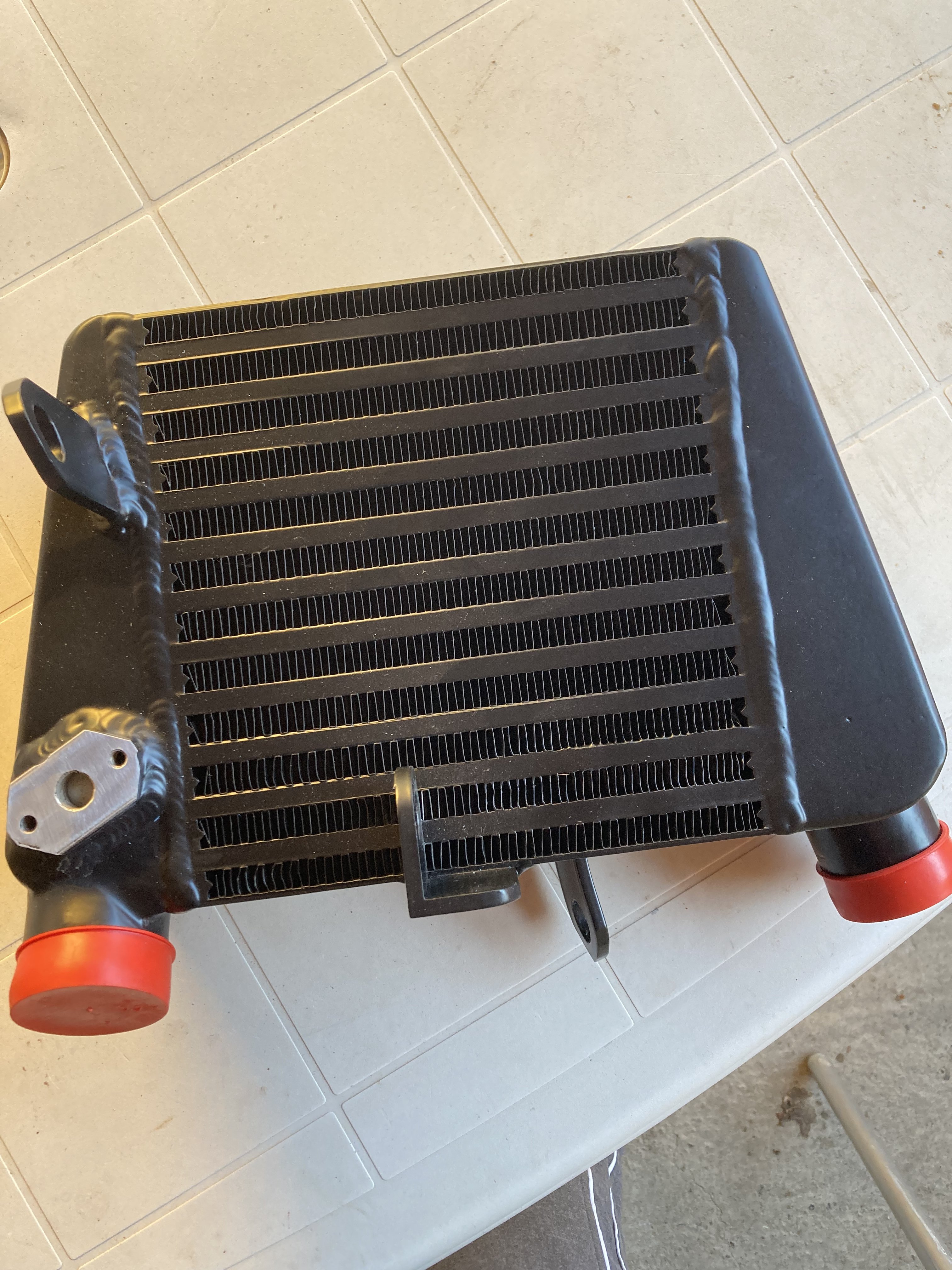

The other question I have is regarding the remap. Is 1749vb turbo a plug and play fitment on a BLT as well? If yes, is Melett a good option? Is this SMIC that I got any good for 180hp, if it’s even better than the stock one?

I think you should fix the car before fitting upgraded bits, that SMIC is a like for like swap so I'm unclear why you're bothering.

So money wasted on that SMIC 😅

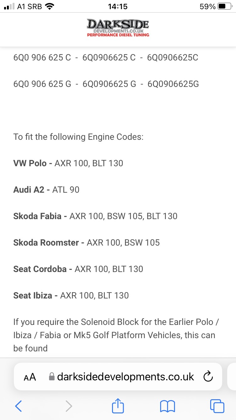

So, the box is definitely toast. Again threw the EGR code, sometimes buzzing and there is a weird aghhhh sound when I switch off the car. So guys, justto confirm, am I looking at either of the two numbers here for the BLT engine, either C or G?

Yes, does it matter whether it’s a C or Gat the end of the part number. I guess not. O found a used one with G for 50 euros?

Suffix G part superseded the suffix C part in Oct 2008, so either should be fine.
