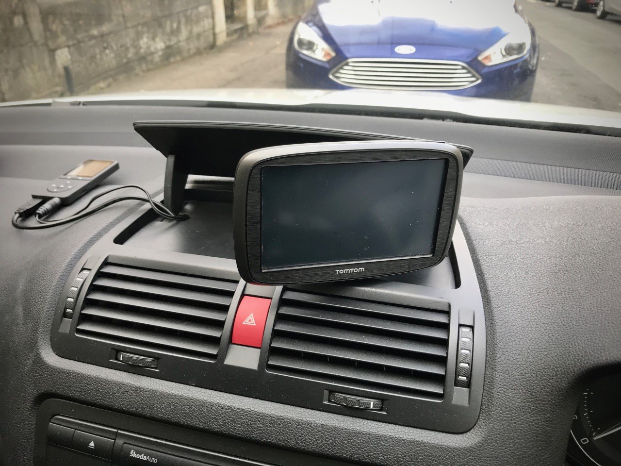

I’ve done this. I made a plastic base to slot it in and attached the Tomtom on top. I’ll get some pics tomorrow for you
nice one thank you mate

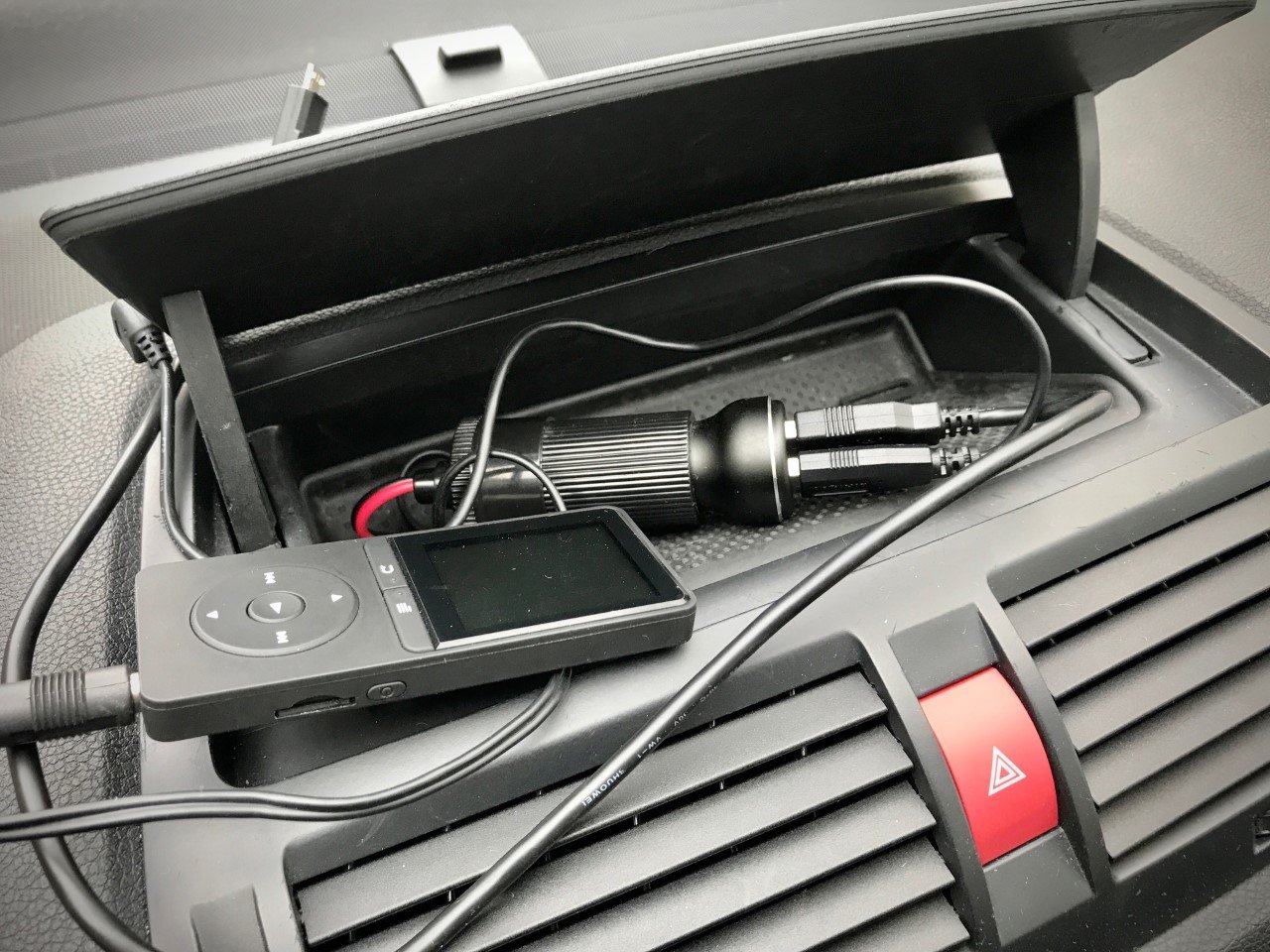

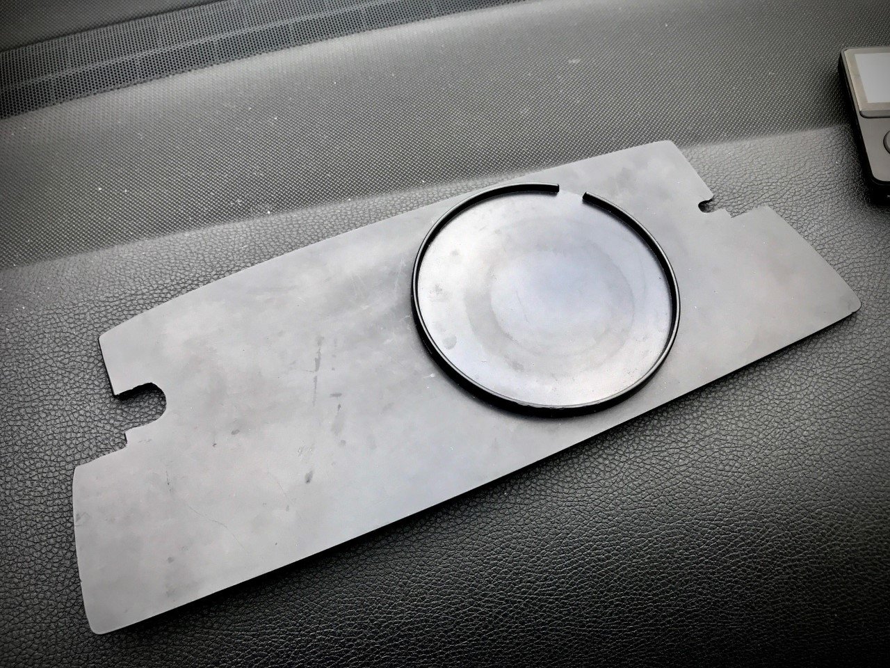

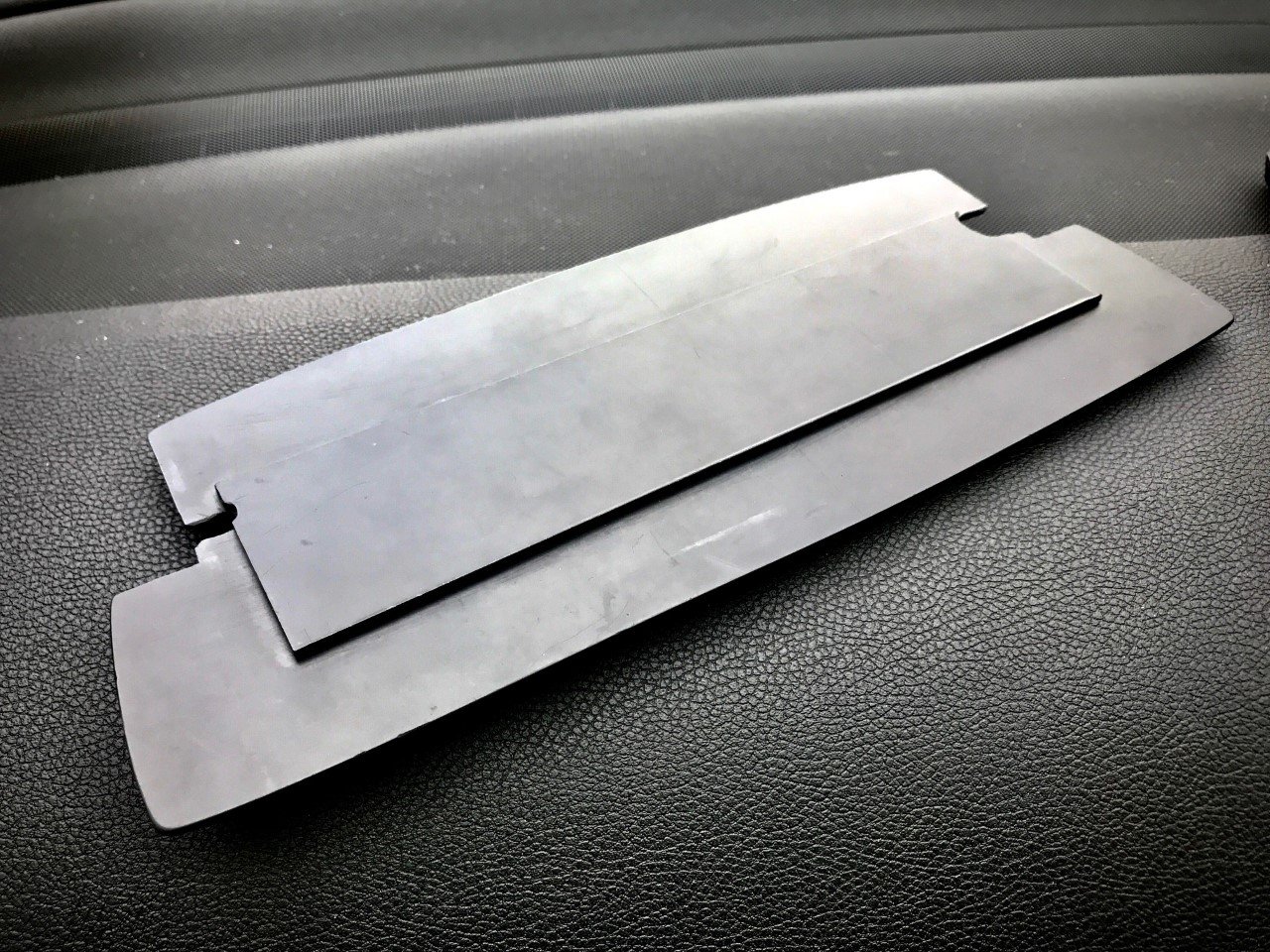

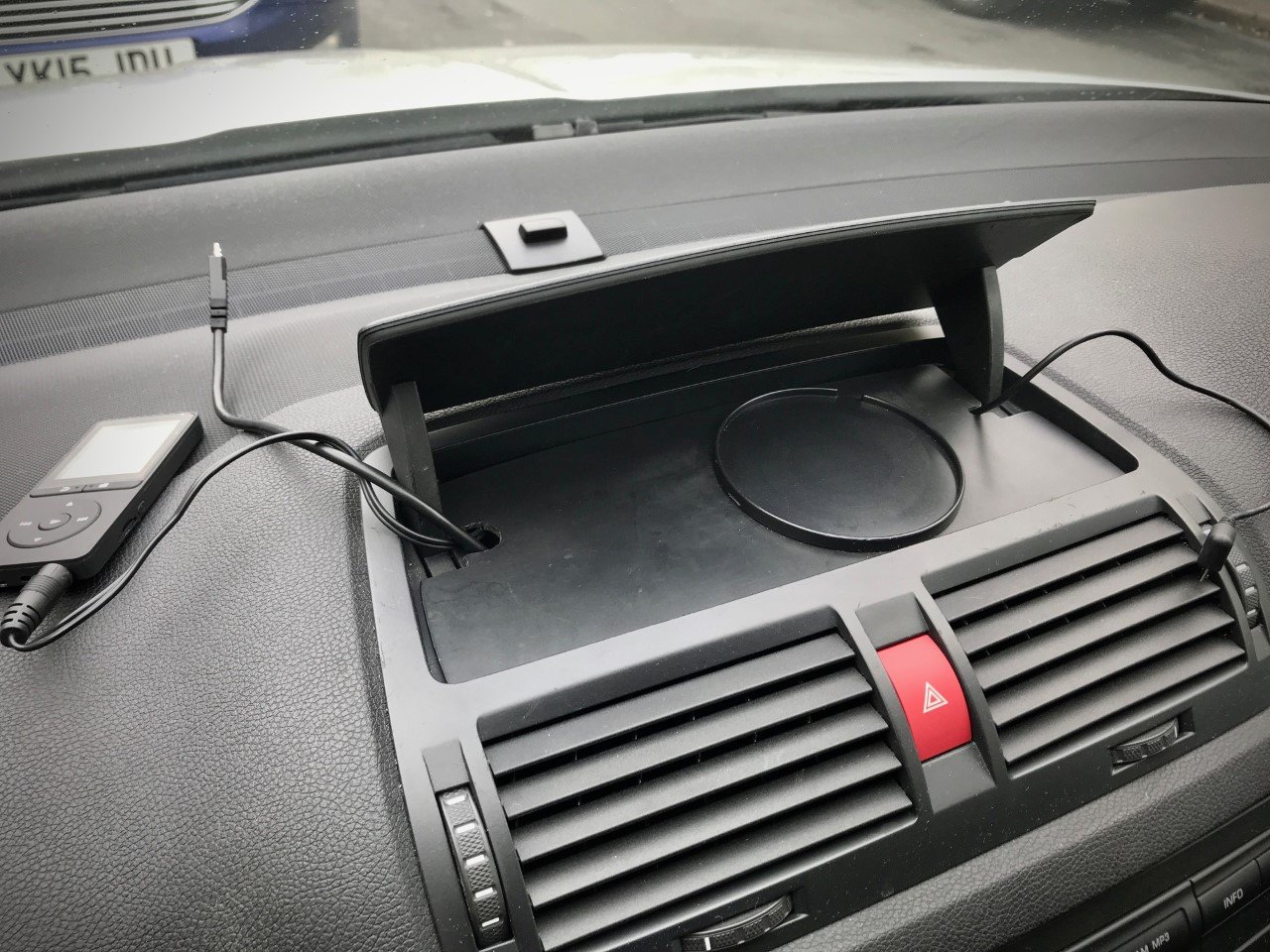

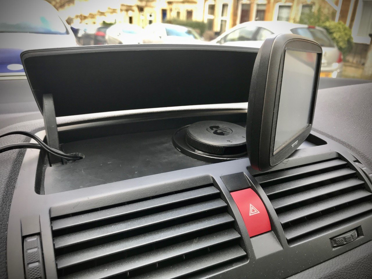

So this is what I made a few years back. It work for me. I took a power feed from the fusebox and fed it up to the cubby hole and attached a cigar lighter socket to the end. Out of this is a dual USB adapter.

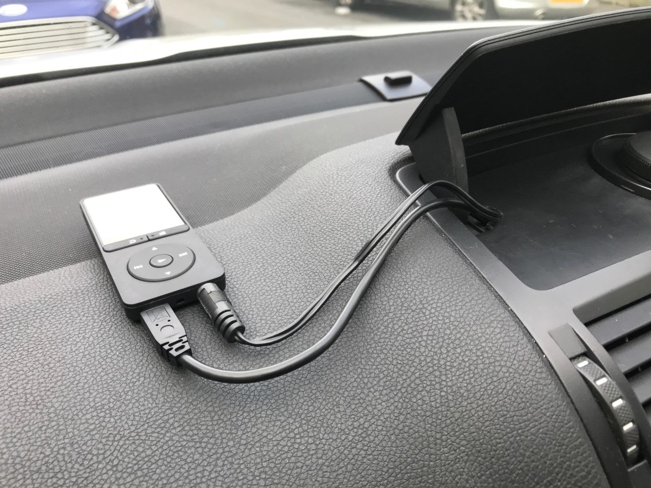

I also ran a lead to run an MP3 player too.  The top plate was made from thick Plasticard from a model shop with a stiffener bit glued below. Suction cup mount stuck on top.
Pics explain it all.

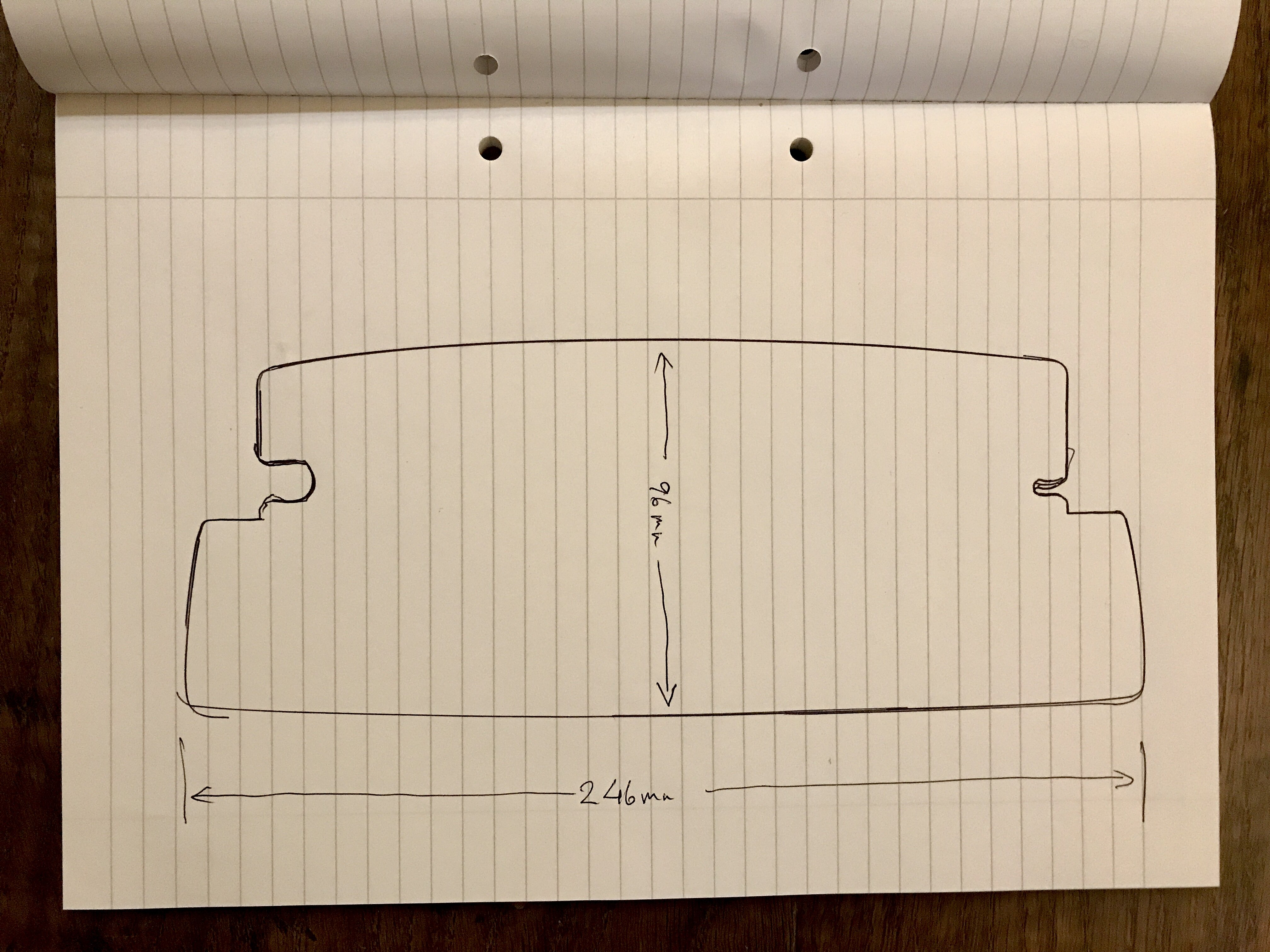

mate that is exactly  what im  looking for .. would it be possible  to  get an out line of the  plate you made  please ?
Here is an outline of the board
legend mate ... thank  you very much ...
