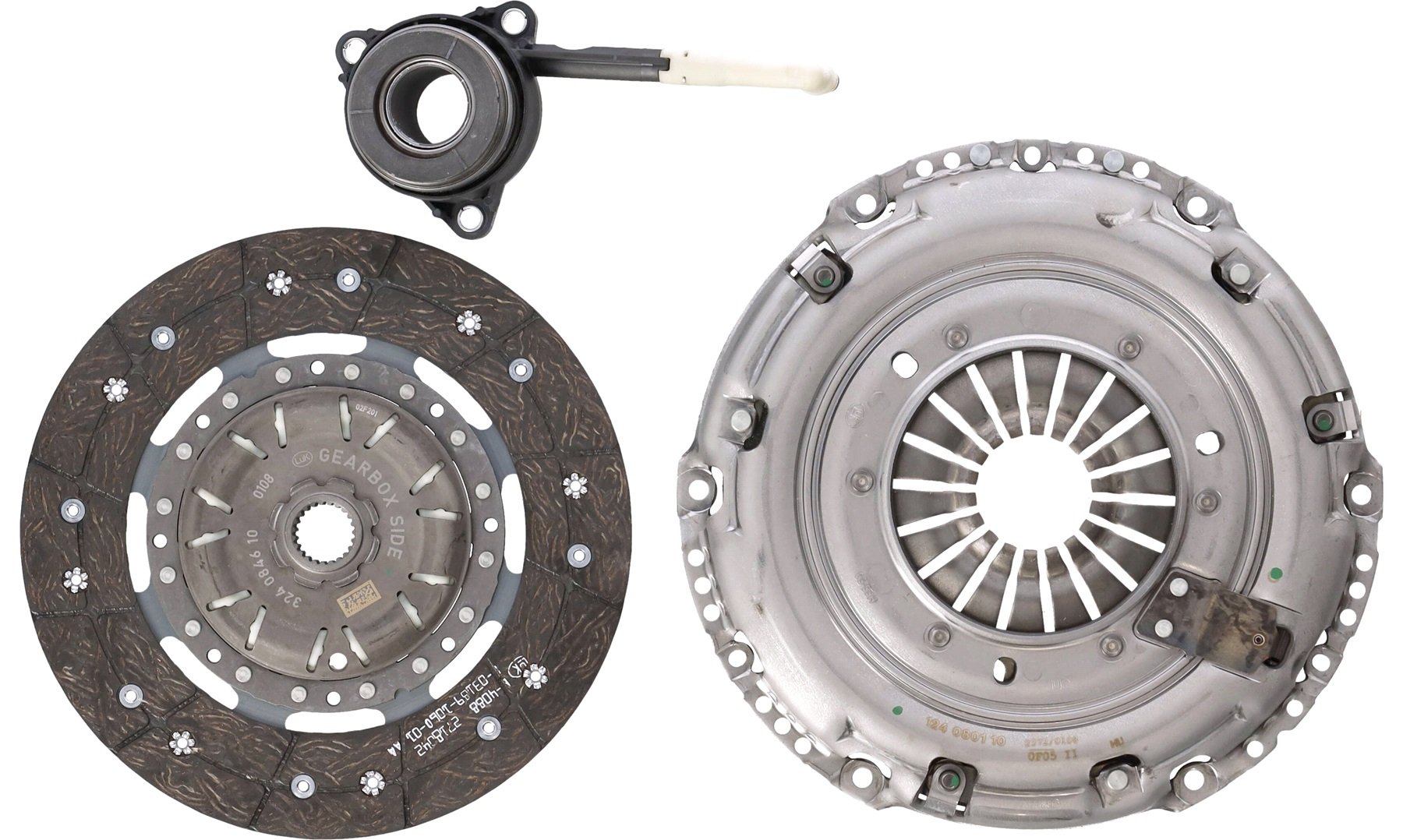

In the past I have come across the clutch plate being fitted the wrong way round. *
But non the less, this doesn't sound right.
* look at the picture you will see what I mean. It clearly says " Gearbox side"

If you look at the picture above, on the slave cylinder you will see a joint between black and white plastics, this contains an O ring and is inside the bellhousing, air is drawn into this joint but it never leaks fluid, it defies logic as it has a positive head pressure from the master cylinder but I am 100000% positive that this is the cause of the many reported clutch problems like yours and mine which took me 6 months to diagnose and finally resolve when I was having to bleed the clutch every few miles of driving.
In your case the garage probably has not actually replaced the concentric slave cylinder when they saw it was not leaking, I would not even fit the one that came with my clutch kit, I found a new old stock VAG part made in aluminium in one piece without the joint and used that.

It will not be the wrong parts or the driven plate fitted reversed, that would have been apparent immediately and would not cause air to be drwan into the system.
