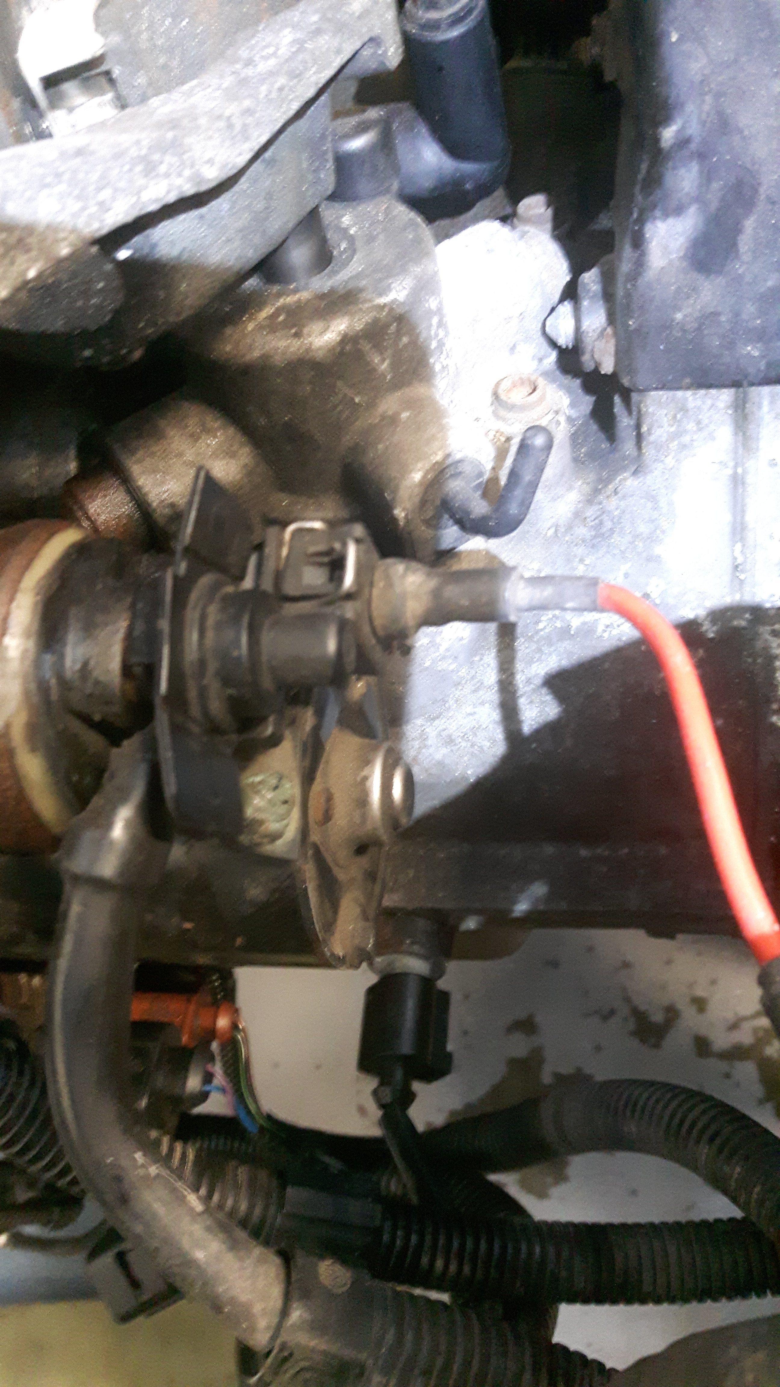

Probably the starter solenoid wire about to give up due to cracked insulation and resulting corrosion of the copper strands.
Here's a photo of where it is, the red wire in the picture is a repair I did to ours a few years back, original wire is red/black I think, and thinner than that.
Thanks Wino, the pic is really useful, I'll give it a good look over.
