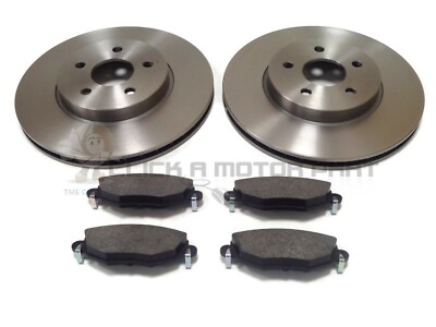

Without going to something expensive as Tarox you mean something like this style or like this one?

Looks like they work well under high heat, but they won't have any impact in creating less heat - keep in mind stopping power is a direct result of friction on the brake discs, the only way you could properly improve this is more airflow and a bigger surface to dissipate heat.
