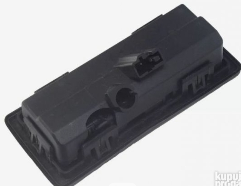

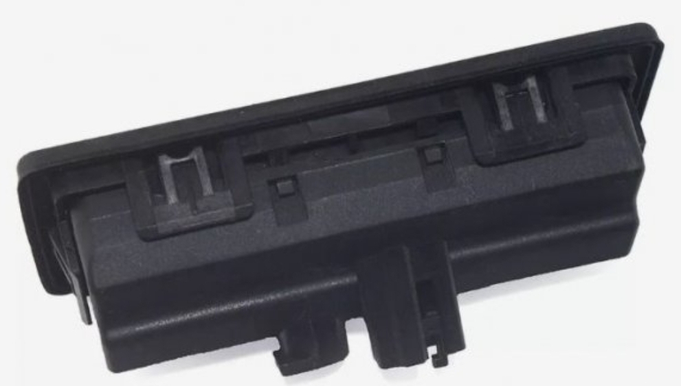

I bought the whole part of the Release Handle Switch from Nirro Ltd. It was second hand and quite straight forward to replace.

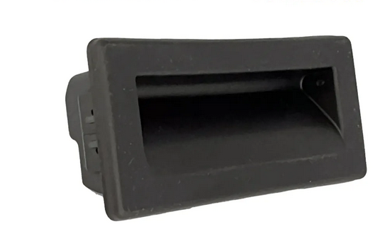

Is that mean, that i can do it, (change it), from the outside?  Whitout removing inner panel, or trim in the boot
Only whith flat screwdriver
I saw Release Handle Switch, from the other side. there are no screws...

I just bought one from Nirro Ltd for £25 with a 30 day warranty. I’ve got some trim removal tools and I’m going to try getting out from the outside first. I will let you know how lt goes - mine is a 2017 66 plate so fingers crossed
Update: part arrived in post today and I installed it in half an hour from the outside without removing trim. I loosened the edges with plastic tools then using automass's advice I used a long bladed flat screwdriver and it popped out.
The other 20 minutes was spent trying to get the wire connection off which is clipped in and I was frightened of breaking it/. So its in and working ....for now anyway 😁
Thank you @automass - you've saved me a few hours

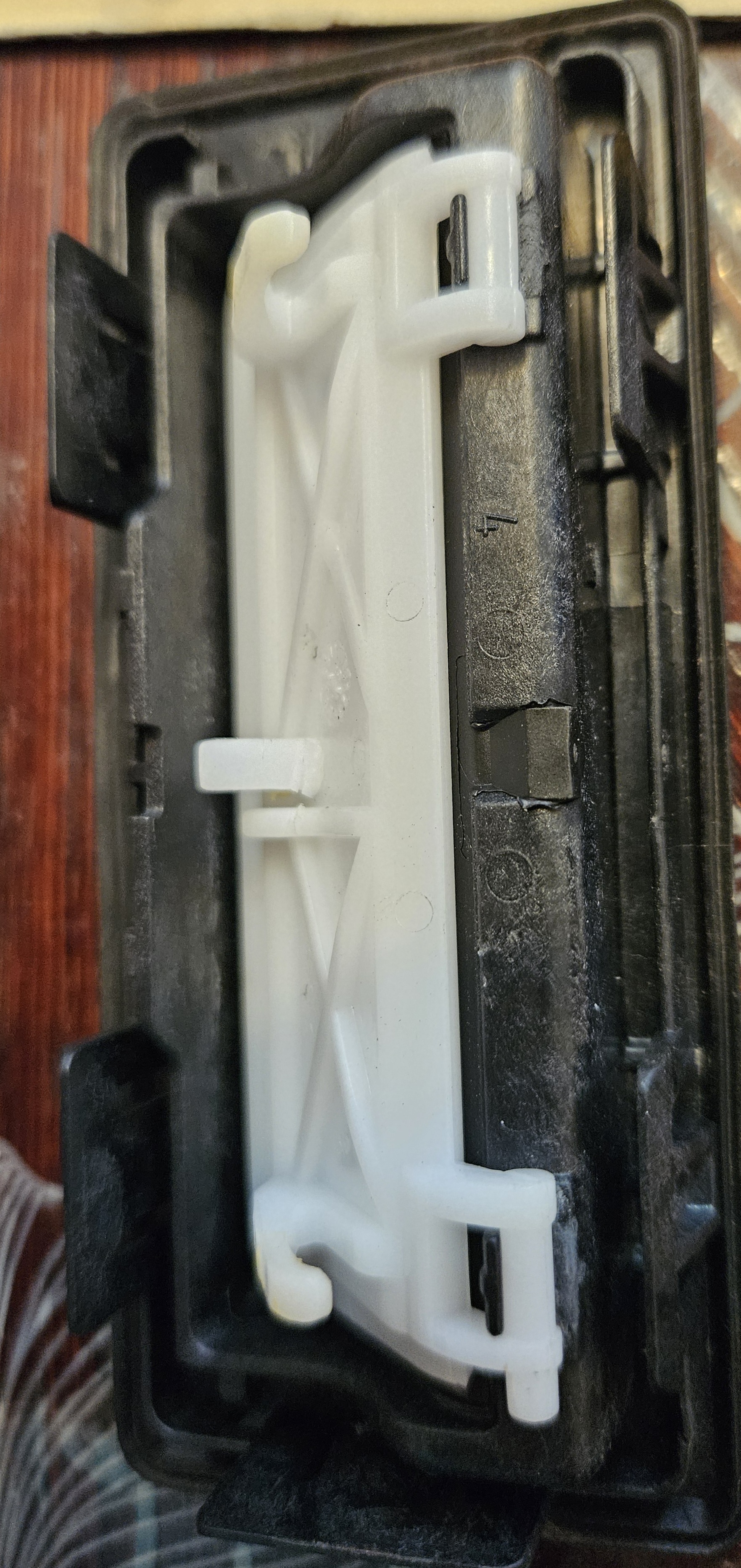

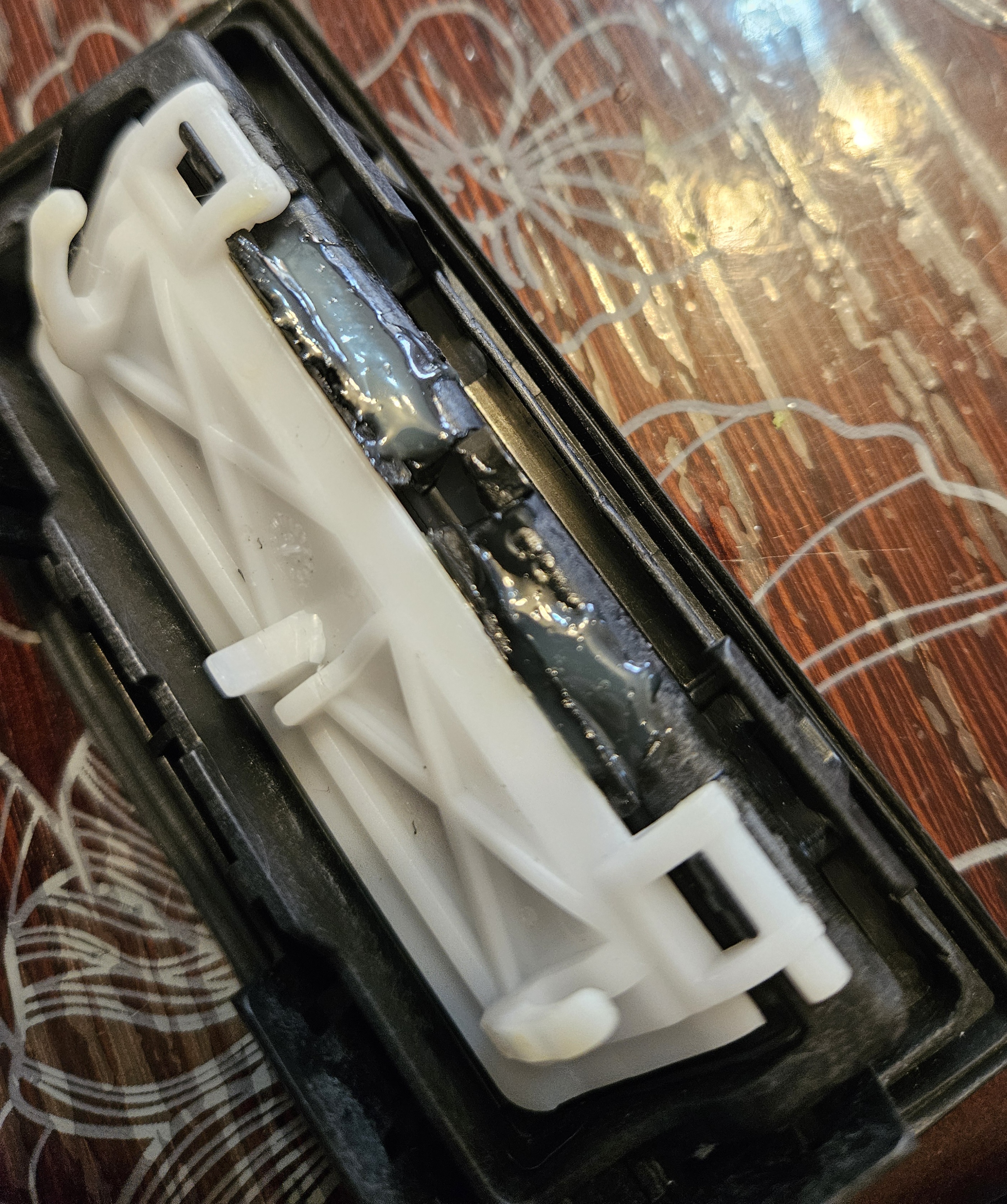

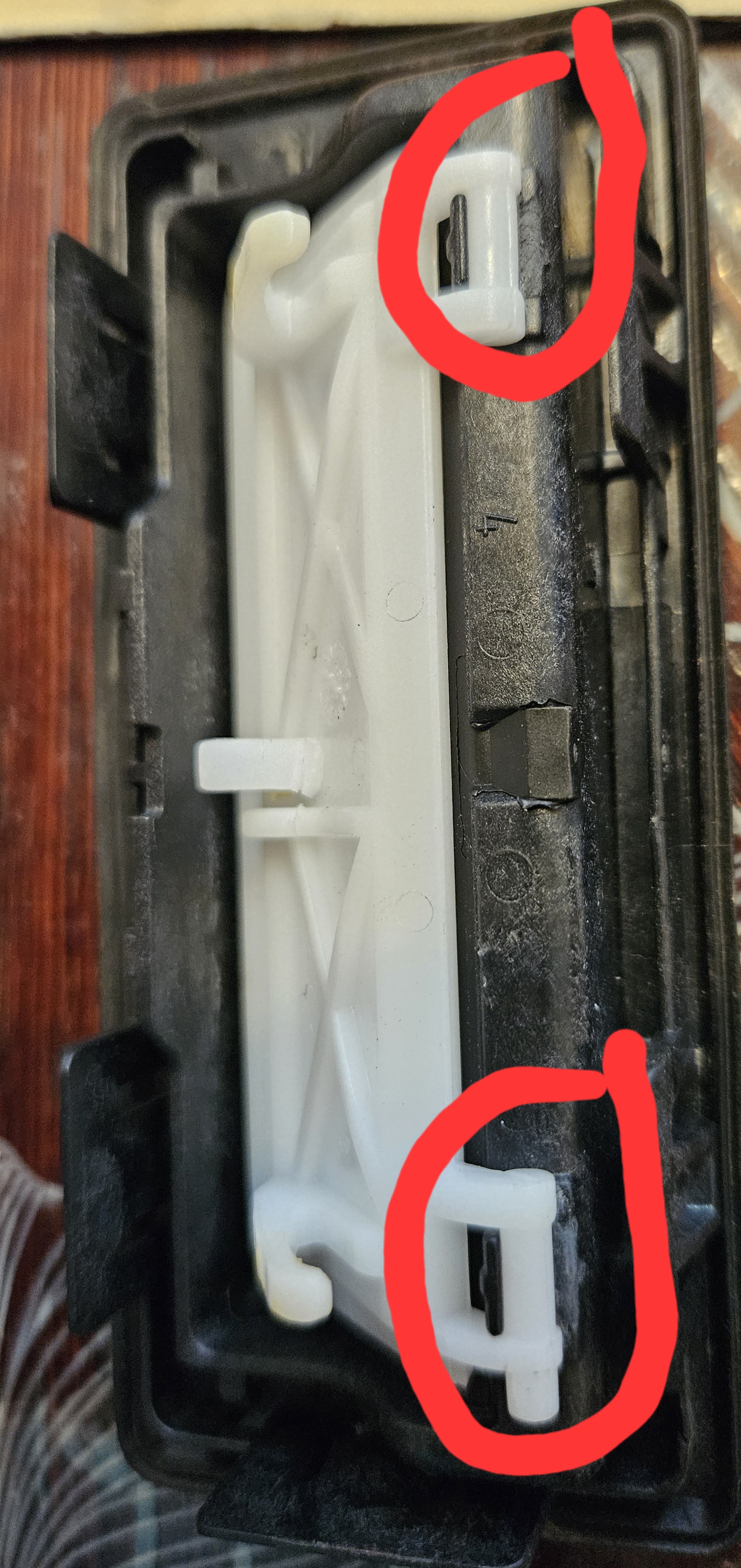

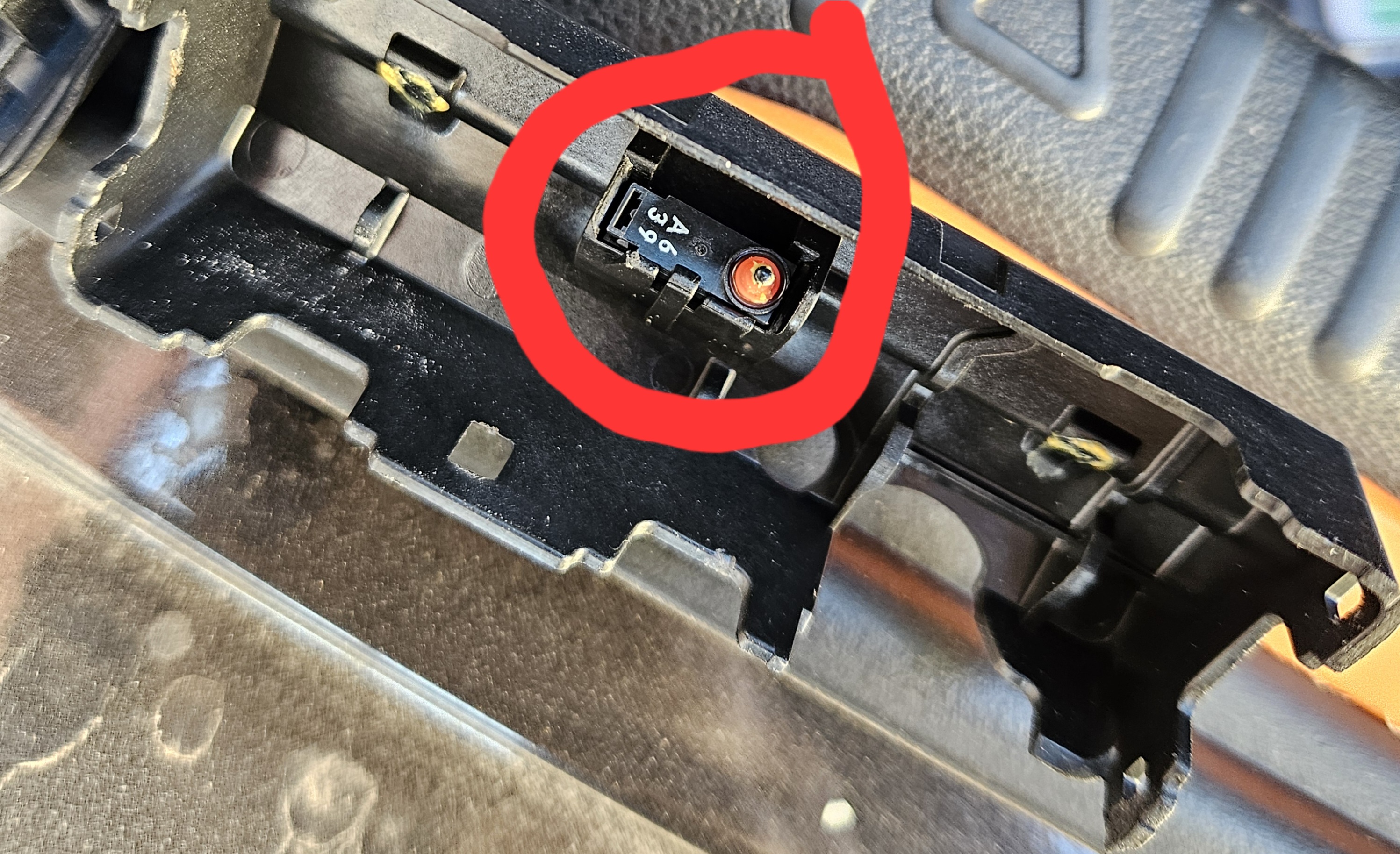

I have found the problem. I have opened mine.
It is not electrical problem. It's mechanical.
Micro switch i fine. Work well.
Place were white part seats is broken (i dont know english word for it.)
20231231_123235.thumb.jpg.09846e66c311f2f2c86d28bff647e05f.jpg20231231_121359.thumb.jpg.3181d22b13fe8bbdeb82fa62e468e7fa.jpg
I have put some other plastic part, and glued it. For now, its works.
