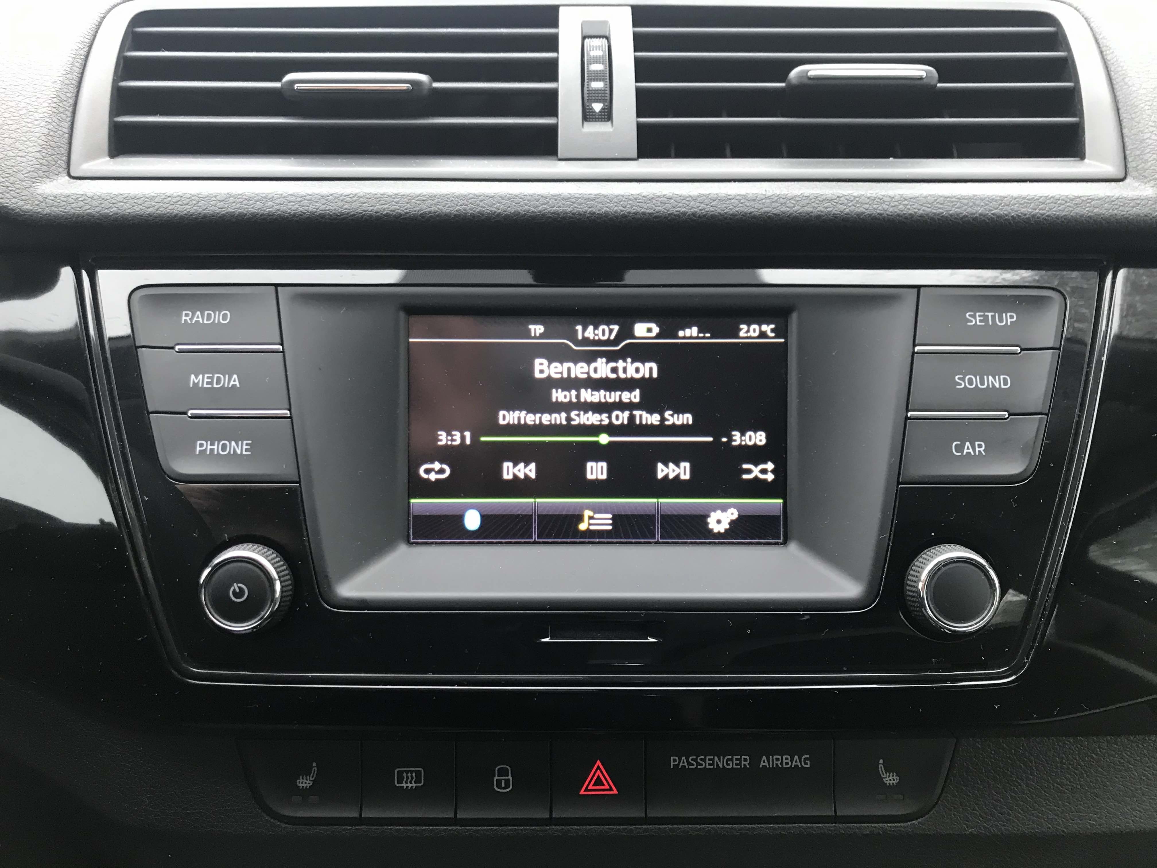

currently mounts this
I would need to know if there are any additional cables to take and some advice on coding
the picture i got it from internet but the radio is that model
Are you sure this is a superb you have, dash isnt correct for a mk3

this picture is taken from the internet but is the model mounted on my car
what cables do i need?

Part of your problem is that the Swing is an 'all in one' unit, whereas, the Bolero, Amundsen and Columbus are all split in to the 'display' and 'brain', the latter is located above the glovebox.
You'll need to extend the wiring from behind the screen to the glovebox and add a few extra wires to power/drive the display. You'll probably also need a new trim piece in around the glovebox too. Here's an example of the kind of wiring you'll need, other (cheaper?) sellers are available and this may not fit your car: https://eurozonetuning.com/products/quadralock-wiring-harness-for-discover-pro-retrofit
To get it working properly, you'll need CP matching (a dealer can do this) and also the FeC/SWaP codes adding (a dealer cannot do this) so you'll need to look for hacked units where CP has been removed and all features have been activated. Might be worth asking @pab567 to see what he's got in stock :)
