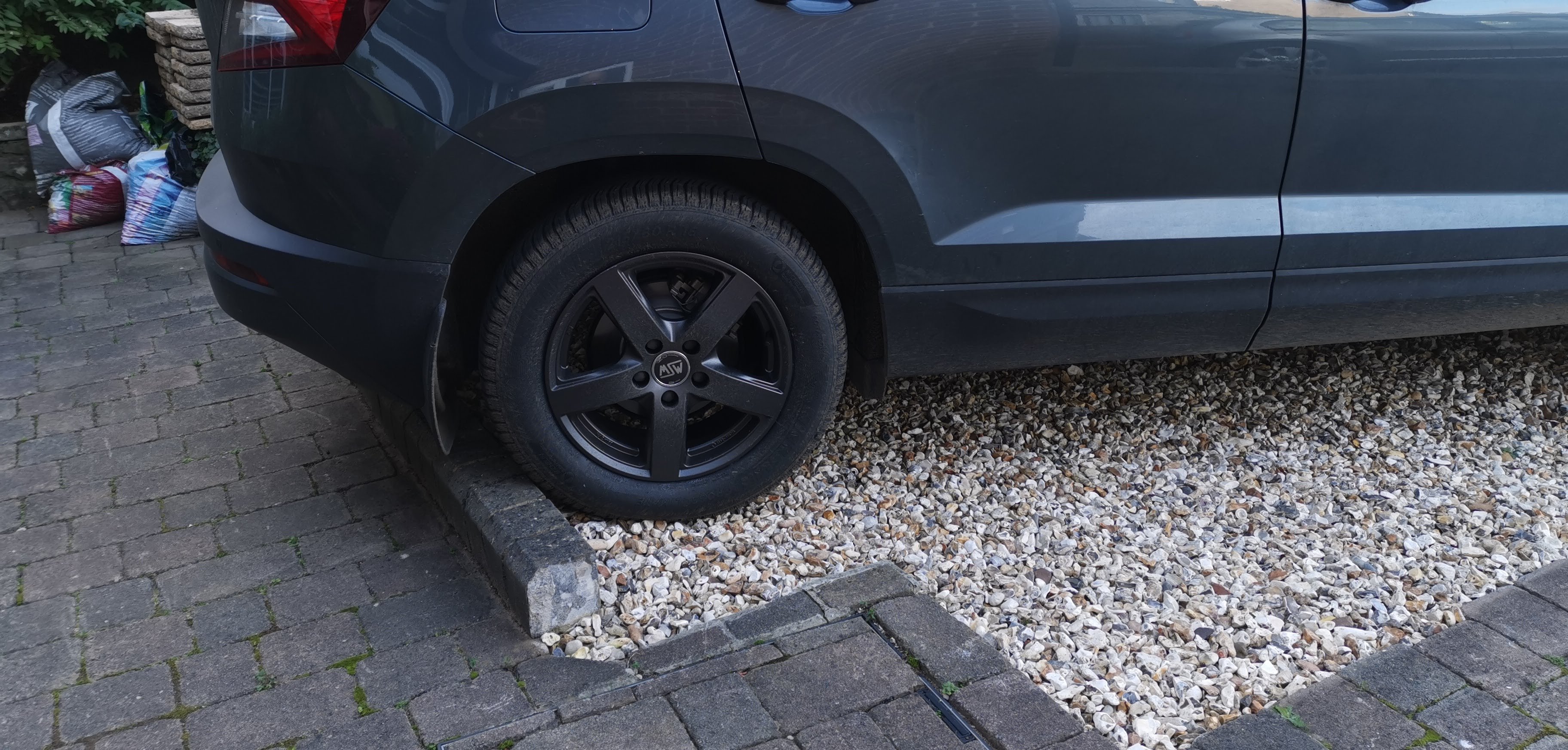

Just got rid of my 18” rims and horrible tyres that came with the car when I got it at the end of September.
Now running 16” rims with 205/60/16 (the rolling circumference is almost exactly the same) Michelin Cross climate II’s.
The difference is huge!
Much quieter and smoother ride, plus the car feels more ‘planted’ on the road.
Will be selling the 18’s to recoup some of the outlay....

This is my plan. What alloys are you using, Skoda or another make?  Are you using Cross Climate "+" or "2"?  Did you get a good deal?
Hi I went for these
I prefer grey wheels to the silver variety.
I bought CC 2's (the reviews seem positive) and they do seem to drive very well.
