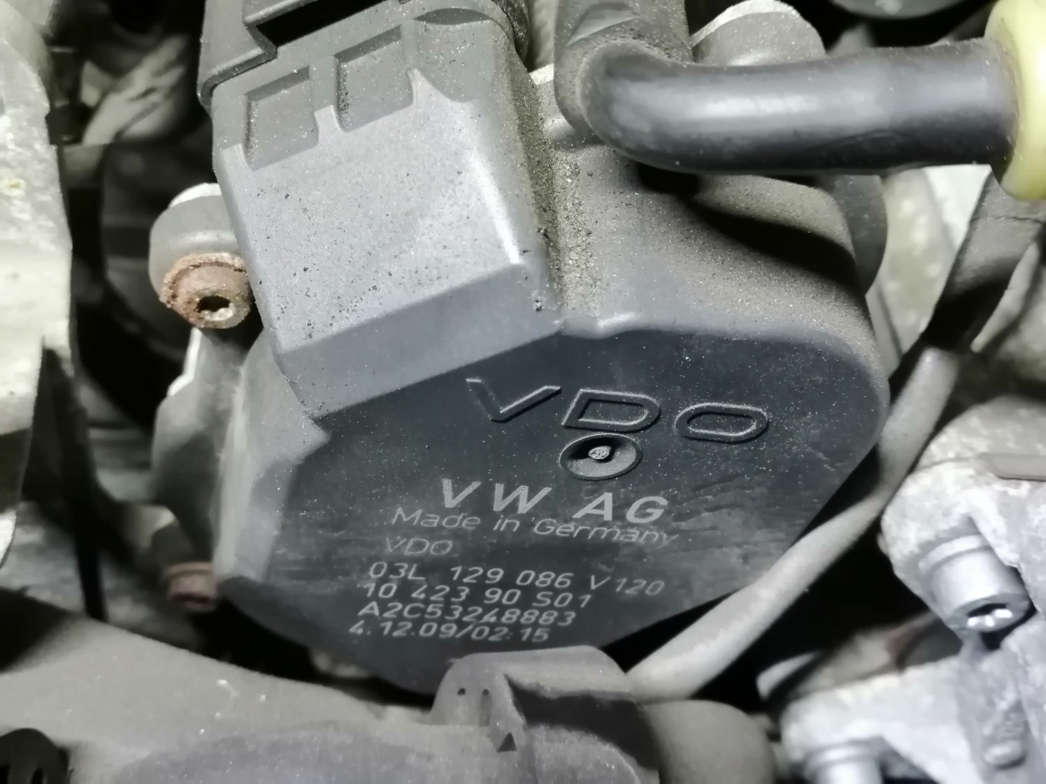

I have been looking into possible fixes for the P2015 error.

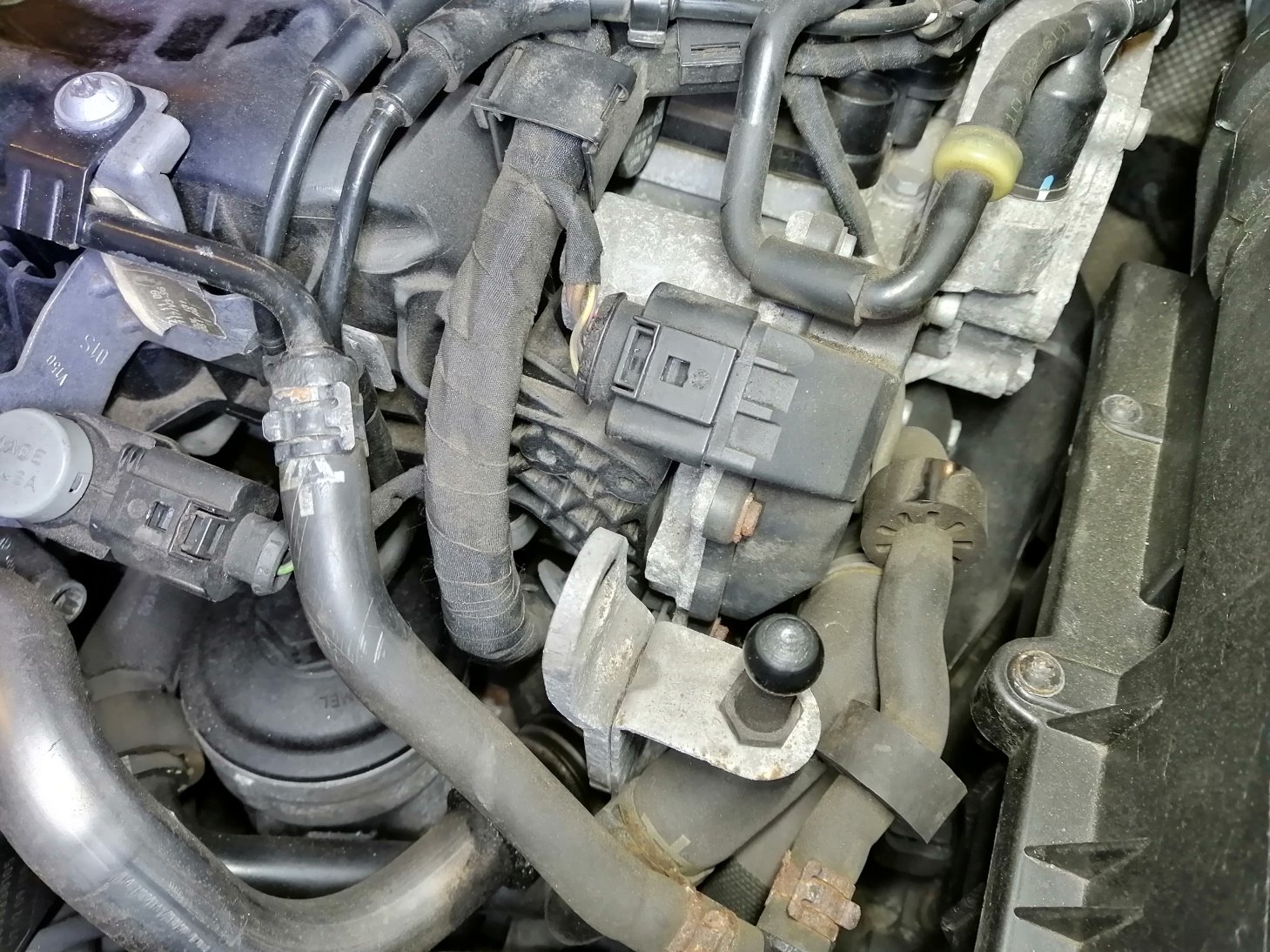

It seems you can get a small metal bracket that screws on and prevents the motor from over-reaching when it returns from opening the manifold flaps. I have ordered one of the brackets for the 2.0 CR engine. This looked like a quick and inexpensive fix to try first.
I took the engine cover off this evening to have a look at the motor for removing it. Every picture and video I have seen shows the 3 screws put in from the front of the vehicle. On our VRS they are in from the rear giving no access to remove them.
How do I remove that motor?

Just found this. Looks like it is doable but a PITA. Oh joy.

if you're taking mani off there's alot of fuel lines, clips and brackets to remove/move to get to the mani bolts, the mani, motor, egr and throttle come off together just remove hose from bottom of throttle and pipe on egr,
first time took me around 3.5 hours second time less than 2,

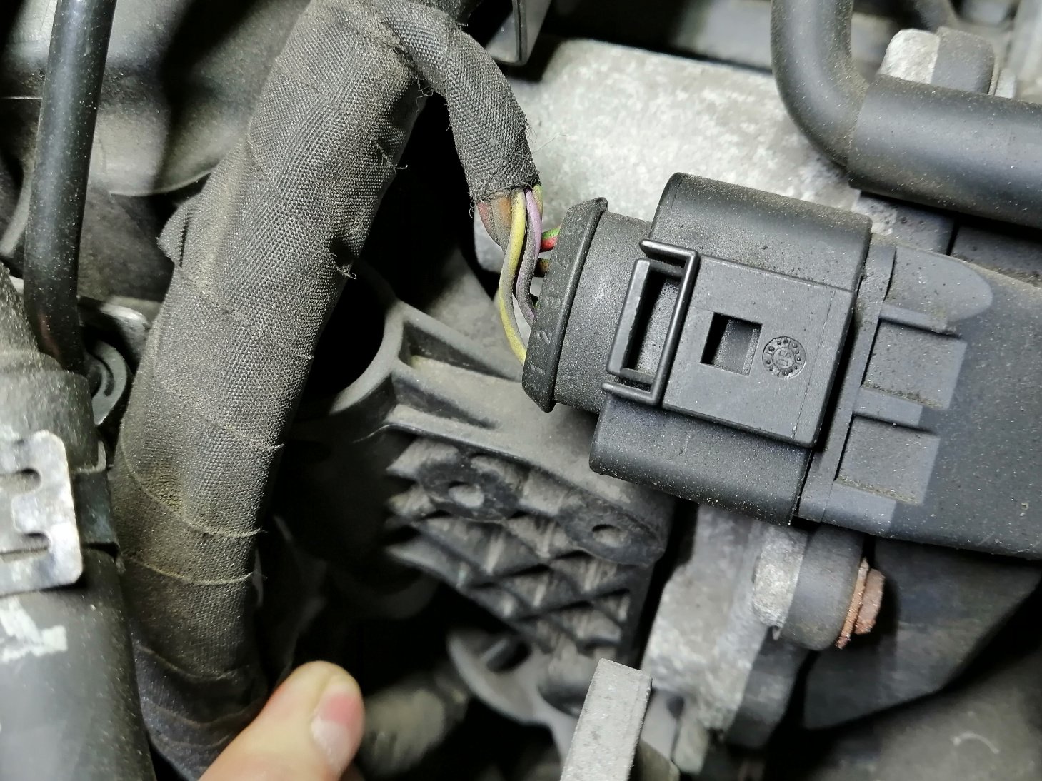

I decided to check the plug on the motor (unplugged it and plugged it back in. Looked clean, no corrosion etc) and give the car a run to charge the battery. Cruised it up the motorway and as I came off the motorway to turn round to come back it was doing a regen. Cruised it home and completed the regen (back to normal tickover).
I then cleared all codes with VCDS and this time it cleared the P2015 error. It wouldn't clear before. Hopefully it won't come back.
