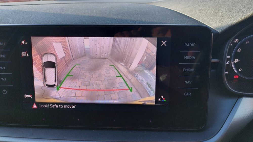

Has anyone else had a reversing camera fitted by a dealer? Just had one fitted to my Kamiq and they have made a really good job of it. I would like to compare screens to see if I have the right software for mine.

Thank you for the replies. The reversing camera is a genuine Skoda kit. As you can see I have the green and red lines but not the yellow. I wonder if Olderman1, you have park assist in your Kamiq? You have more options to the right of the screen. Perhaps that is why you have the yellow predictor lines.
That matches my factory fit camera, I don't have park assist.
There are kamiq pictures arround but with the highline  which should explain the curving lines as it was retrofitted. Original Scala and Kamiq do not have that and in stead only have fixed green and red lines. Park assist should not have any effect unless those are last minute 2022 model changes to a highline model which i doubt honestly. So if you wanted too, the dealer could have installed the highline version as it is compatible. But they probably wont as it is not original for a scala or kamiq which Skoda did a louzy job in leaving it out for those cars honestly..

As per above there are / were two versions you can/could buy - the basic lowline version and the highline system which had several features ( as depicted by the menu options on the above picture ). There was a significant difference between the two systems - the highline may have been more than double the price if my memory serves me right. It all depends on the headunit whether or not it can accept the highline version.
scala and kamiq can have the highline installed. Only hardware and wiring needed, but i do not think dealer will do it as it is not standard.
I cannot remember seeing different versions of the reversing camera, highline or lowline, when I was looking at the Kamiq on the Skoda UK site. My dealer fitted the one shown as a factory fitted option on the Kamiq SEL where the boot release is changed for one with the camera to the right. It works very well and is clear and bright in all light conditions. It would appear that the one I have now is the same as the factory fitted one, including the software.
