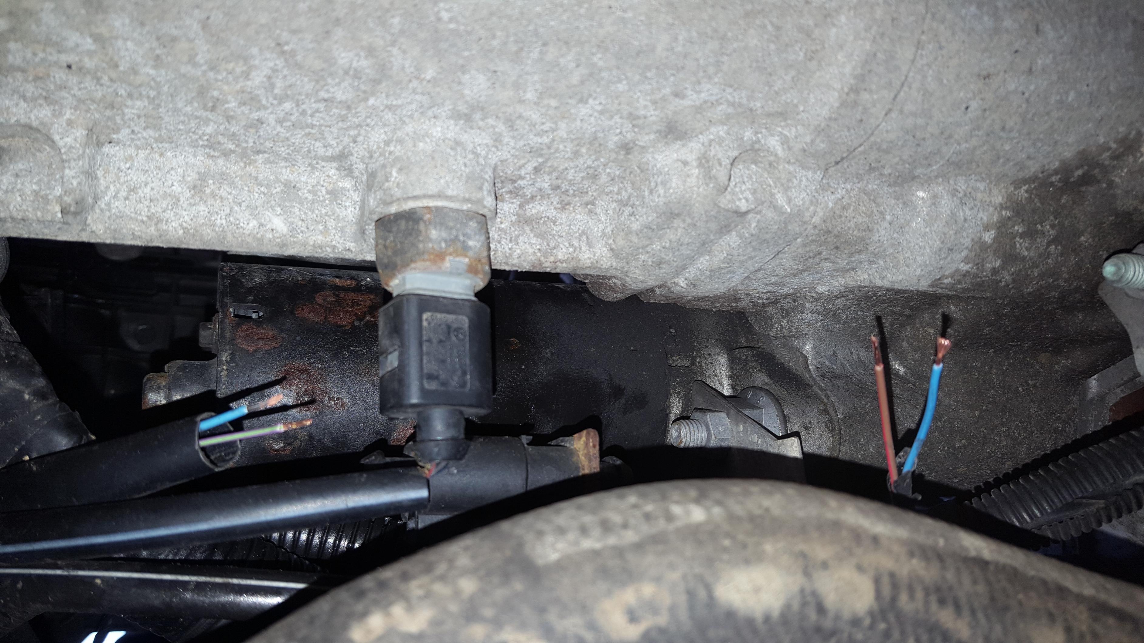

Have you checked this?

Hello
There no battery light showing before starting and when running.
I will have to have a look at the connector for the wiring.
Thanks

That makes me think of the alternator control wires as @Wino cites.

So the main problem near the connector near the gearbox. There any other places it breaks or mainly there?
Just there usually.

Just there usually, and even then you may be "lucky" and one of them's just pulled off the terminal.

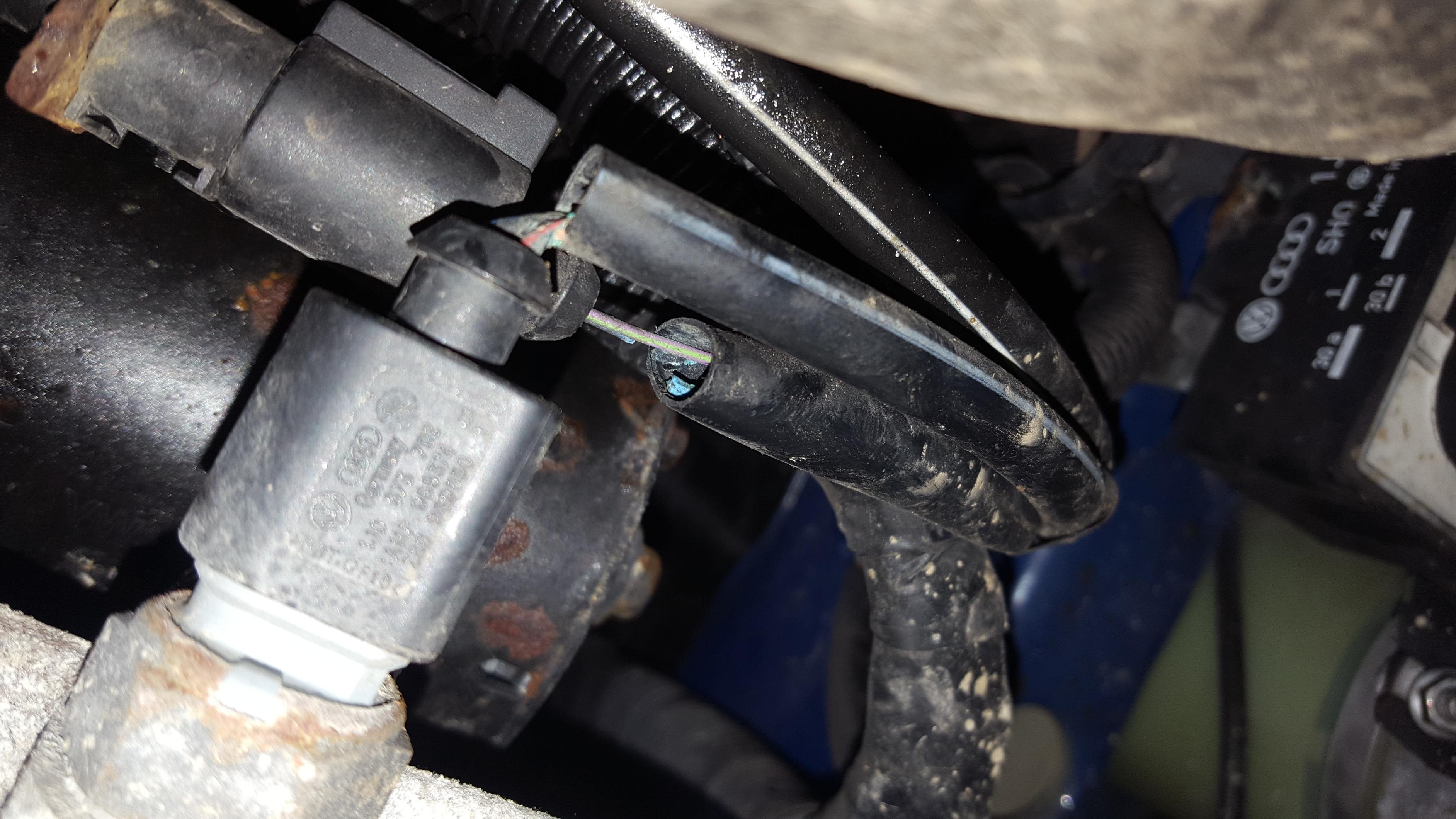

There are no push-on wires/terminals on a Fabia Ken. Proper latching two-pin connectors at rear of alt and at the plug/skt pair on gearbox bracket.
Whilst you have the belly plate off and are repairing the alternator wiring under the starter motor,you may as well do the same job on the aircon cables in the same place, if the alternator connections have corroded the aircon ones will be in the same condition.

I found the blue broken wire on the connector hidden inside the cover. I removed both sides to make clean cuts on 2 cables.
I've joined these now with 2 block connectors and new wiring then insulation tap.
The car now starts up far better power and I can see the battery charging correctly without having to rev for a second when first started. The lights stay bright now as well makes a big difference.
