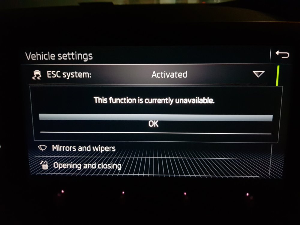

Hi all, just picked up my wife's new sel Scala which is great, but it's frustrating it only unlocks the drivers door with the unlock button. On my Octavia we had an option to always unlock all doors in the "Opening and Closing" menu but this keeps saying it's not available on the scala. Does anyone know if this sounds like a fault or is there is a common reason for this to be denied?
Not sure on the reason why the function is unavailable in the settings.
Double pressing unlock on fob will open all doors, or holding handle for a short pause will unlock all doors too.
In case anyone else gets this in future, after taking this to the dealer, they have said this is a common issue when a software update hasn't worked correctly, now they've performed a new software update the menu is now accessible.
Just come across this thread as I have the same issue. I have also updated the software 3 times (newer versions) with no errors, yet I am still getting the same error message 😞

did you ever resolve this? As I have the same issue strangely, doors do not lock automatically when driving off, and the menu option says "currently unavailable"
