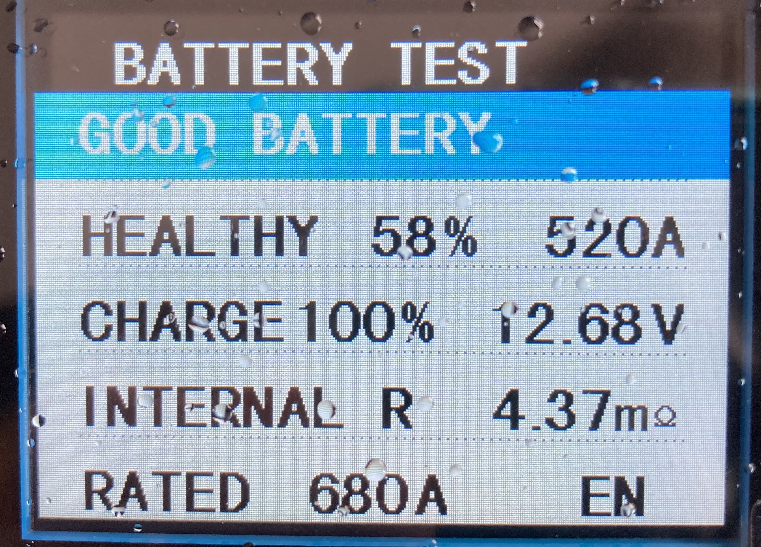

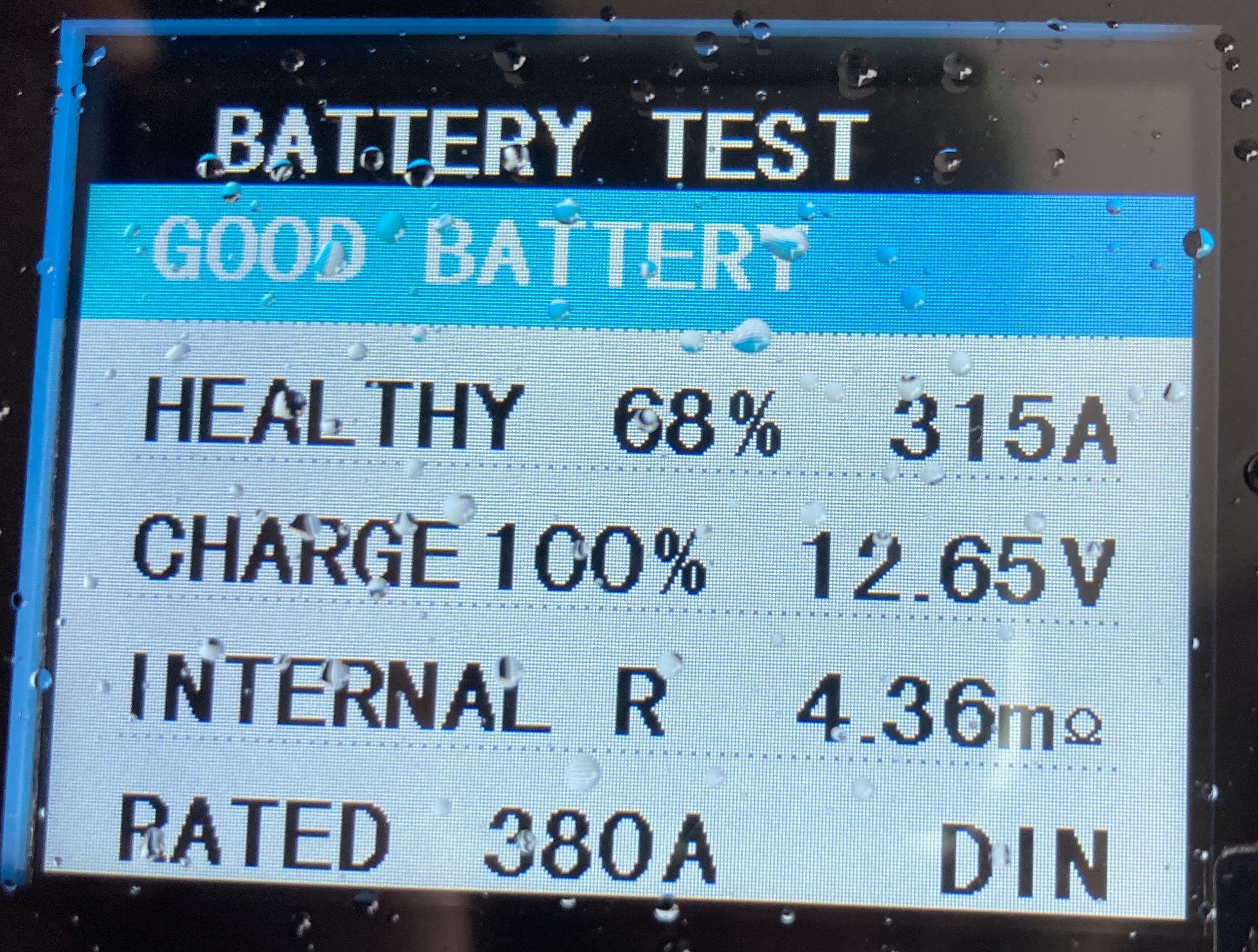

In terms of the old battery, this was rated at 68A 380 DIN / 680 EN/SAE and the battery tester reported the state as good, but clearly not good enough for a diesel on a cold day that hasn't been started for a few days.
Testers give an indication of condition as they cannot be calibrated. The EN spec test is a week long affair of conditioning, discharge and recharge at controlled temps on several test samples. Midtronics deliver the best results but still need some interpretation with them. Using a hand-held whilst the battery is still connected to the vehicle throws further variables into the mix that confuses things further.
The important take-aways here are the voltage relative to CCA indicated and rated values for the ambient temp.
Disconnected battery - Ideally the closer a voltage is to 12.72v, the higher the indicated CCA should be in relation to the rated value. Fully charged and voltage stable at room temp, the indicated CCA should be approx 15 to 20% higher than the label rating on a cycled fresh condition battery.
If it is close to or lower than the rated value, the battery is compromised and heading towards needing replacement. Recharging in this condition just delays the inevitable. The bigger the gap, the worse it is.

FWIW the battery was off the car as it’s been replaced with the new one. 👍
Once off I fully charged it on the ctek to float, left it overnight 18 hours and put the tester on it this morning.
Obviously I ignored the good/otherwise rating and percentage and it’s not accurate but it’s a reasonable indication that it has lost around a quarter of the cold grunt it had new. Probably more as it wasn’t that cold this morning although it had been left outside all night.
I repeated the test about 3 times under the EN and DIN settings so at least the meter was consistent. I’d also got the 12.7 from a multimeter previously.
So it whilst it isn’t totally dead, it’s no longer fit for turning over a cold diesel. Probably fine for a 1L petrol or a solar light system😂
At nearly 7 years old, plus CoVID lockdowns (even with charging) I was waiting for it to decide it was time to start going south 👍
