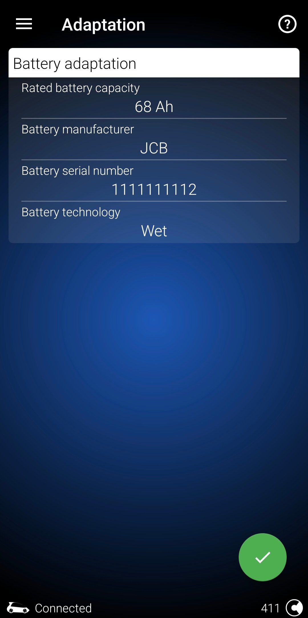

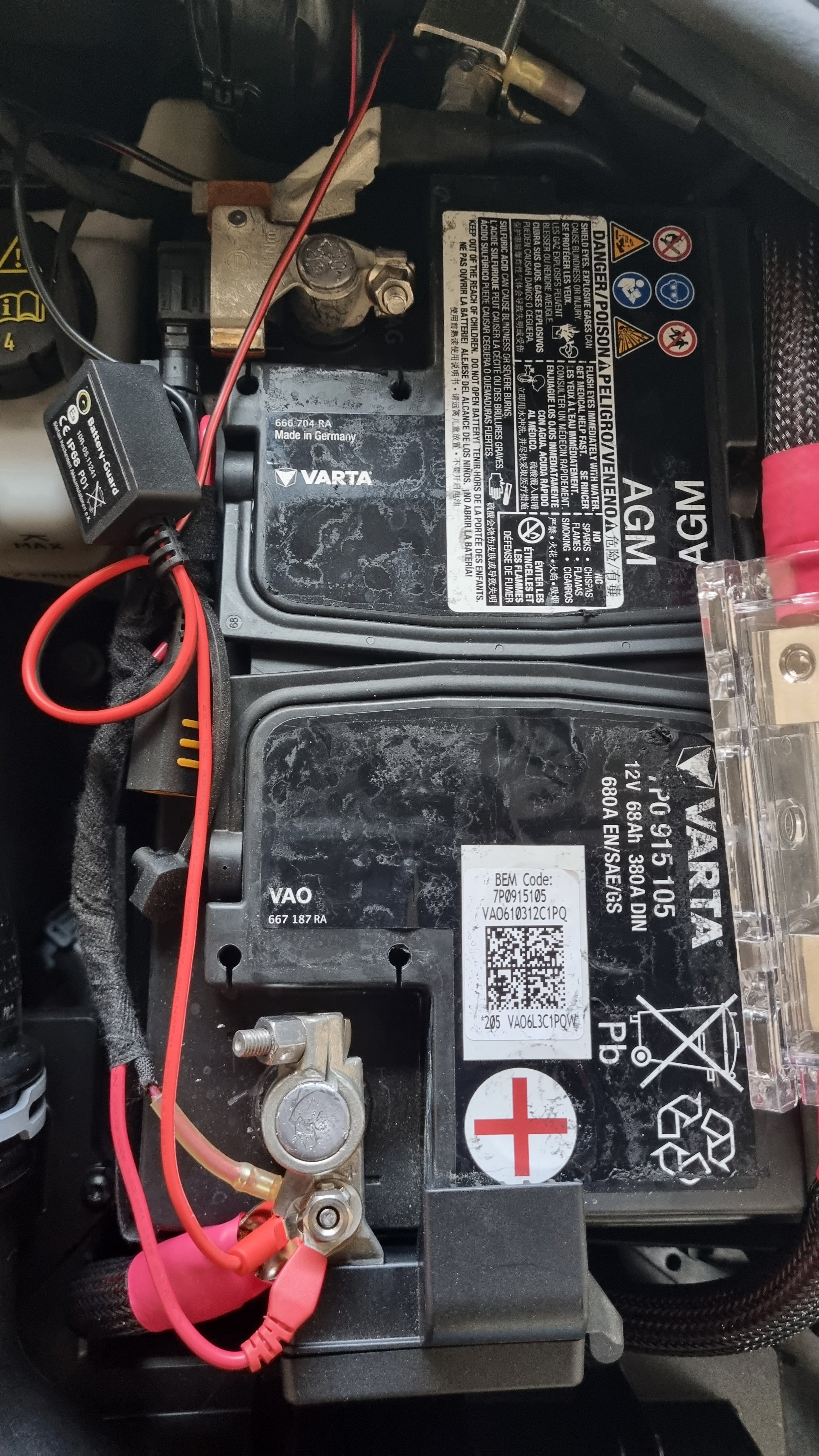

Attached 2 pics.
1st the factory battery. Clearly states AGM.
And 2nd is screenshot obdeleven.
Parameter on Wet. While it should be on fleece right?
Dealer states he does not see these settings with their tools. They do it with official battery program tool and only sees some digits during the learning process of a battery.

1 hour ago, DutchVRS said:
Just an update here as I still have loww voltage. After all systems are shut down battery voltage is 12.2V at nights at 10 degrees. It went down to 11 at freezing a bit.
Anyone with a VRS who wants to measure his voltage?
Attached 2 pics.
Also they state they can not use obdeleven or vagcom or vcds info to send to skoda factory for claiming.
Hi Dutch, yes, that adaptation should read fleece. AGM charging voltage is higher than 'WET' battery type.
But thats the strange thing..when measuring voltage while driving its always between 14.2 and 14.6V.
An AGM should not be charged much higher either right..?
Wondering if the 'fleece' option also changes the current of alternator..

Would you do the change to fleece yourself with OBD?
Your dealer's battery diagnostic's should be, at least as good as a Hex-V2 VCDS.
Your battery seems to be recoded as the original serial number on all the batteries ends in 1, you just change any number on battery renewal.
When I looked at battery adaptation for a AGM, it gave two choices, AGM Binary or Fleece.

Yes, I agree with all the above, though I thought that at least Skoda and maybe SEAT actually did code their batteries correctly in the factory - I do know from checking a few VWs that they don't seem to bother so everything goes out with "JCB" and "1111111111"   - so as suggested above, that car's battery system does look a lot like it has already been recoded from "1111111111" to "1111111112" and maybe even the "fleece" changed to "EFB", so yes, I'd try changing that battery serial number back to "factory setting", ie "1111111111" and change the technology from "EFB"  to "fleece" - just changing it to "fleece" might force the battery to be seen as a new one, but just to be sure, change the serial number to anything other than what it is presently - so why not change back to "1111111111" the actual value of the serial number or its changed value means nothing to the battery system, it is changing it that forces the battery system to restart the battery learning system.
If you are worried about your Skoda dealer discovering that you have made battery setting changes, just do as I suggest, then a day later change the serial number back to "1111111112" as that will have it back to what the garage changed it to and still prompted the battery system to "restart" it's new battery learning.
Short update, today the car went in at skoda service. They admitted that last time battery learning was not give the correct settings. Now they did it again, and say its on fleece setting.

What Battery Serial Number and Battery Technology is the  obdeleven indicating since recoding?.
Hi, see attached after the recoding by Skoda.
