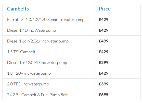

£429 at my local VAG independent!
https://lvsag.co.uk/services/service-repair/
