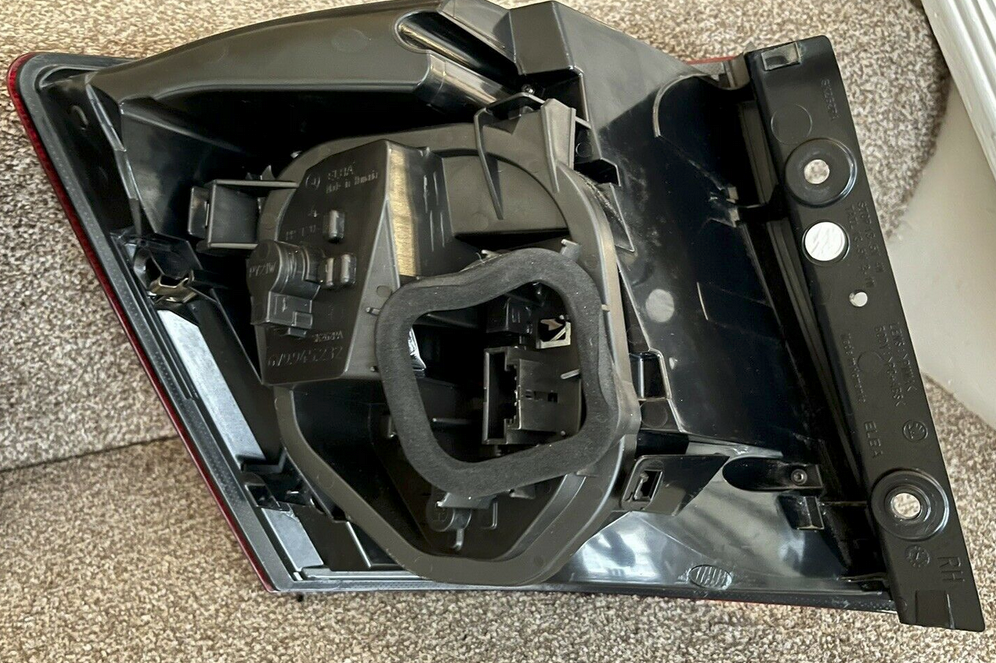

Is it this unit?

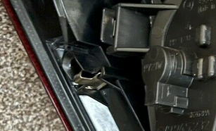

and if so, have you lost the little clip here?
The bad news is, if it's been coming loose, and has now gone to the floor, it's probably not worth refitting it in the light unit.  You might be able to relocate it. Can't see that clip being listed as a spare.
I know the bit you mean, it is part of the light cluster assembly and I very much doubt you can get that bit unless you can find a broken light cluster at a scrapyard and take it from that - or find a similar bit of spring metal.
Or pad out the locating peg on the car - item 16 securing pin in the parts link - personally and this is not a joke I would try bluetac or whitetac, once left it has extremely strong holding power and I mean extremely strong but you can stretch it off - like those reusable wall hooks (can't think of the name) they must similar stuff.  I have had bluetac hold an external badge on my car for about ten years, hold up a broken metal captive cage fitting and gear lever knob shift numbers badge for about 5 years.

Inspector man, yes that would be the clip. And after looking at the picture I went and removed the cluster (had been trying to avoid that as I am not mechanically inclined). And besides the clip the entire plastic bracet holding it is damn near gone. So I guess the mechanic was not lying hehe
nta16, that is a good idea. Gonna take it to a friend who is a bit better with these things and see if he can rustle up some magic. And yes very silly design.
