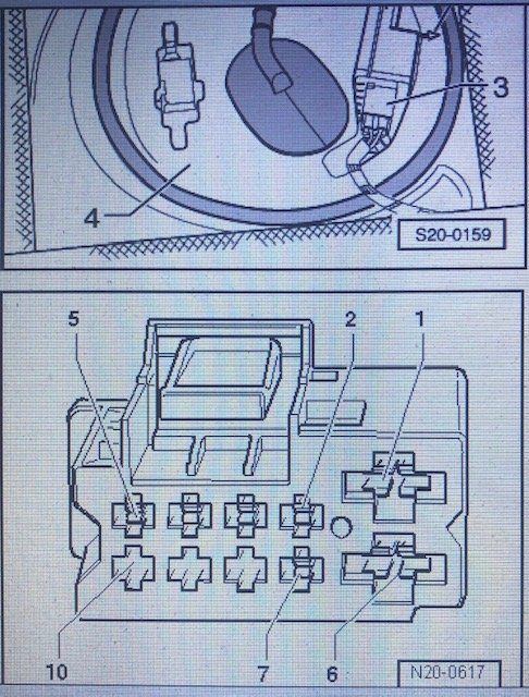

So which fuse is this (27?) and where is the relay?  Where I'm looking, cabin fuse 27 feeds the 'fuel pump control unit' which I think would be near the fuel pump, as opposed to a relay,  with lots of connections (10 pin connector)??
Yeah the fuse is 27 in the cabin and my owners manual says it's the fuel pump relay. The relay I thought/think it is/was is under the bonnet. Unless of course, that's not the actual relay...
Thanks for replying
The control unit (J538) is near to the pump unit under the back seat base accessed via the round access panel, if you have VCDS  you can test the unit or if you have a multi meter you can do a basic voltage test across the two larger contacts ( pins 1 & 6) on the connector  that is the supply from fuse 27 it is a live supply and on pin 3 is an ignition ON supply from fuse 1 (10amp)
Edited by nige8021
Picture added
Thanks for the info Nige.
I located the control unit. It had a very strong smell of a sort of burning and there is a lot of sticky gunge around it.
