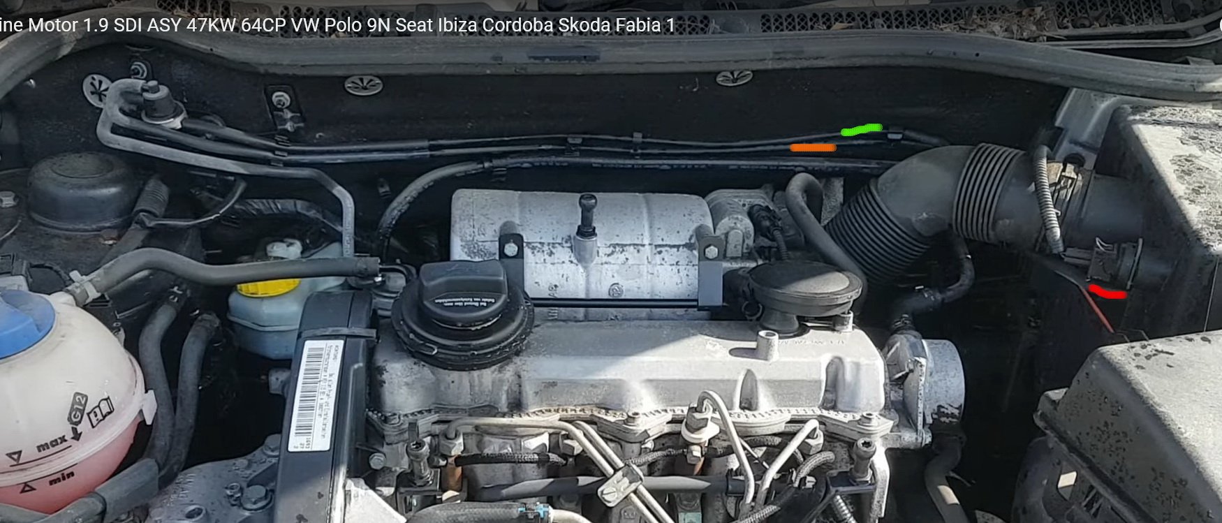

Hi, i downloaded this pic from the net, i need to know if my car is in order with those vacuum hoses.
Please check the picture, can you please tell me, if the red marked hose at the airbox (where the air filter is ) is continuum with the green or orange hose?

That small black cylinder is a solenoid valve, it has vacuum in from the pump, controlled vacuum out and a vent to the airbox so it can add small amounts of clean air to vary its vacuum output.
Ok, thank you.
but which of those three port is the one who goes to the airbox?
it has two at the left and a single one at the right.

It's connected correctly, I thought you'd have realised that from my reply.
Uhm.. i am sorry i am lost.
The picture i uploaded is from another car and i need to know how are they connected so i can put it in right order
