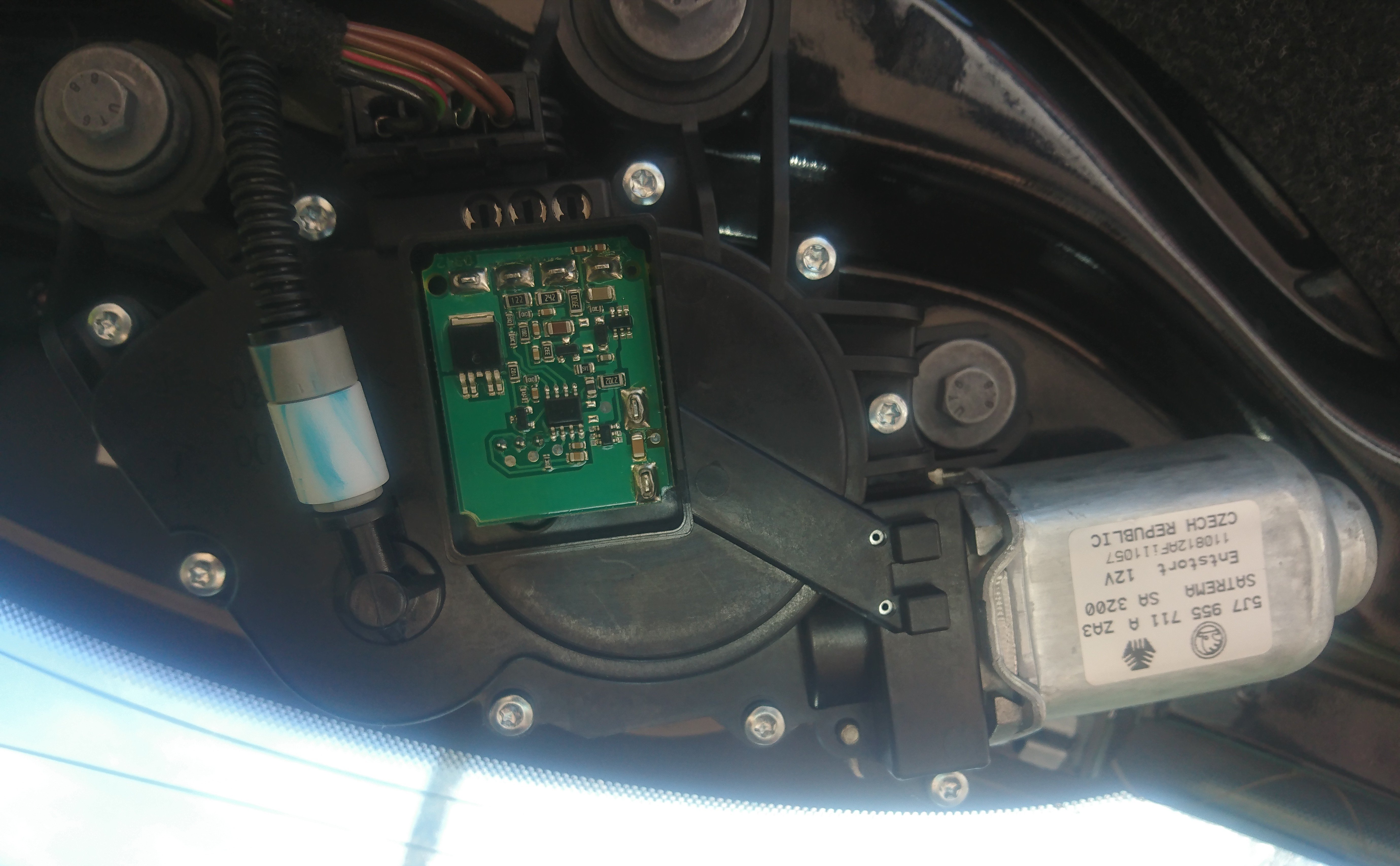

i've got exactly the same problem as you described on a 2009 Mk2.
power seems to be at the 4 pin connector alright.
i've got to double check the green wires based on some threads i read, but brown and black are definitely good.
funny it will work on a cold morning, but not in the afternoon. Presumably after the mrs has been driving.

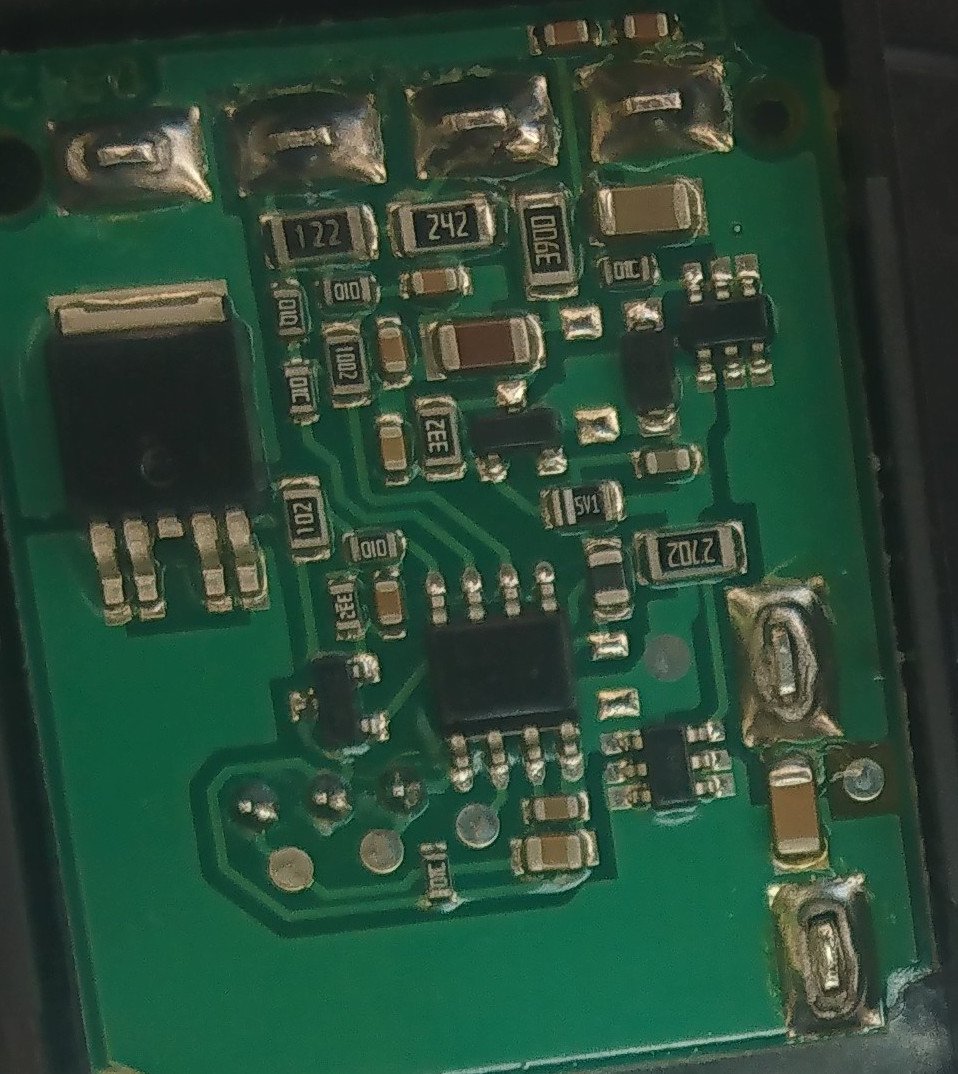

Thanks for the info  - that's helped me fix my rear wiper problem, which had exactly the same fault with the circuit board.
