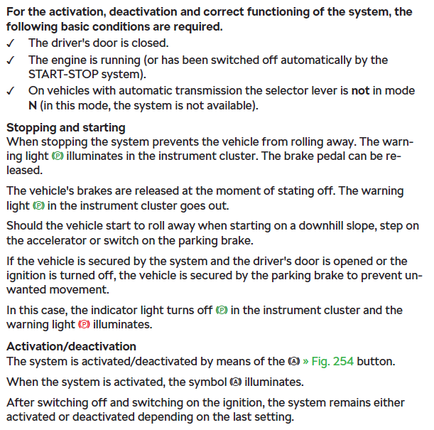

Autohold is not applied whenever the car stops.
You need to push the brake pedal hard enough to have it function.  You can stop with light braking and it is not holding the car .
ie car stopped, foot comes off the brake pedal and brakes are not applied.
You can go to N and Autohold is not holding the brakes.
The e-Brake / parking brake is applied when you exit the car etc.

I’ve never seen or heard of the auto brake function you talk of.
There is an autohold function and a button to turn it on or off beside the EHB.
The autohold works by keeping the hydraulic pressure on all 4 wheels, same as if you were to keep your foot on the brake pedal, it does not apply the EHB.
You are correct in that the EHB will apply when you turn off ignition and also when you open drivers door.
Hill hold assist / hill hold control is a different thing from Autohold and then the  e-brake / parking brake.  @Routemaster1461 it helps if you say if your car has a DSG or manual box.     Any confusion comes from lost on Translation which is a VW group think.  German to Czech to Spanish to English or US English.  Then them using different names over the past 12 years for things like hill hold assist / hill hold control. Then people not reading the manual for their particular vehicle.  Still lost in translation sadly.

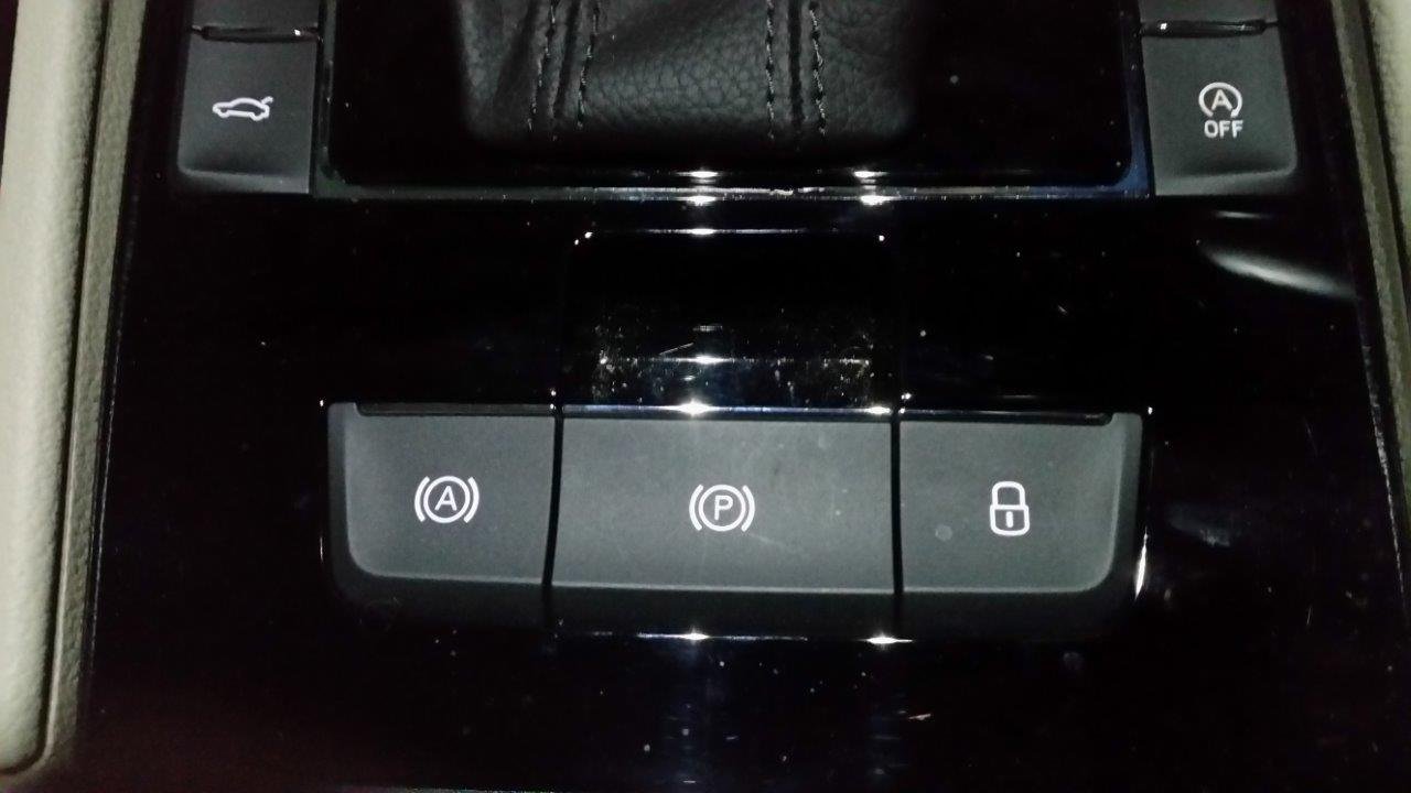

It is manual. To answer any potential questions, the Autobrake button os next to the parking brake button. When you come to a halt, as long as the car is in neutral and the clutch is up, the brake comes on and the parking brake icon comes on on the dash. Youi can hear it disengage when you move off. Autohold just holds the car on a hill by not releasing the pressure in the brake lines, assuming the system recognises the car is on a slope and the abs rings are not rotating. For clarity again my car has both Autobrake and Autohold. Oh, also it does state my car is a manual in the signature at the bottom.

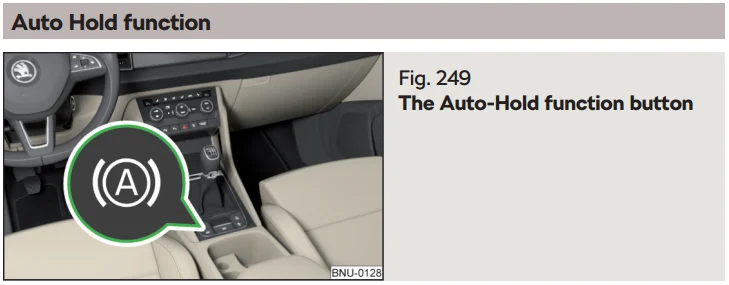

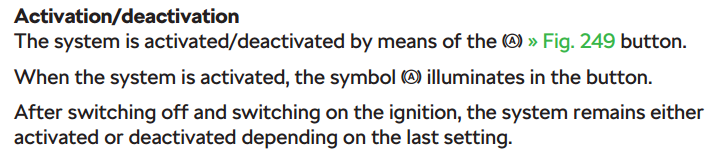

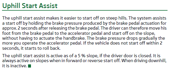

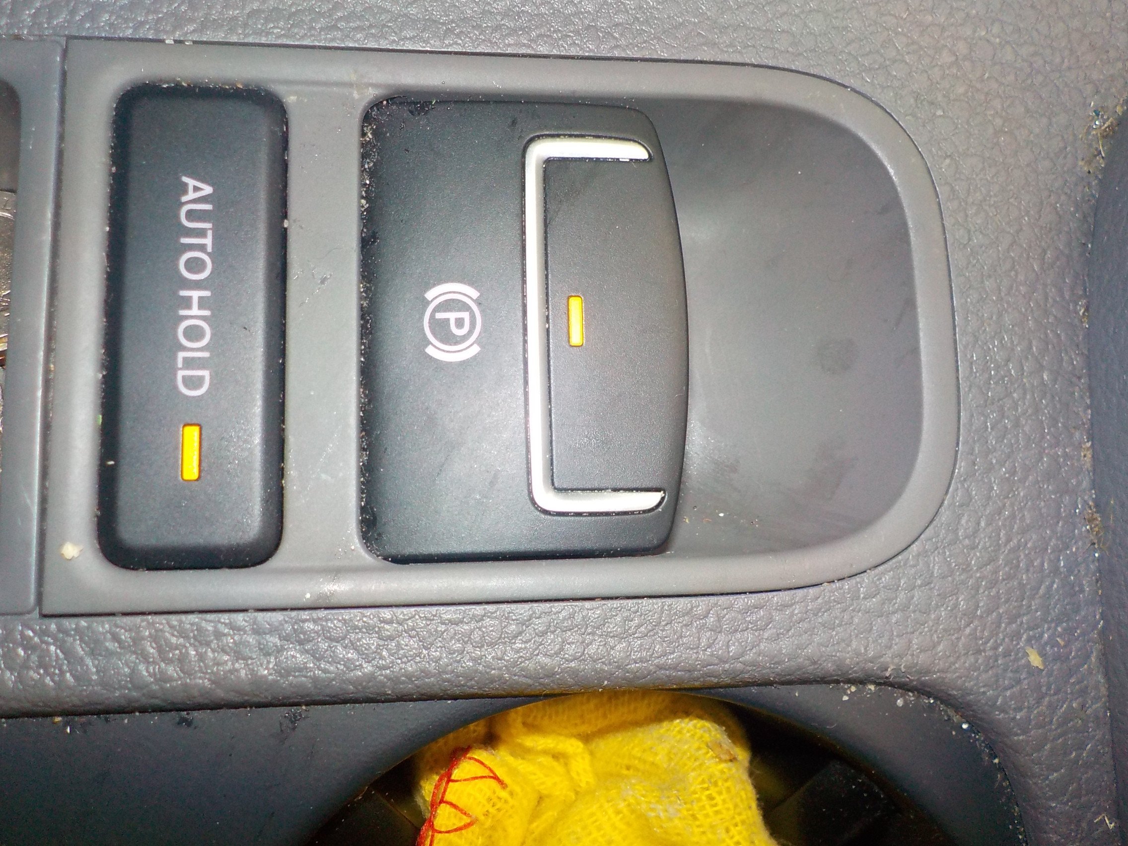

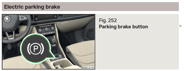

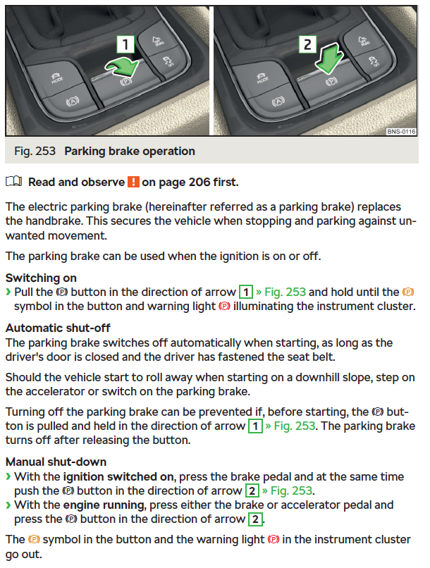

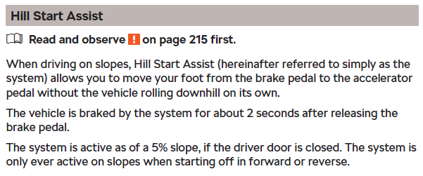

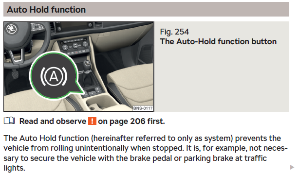

Skoda don't have a great track record of the terms and titles they've used for their vehicle features over the years.
My 2008 Octavia Scout had a feature that at the time was called 'Uphill Start Assist', if pulling up to a stop on a slight gradient when releasing the foot brake the front brakes would hold themselves for a couple of seconds to make a hill start with a manual gearbox easier. There were no buttons to turn it on or off, or any lights on the dash to tell the driver is was active or not...
Skoda often used terms such as 'Hill Hold' or 'Hill Hold Control' i.e. different terminology as to what was sometimes referenced in their owners manuals.
'Hill Hold Control' is available on the Karoq (link below) and Kodiaq, however it is referenced as Hill Start Assist in some owners manuals...
https://www.skoda-storyboard.com/en/karoq_car_snow_hill-jpg/
'Hill Start Assist' is a separate feature to 'Auto Hold'...
...which is again separate to the 'Electric Parking Brake'...
So essentially three systems:
- Hill Hold Assist
- Auto Hold
- Electric Parking Brake
The first two utilise the ABS pump (or similar) to hold the foot / front brakes, the third an electronic motor to engage the rear brakes.
Edited by silver1011
