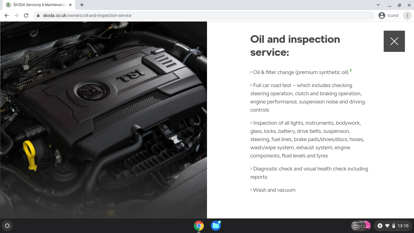

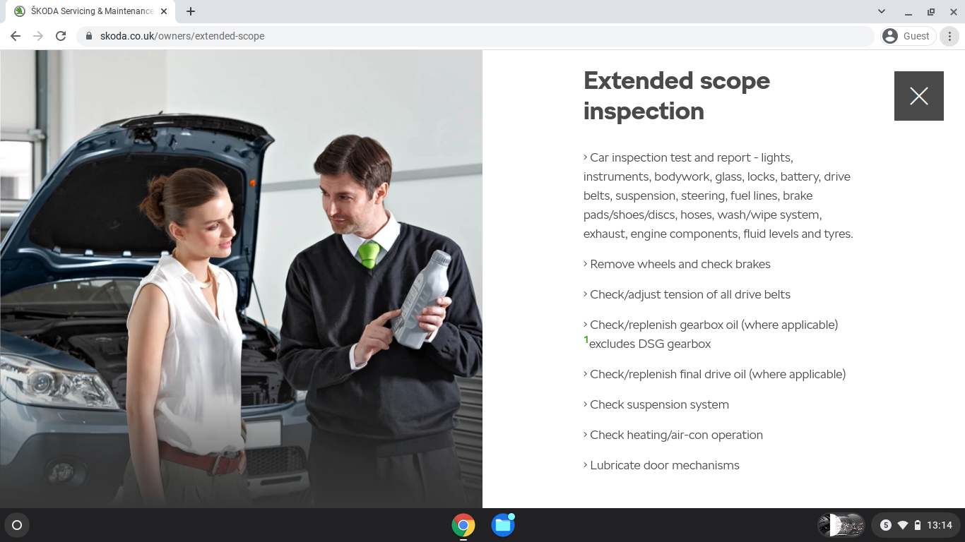

Is the Service Indicator reset and the Service on the Skoda System?
The Labour is very reasonable.
Only an Oil & oil Filter service though.    Not a Oil & Inspection Service.
If the car is 2 years old 'MOT Due 22/10/ 2022,
 then the Pollen Filter needs looked at if not done , area cleaned, vacuum filter or replace.
Blue Chart is 3-10 Fixed Regime Servicing.
