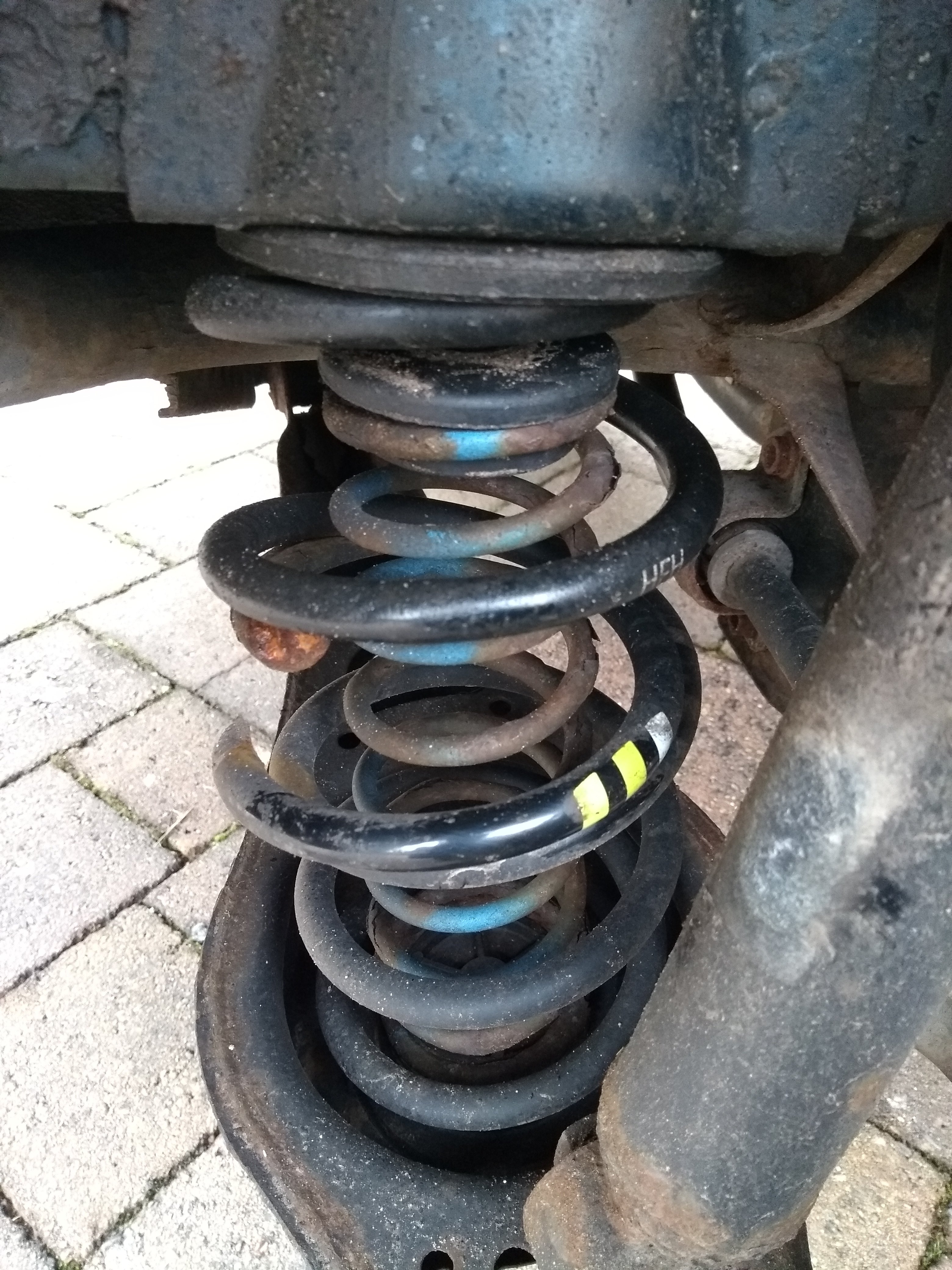

14 hours ago, Liger1956 said:
At one MOT recently the car failed due to a broken rear spring. I had not noticed as the MAD helper spring must have been taking the load and the car had not been loaded fully recently prior to the MOT.
Most coil springs break at the ends, often the last half a coil turn...hence why you didn't notice. The main difference would have been a small reduction in ride height but not much.

35 minutes ago, Liger1956 said:
Most may but without knowing the facts in my case your statement as to the reason that I did not notice is false. The MAD spring was taking the load as mine fractured in the middle.
If the colour coding on that rear spring is 1 white dot and 2 yellow dots, then that's a 1K0511115BE rear spring which does seem on the soft side for an Octavia MK2 2.0TDI estate FWD with standard ride height.
A change to 1K0511115BG would have increased the weight range by two,
The soft rear springs problem was caused in 2006 when Skoda in their wisdom dropped the spring rates on the Octavia MK2 by two weight ranges. Hence by increasing the weight range of the rear springs by two, you would be going back to what Skoda had originally planned.

18 hours ago, jeallen01 said:
Having read the thread that I linked, then that's the conclusion that I also came to as the "..5BG" springs are definitely too hard for day-to-day use on the very poor roads we have in our part of London - OTOH, I may then have to get the MAD helper springs that someone linked in that thread as those might well provide the variable rate effect that I was seeking in my original post in this thread!
BTW: having them looked at various other springs that claim to be "equivalents" to the OEM VAG "..5BF" springs that are on offer, it was interesting and confusing that some of them actually appear to claim to be equivalent the "..5BF" but others to the "..5BG"!!!! VERY confusing, and so I'll have to be very careful as to which ones that  I buy!
Your 2007 Octavia MK2 2.0TDI estate FWD with standard ride height was probably manufactured on or after 6/3/2006 so may have originally been fitted with 1K0511115BD rear springs, ie. three weight ranges less than 1K0511115BG.
This could explain why you noticed the change to 1K0511115BG rear springs had made the car's ride harder.
Up until and including 5/3/2006 Skoda had been fitting rear springs that were two weight ranges softer. You can see this information on 7zap.
What works best for you could depend on what loads you carry plus personal preference. For example, someone who rarely carries rear seat passengers or much load in the back, maybe best with the softer springs that were fitted to the earlier cars, ie. perhaps 1K0511115BD or 1K0511115BE instead of 1K0511115BF or 1K0511115BG.
When I replaced the original springs in 2016 there was no signs of any breakages - main reason for the change was because I'd been carrying a lot of heavy stuff in the load area for quite some time and the springs had been somewhat permanently compressed by that!
2 hours ago, jeallen01 said:
...did Skoda ever make any further changes to the rear spring type prior to the major "model overhaul" in 2008 - and what then happened after 2008?
The 6/3/2006 is the only major change I've seen to the rear springs.
What springs are fitted is shown by the car's build codes, and sometimes also by the date of the car's manufacture.
