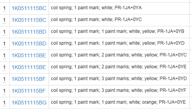

Now, knowing a bit more about the rear suspension setup, I have found that the KYB RH6788 springs appear to be equivalent to VAG 1K0511115BG springs, and I'm wondering if that spec spring is stiffer than that of the springs originally fitted to the vehicle - but unfortunately I don't know what the latter actually were as I disposed of them after the KYBs were fitted!
Therefore I wonder if anyone here does know, or can check, what the OEM rear springs are  for a 1Z5 estate chassis with the "standard" L13 suspension spec ("Suspension range 13 installation control only, no requirement forecast, 631-670 KG") & 2UA (standard) height spec, & with the "55mm" damper size - & specifically if it might have been one of the 1K0511115BC to BF range, some of which appear to be slightly thinner coil springs (thus "softer")  than the ...BG version?
FYI, to help identify the springs fitted, the paint colour codes for the 1K0511115BC to BG springs appear to be as follows:
Thanks in advance for any help or leads that you can give.

FWIW, I think I found the info that I need in this thread "Sagging Rear Suspension"
1K0511115BF is recommended in the optimal-germany.com online coil spring catalogue for the Octavia MK2 Estate 2.0TDI Front-Wheel-Drive without towbar. It's 1K051115BG if the estate has a towbar, which is about 5% stiffer than 1K0511115BF.
https://www.optimal-germany.com/media-center/downloads/kataloge
https://www.optimal-germany.com/docs/default-source/catalogues-documents/wbm-3011.pdf?sfvrsn=ac821103_10
Sachs 996653 is one brand that matches 1K0511115BF
Having read the thread that I linked, then that's the conclusion that I also came to as the "..5BG" springs are definitely too hard for day-to-day use on the very poor roads we have in our part of London - OTOH, I may then have to get the MAD helper springs that someone linked in that thread as those might well provide the variable rate effect that I was seeking in my original post in this thread!
BTW: having them looked at various other springs that claim to be "equivalents" to the OEM VAG "..5BF" springs that are on offer, it was interesting and confusing that some of them actually appear to claim to be equivalent the "..5BF" but others to the "..5BG"!!!! VERY confusing, and so I'll have to be very careful as to which ones that  I buy!
Edited by jeallen01

You do have to be careful with aftermarket springs if you want to match a particular OEM part number, which is why I check the listings on autodoc even if I then purchase elsewhere.
The aftermarket spring market is filled with springs that are sold to replace more than one OEM part number, ie. a one size fits all approach. If a seller is listing other OEM part numbers then it's unlikely that the spring will match your OEM part number.
On autodoc you have to click on the spring's listing to see all the OEM part numbers that the spring is sold to replace. The concept of "this spring will fit your car" is very different from "this spring will match the OEM part number that you want".
I'm not a fan of using spring helpers, ie. an additional spring fitted inside the main spring. This is a bodge, and an imprecise way of going about things. As someone has already noted, it increases the ride height. It also doesn't give you a variable rate spring as both the main spring and the helper spring are linear.
I would only consider a helper spring if a suitable replacement main spring wasn't available. However, this isn't the case with most Skoda cars. If you want a firmer spring, just go up one or two weight ranges.
1K0511115BF and 1K0511115BG have a very similar specification including 11.75mm wire diameter. The main difference is in the number of coil turns. 1K0511115BG gets its increased stiffness by reducing its number of coil turns, ie. 7.75 coil turns instead of 8 coil turns. You can just about make this out in the two photos below.
1K0511115BF (8 coil turns)
