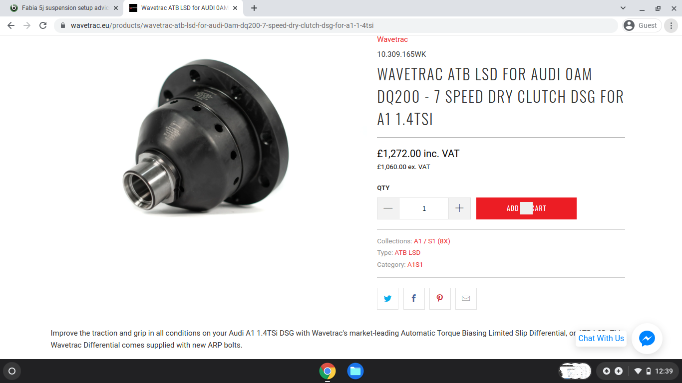

Its an impossible task mate and isn't it only the wavetrac that's available for our 7 speed platform? Run a wider tyre and lsd is your only really option unless you can try get the torque mapped a bit lower in the lower gears.

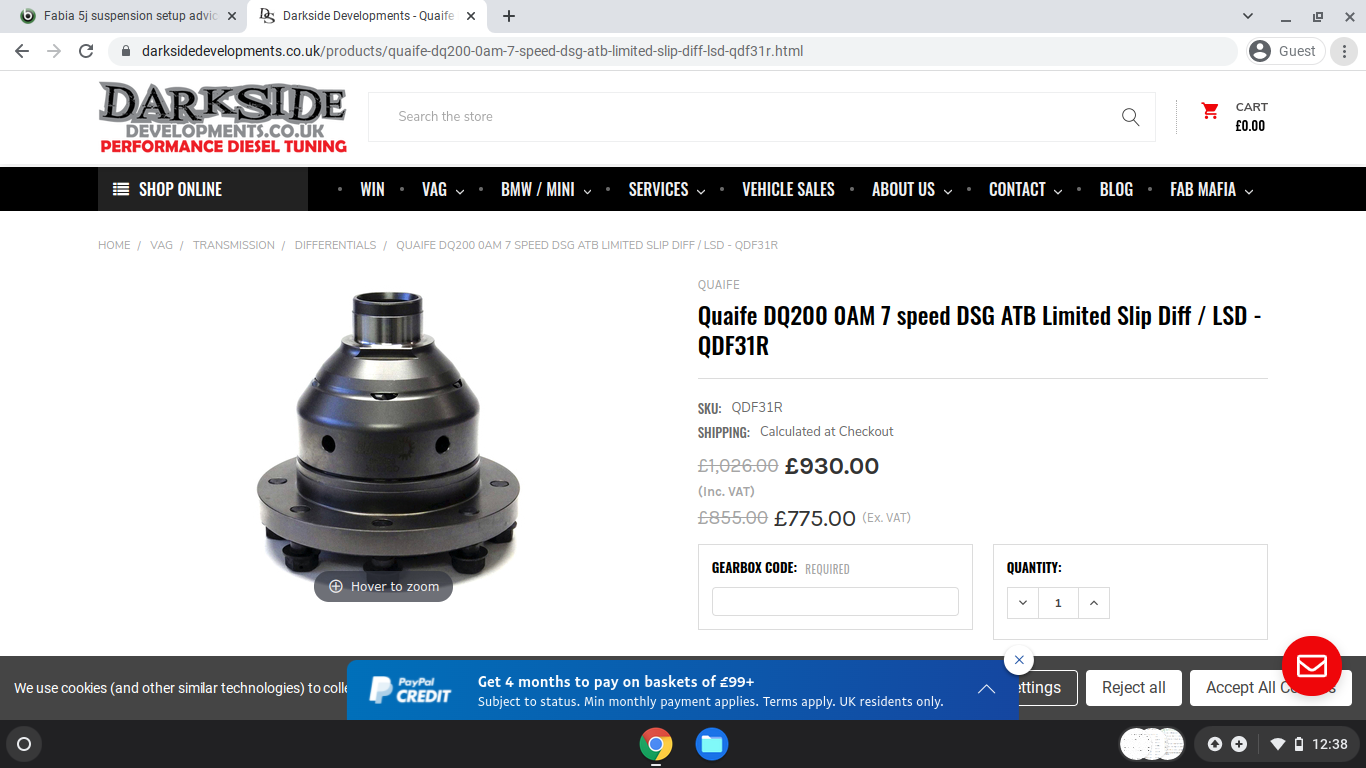

I think this unit may fit but it depends on the parking brake gear, there is another one for the later DSG box also used in the Mark 6 Golf:
https://shop.quaife.co.uk/shop/differentials/quaife-atb-differentials/qdf19r/

All good options and stuff I will be thinking about think I know why I wasn’t getting the power down , think the 10 year old clutch pack has given up as today , heard a noise like when you have a car that has a manual clutch and you change gears without dropping the clutch , and have now lost gears 1,3,5,7 will either be fitting Kevlar plates or swapping the dq200 for the 6speed dq250 off of the gold mk5 1.4 tsi is there any real benifits for keeping the 7 speed over the 6 speed
Torque limits on the DQ250 would give it the advantage bud but as we spoke about .....Mating that dq250 to the driveshaft requires a lot of work.  The dq250 having the 350nm  torque limit(some dq250's were made with higher torque limit depending on the engine size) but the weight is 94kg(104 kg if 4x4) not including the clutch whilst the dq200 is only 70kg including the clutch.
