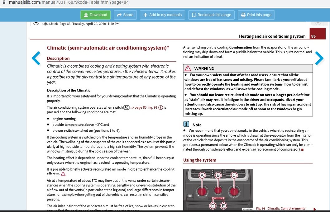

I read Mk2 Fabia Owners manuals and any typos / revisions and there it said + 2 degrees C for the AC to work.

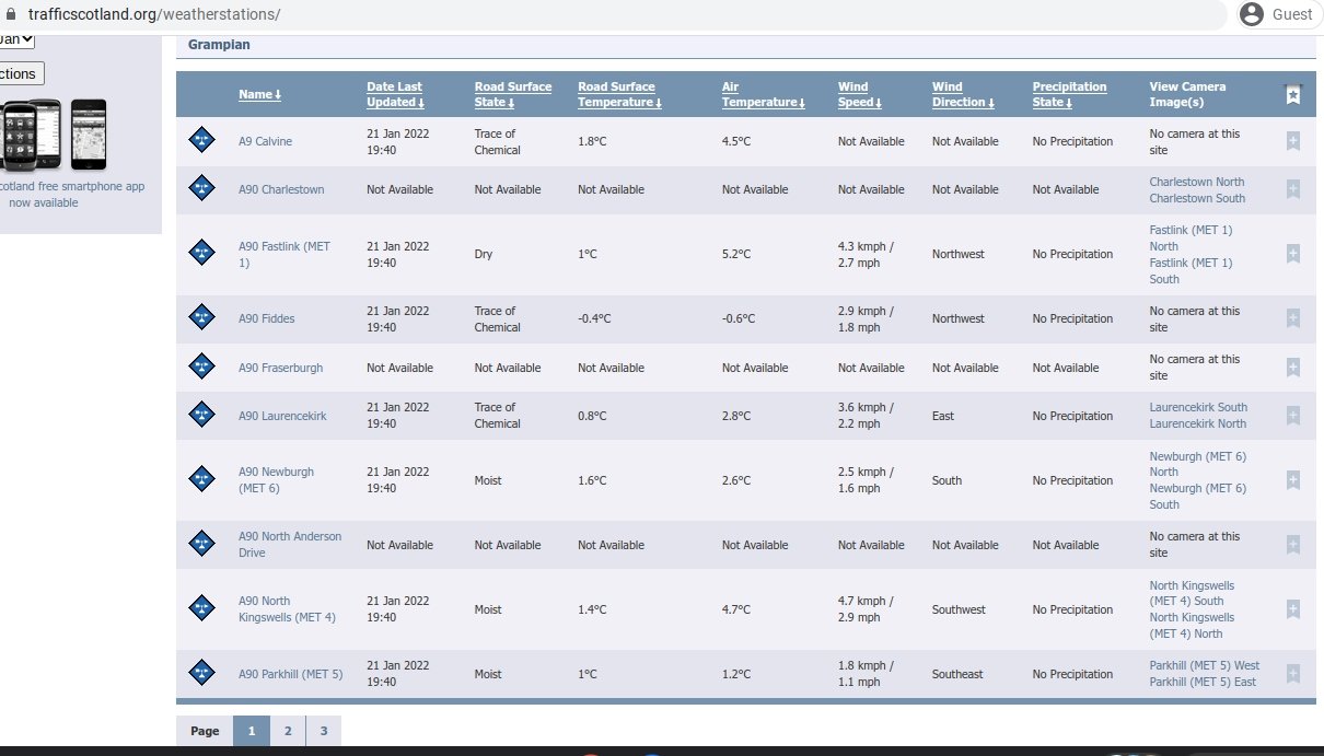

Remember that cars take the ambient temperatures at different heights on different vehicles.
Some might be at the front and low or at the mirrors.
The temperature is different at Grass / Ground temp or 'Air Temp' which is well above ground temp.
There can be a few degrees temp difference 0-18" above the ground or 36" above.
