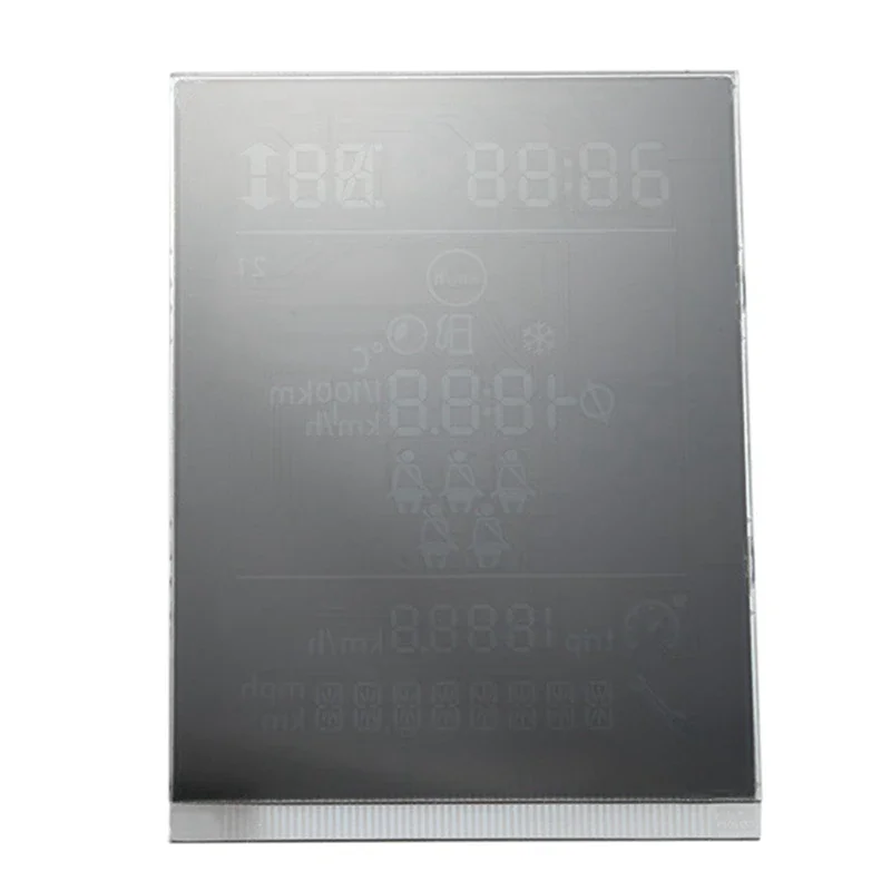

Aliexpress for £45 but it looks like km instead of MPH
On 23/01/2022 at 17:53, DEL80Y said:
km instead of MPH
I doubt they would have manufactured two different units with mph or kph so it may display mph when fitted. though stranger things have happened.
Thats what i thought till i seen the pic
The display is just an LCD matrix, its neither miles or kms nor English, French or Chinese, it illuminates the pixels that it is told to by the instrument cluster controller.
LHD/RHD and miles/kms etc are all coding settings for the instrument cluster, changing the LCD display will not change the coding or the information displayed.
Editted, I am having my doubts about the above, I was speaking as if it were a Maxidot display but looking at the ghost image in the photograph I am not so sure now.
Edited by J.R.
Agreed. the pre defined areas that can illuminate are visible.
