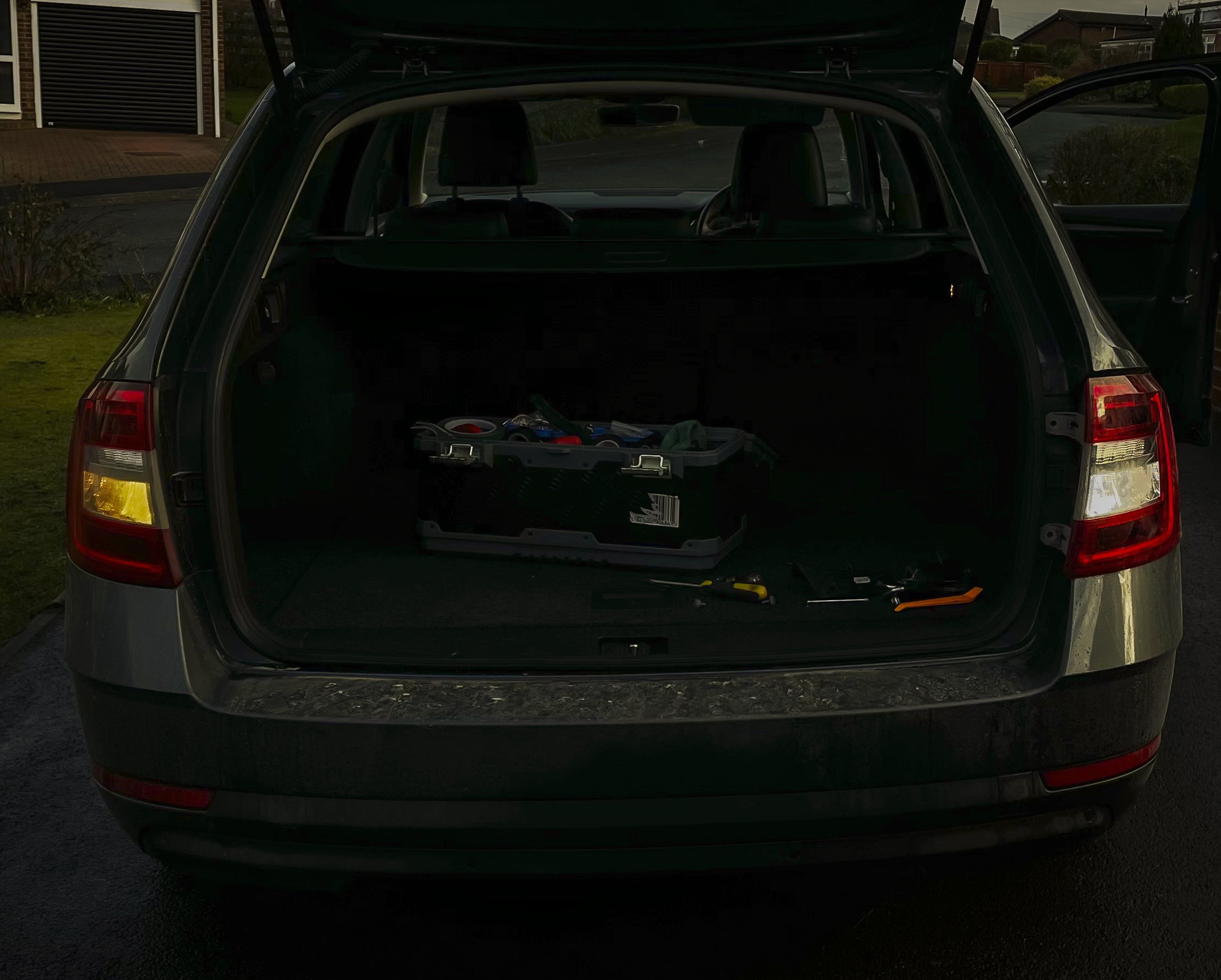

Took the old LED Bulbs off the yeti, Which I had in the reverse and rear indicators, to go with the LEDs on the front and the LED side lights.
Was quite difficult getting the phone camera to give an accurate difference in the reverse bulbs. These don't show any errors and I told the car through Carista that they are upto 12w LED's so they don't flash on start up, well not that I have noticed yet!

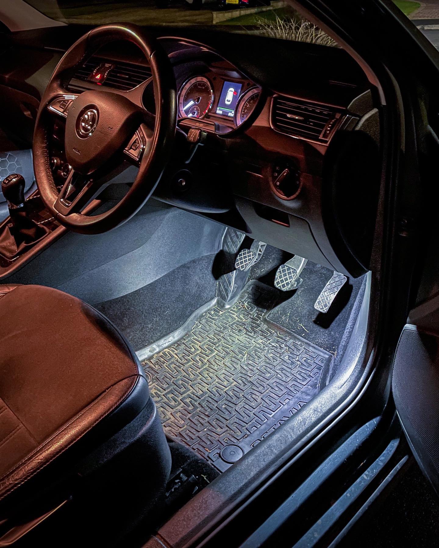

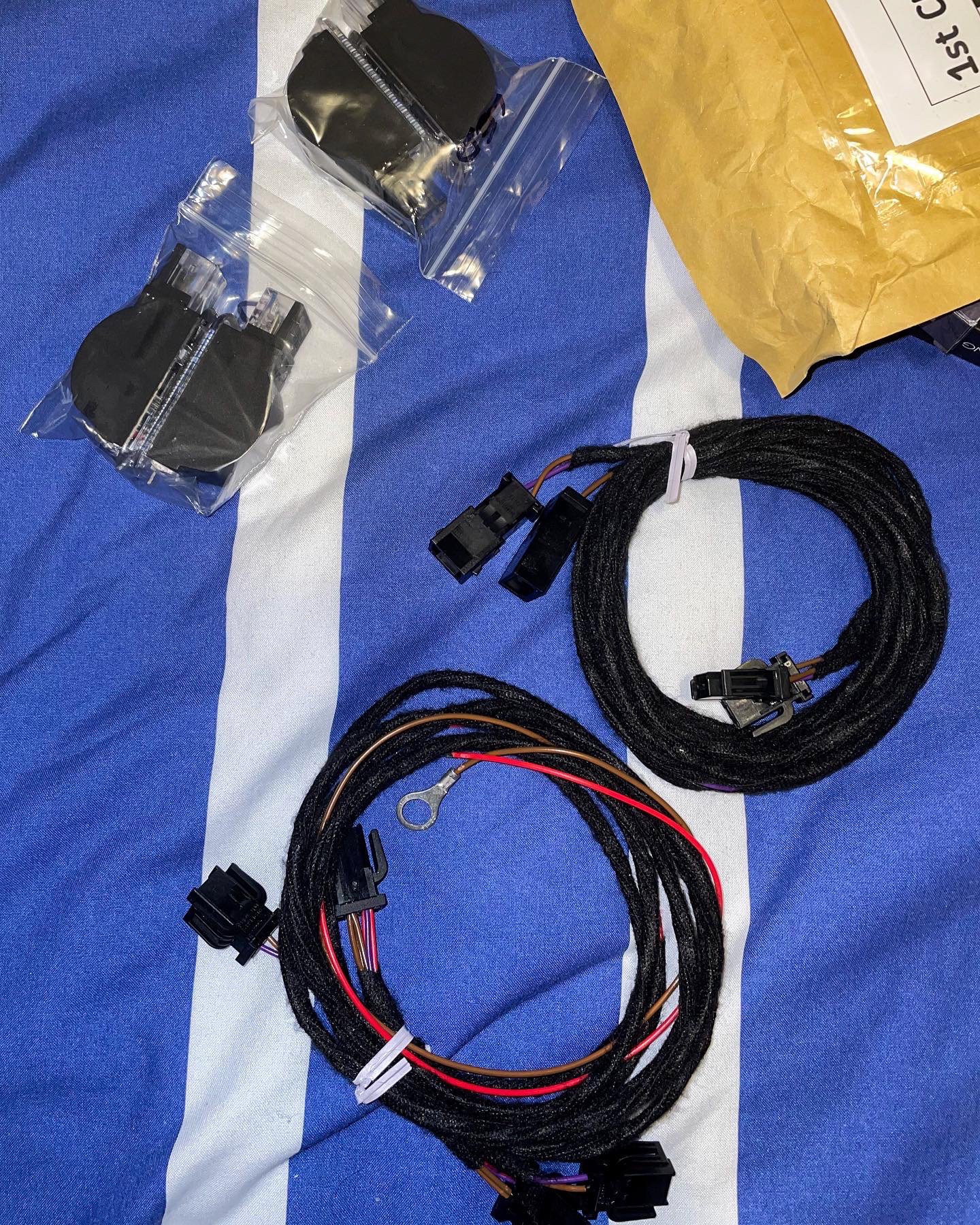

Ordered some footwell lights from Rocket wires, Really nice kit and the looms are really nice quality.
Received them on Saturday, but was out all day on call.... so braved the weather and between rain showers on Sunday to install them for the front anyway.
Included was an E-mailed set of instructions which was really easy to follow.
Fresh out the packet!

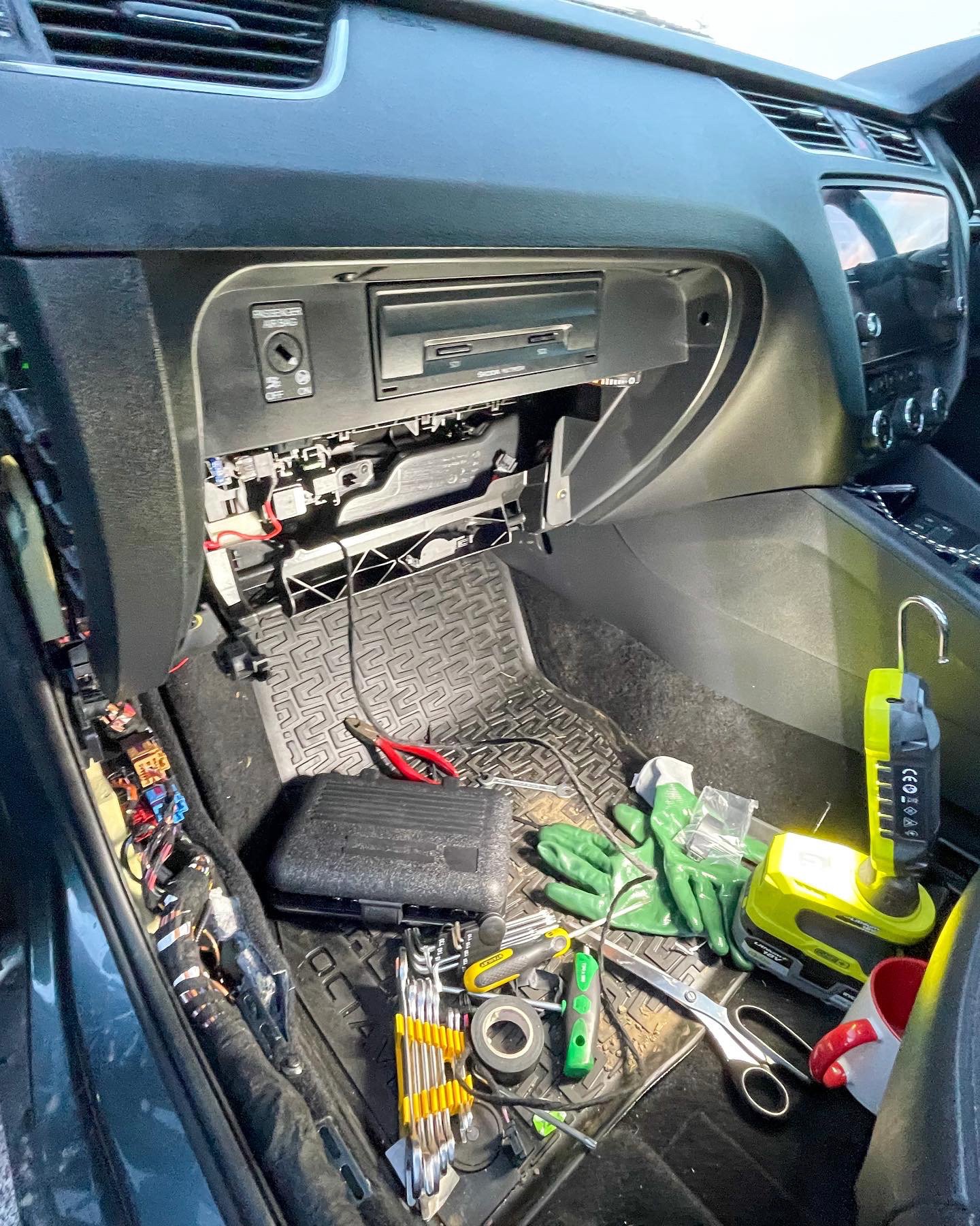

Took out the glovebox for easier access, and helped to route to the drivers side.

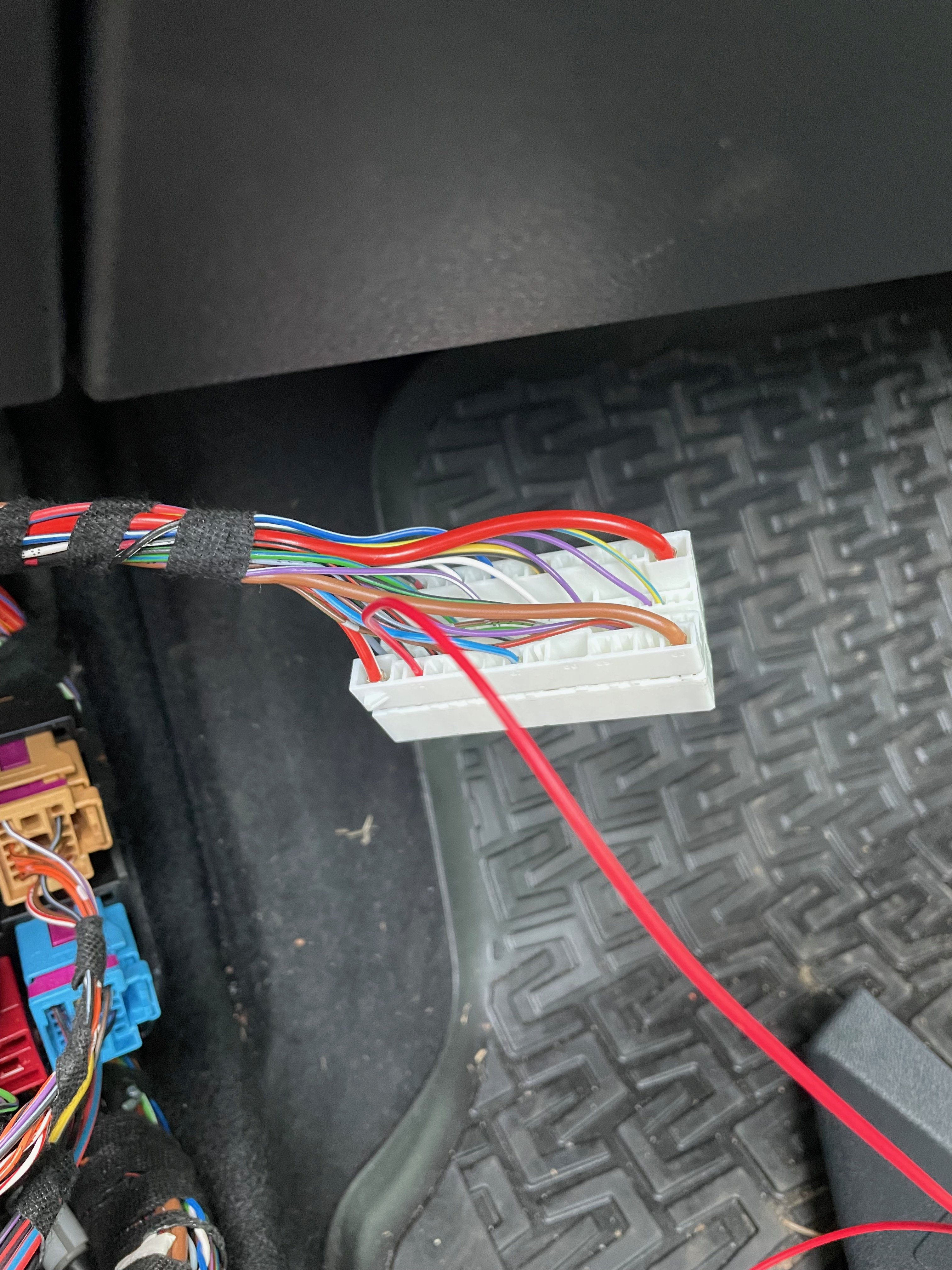

Took the BCM Plug out and wired in as guided by the guide, I've bought his kits before and always liked the integration with the OEM equipment makes it a pleasure to add this OEM+ stuff.
Took about 30 mins to do the fronts. Left them there as I needed to go out, then coded them in with VCDS when I got back.

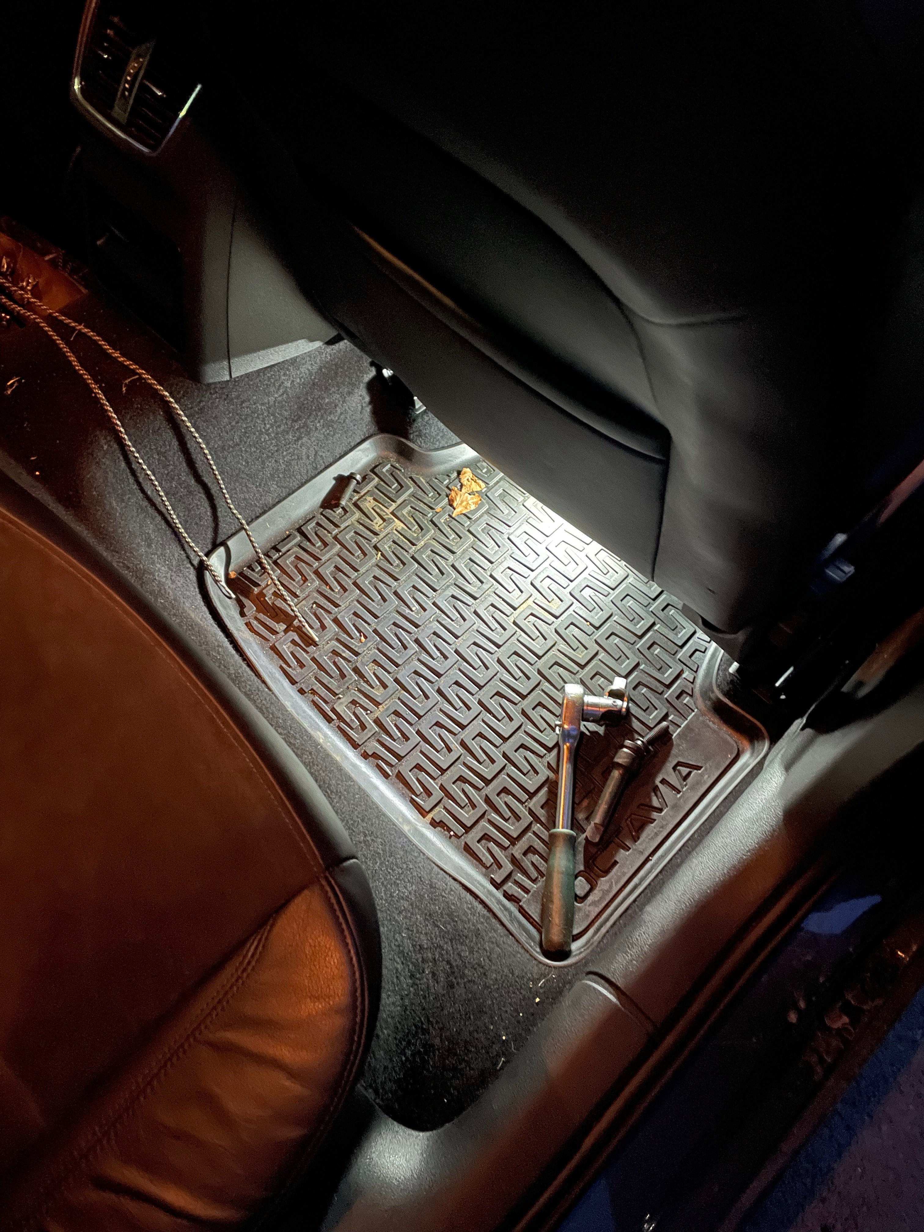

The other evening I had some time after work so got on with getting the drivers rear wired in.
Managed to get the seat lifted enough so I could route the cable along with the other cables that come up from the floor for the seat. and loosely tie wrapped to the main loom to allow free movement if & when the seat moves.
All finished!
He does door bin illumination, and the illuminated door warnings which may be my next purchase....

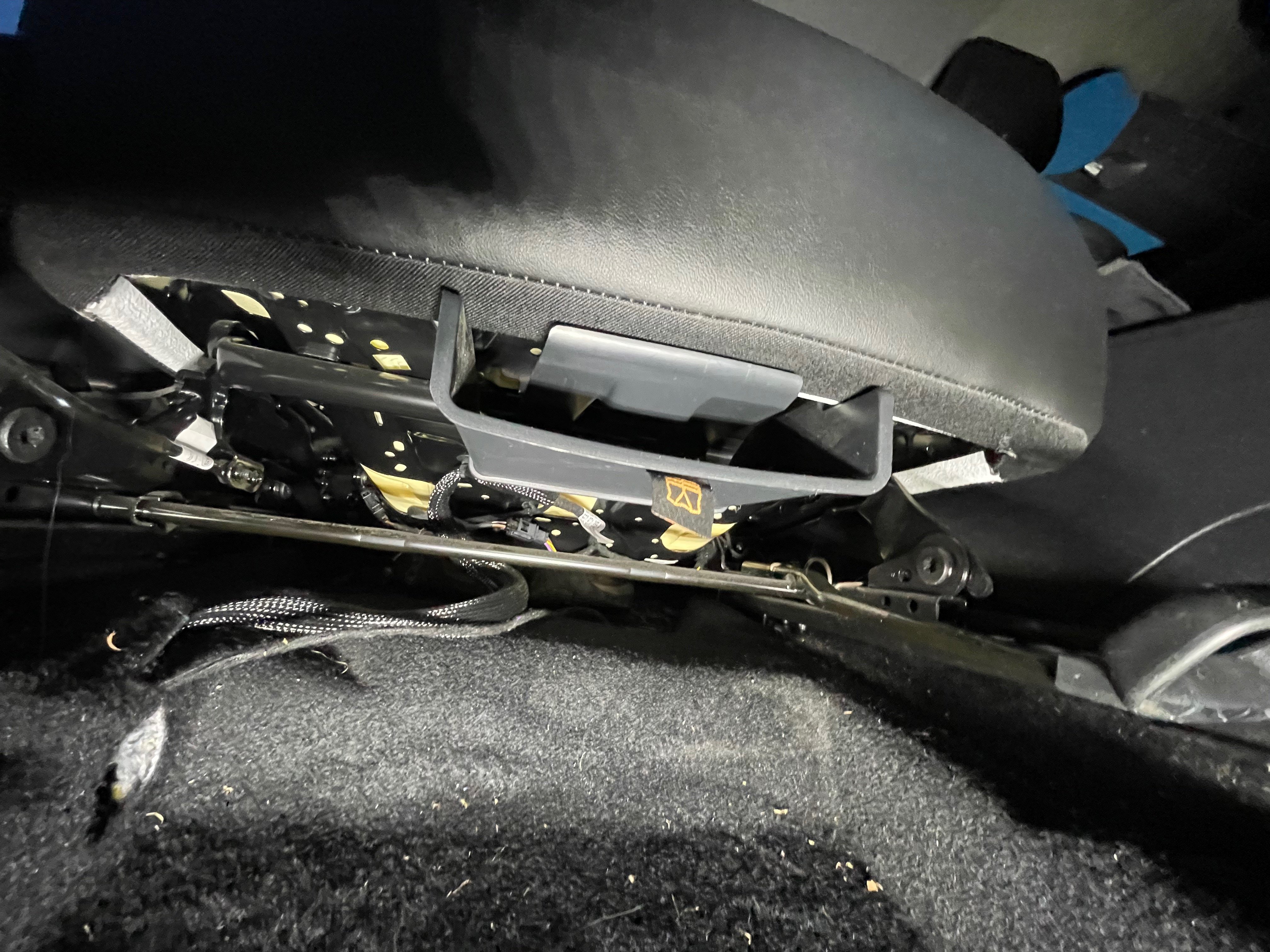

Finished off the footwell lighting.
Found it easier to remove bolts for the front seats to nicely route the cable through!
Loosely tied up with cable ties, this is just so I can make sure the cable Is routed properly, then I tightened them when I was happy.
