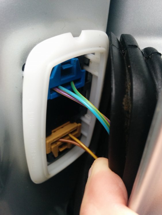

Right little update ive got the trim pieces removed and im at the speaker wire connections so I need the wires on the middle plug to connect to but cannot for the life of me get this plug to unplug, is there some sort of catch or something so I can release this plug as I dont want to force anything and I have very little spare wire to play with on these.20220125_150344.thumb.jpg.577f2f218c5c0ff43caf54eb986efa9c.jpg

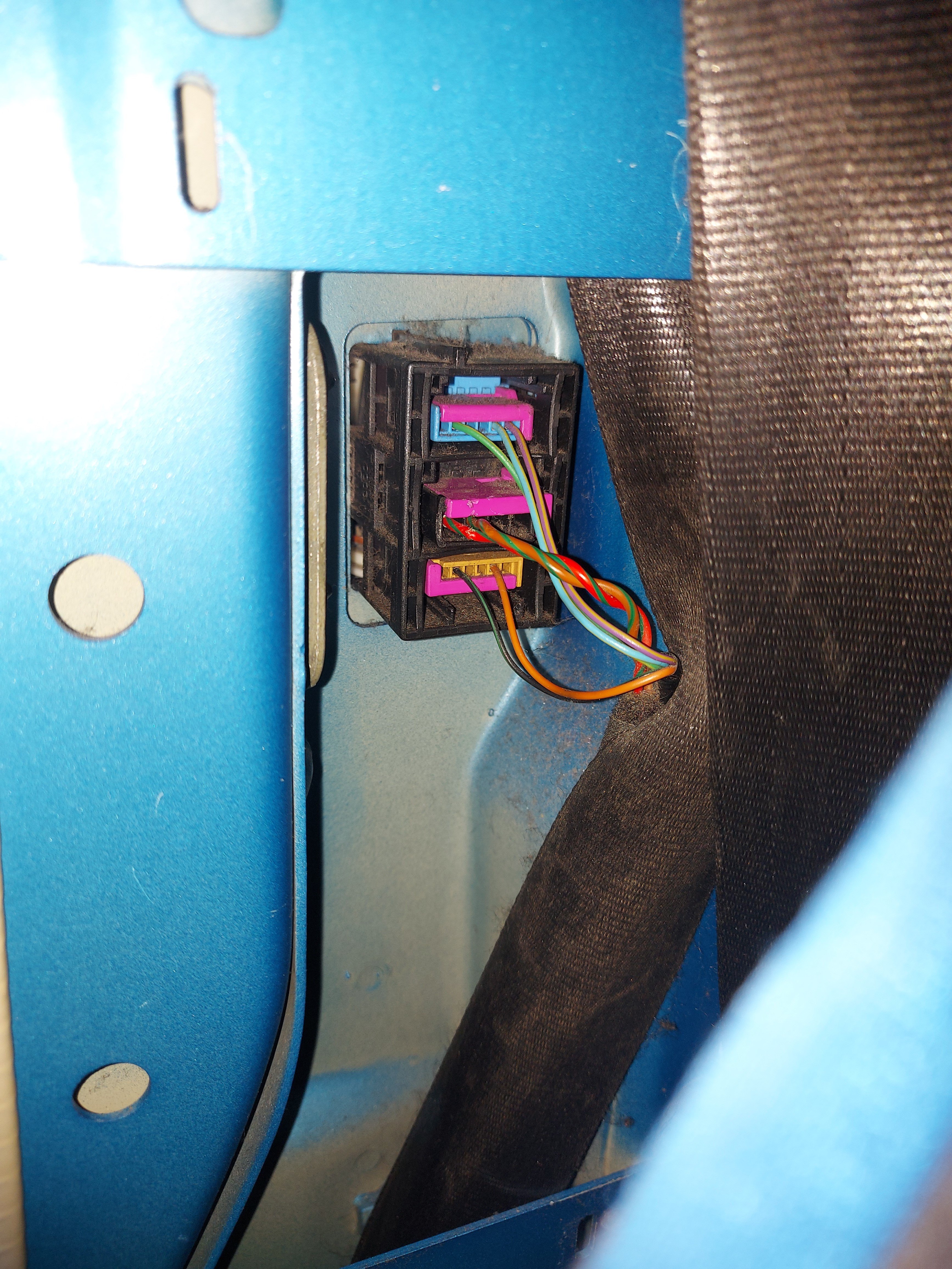

I think firstly you'd have to remove the plug(s) from the front of that B-pillar connector station at the bellows as they will be locked into those rear bits and won't let them come out. Then there must be some kind of clips to get the rear sockets out.
Front of B-pillar connector station...
IMG-20180404-120306-thumb-jpg-3d727697be
I think to relase the rear sockets once the plugs are out you probably do it from the front with a small screwdriver to release the cut-outs in the sockets from snap catches in the black cage housing.

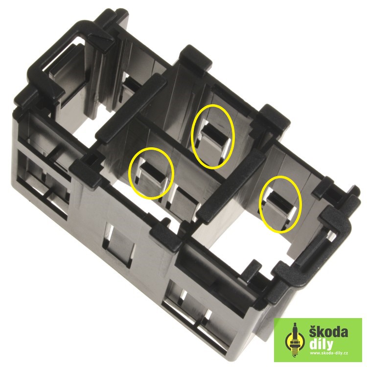

Like this....
There will be locking tags like these in the cage.....

I got it disconnected other side already figured it was some sort of latch that pic has clarified it thanks mate reckon a slim electrical screw driver both sides should release it like doing stereo. Thanks bud 👍

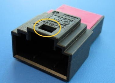

Should be able to release the locking tabs by poking a screwdriver in the socket slots and pressing the tabs with it.
Front shown here but should be similar....
Edited by TMB
Used the metal prongs that you slip the stereo out with and the plug slips straight off then :)

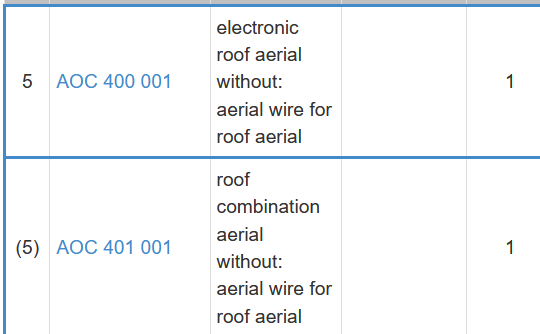

Or there is this one https://www.ebay.co.uk/itm/122375468802 seems there are 2 types of connector the push in one and this screw fit one does anyone know which mine is please im assuming its most likely the push fit one ???
I was trying to see if I could get part before I had to tear out the trim lol will drive me scatty driving around with it out and im not one for double handling so wanted it out once and done lol oh well guess I best go strip it out and look see 😐

yep thats my connector mate thats what I need I found out by buying a complete aerial and base from halfrauds and decided to open the base up and no circuit so that went back then looked into a couple online and thay were both the same no circuit to them so looks like what youve posted up is what im in needf of :)
