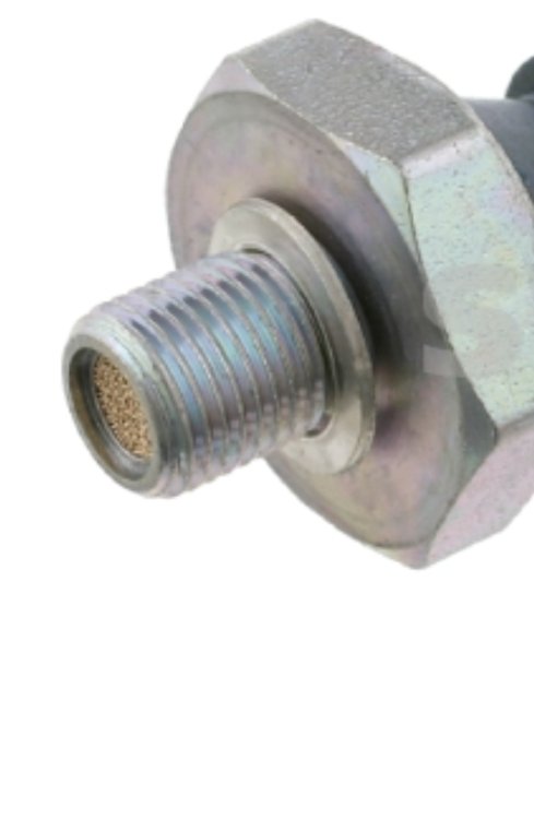

Maybe it doesn't matter what color it is, if your sensor has something like this sieve on top. I think the cause of the error is that there is sediment from the oil that closes the oil flow and the sensor and reports an error to the computer. I replaced that sensor, it was located in the front, it is easy to change. first I removed the propeller from the cooler to have easier access with the tool.
