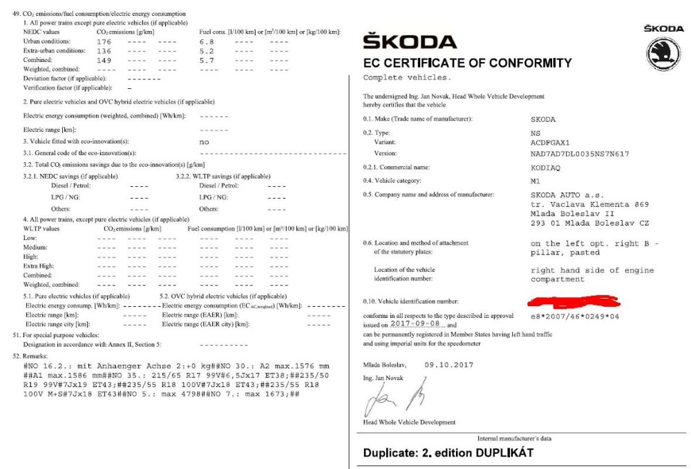

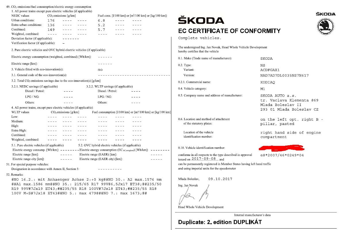

Ask Skoda customer services for a copy of the car's "Certificate of Conformity".  They're unique to the car and will list all the wheel and tyre combinations that were homologated for your car.  (Bottom left on the image below, for our car).
Thanks a lot for your feedback. It is now clear to me that the specific wheels I was looking at will not fit Kodiaq although advertised as such - 225/50 R17 will definately be too small.
