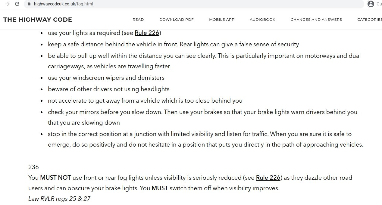

Regardless of the EU / UK or whoever allowing the fitting and enabelling, the Highway code covers the use of Fog Lights and the Police know if there is a car sitting and the Rear or Front Fog on as they drive towards that vehicle.
The know if they drive towards a car sitting waiting to reverse into a drive and as the driver selects reverse 2 front fog lights some on.
Well off topic, but the Type Approval and the Highway Code and UK Traffic law have never actually joined up.
I have never understood why someone that wants Front Fog lights to illuminate as they reverse can not just switch on the Front Fogs when needed, then off once they have done their parking.
It is the UK and Car D1cks with Fogs on anytime or all the time is just par for the course.
