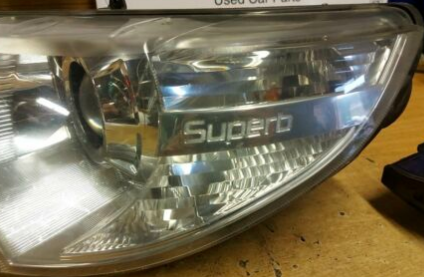

I find the easiest way to spot the difference between Pre-FL and FL is the headlamp lenses and estate tailgate.  The Pre-FL headlamps have Superb logo embossed into the front lens:
Whereas FL cars have no such logo.

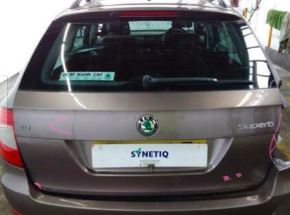

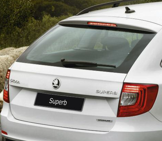

The tailgates on FL estates have a more angular design in keeping with modern Skoda family design like this:
Pre-FL are more rounded like this:
