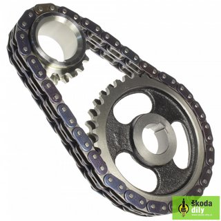

Nope, the Fabia 1.4 mpi, 8 valve engine is notorious for timing chain rattle. There is no tensioner in the design so when the chain stretches it thrashes about. They are a duplex chain and I've never heard of one breaking, they just make an annoying rattle at idle. New ones only last about 20,000 miles before starting to rattle. It was the same when this engine was used in the old rear-engined Skodas as the design has always been the same.

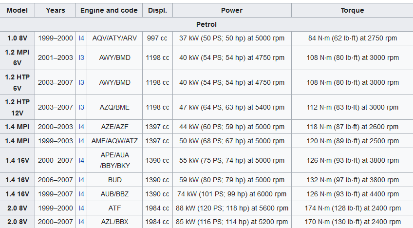

Here are the Fabia MK1 petrol engine codes...
Jesus, is that where peak power* comes in on mine?! :o
*in a relative sense... compared to a milk float.

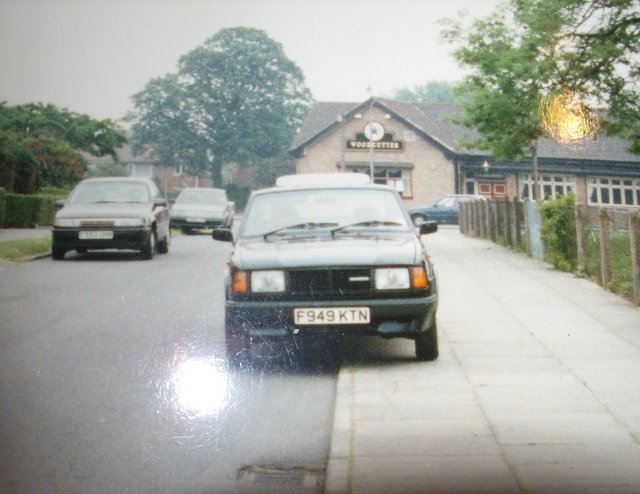

This is the only pic I have left of my Rapid 136...
It was epic fun, like driving a go-kart.

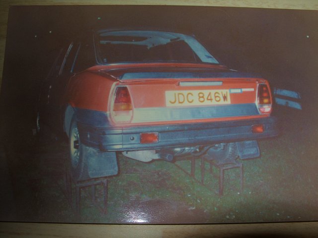

Might as well completely derail the thread with a pic of one of my Estelles, a W-reg (1982) 120LSE. I had it up on ramps because it was feeling poorly 😛

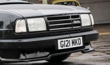

Mine had the very last grille design. This one....
^ EDIT: But it broke because the plastic was like something out of a chocolate box, so I replaced it with a normal Estelle 2 grille.
