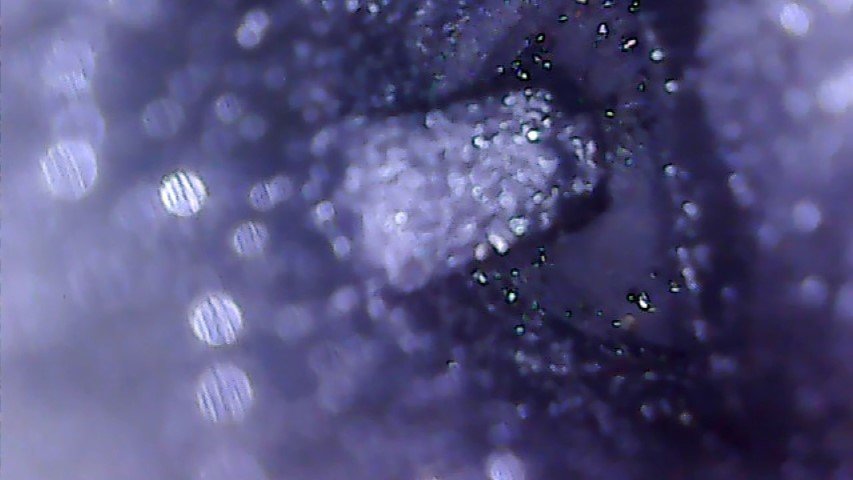

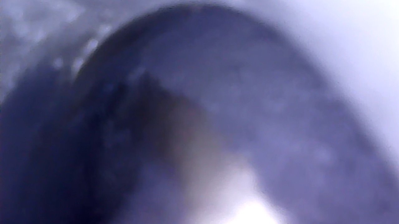

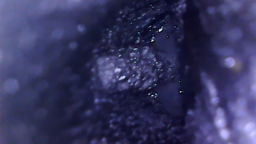

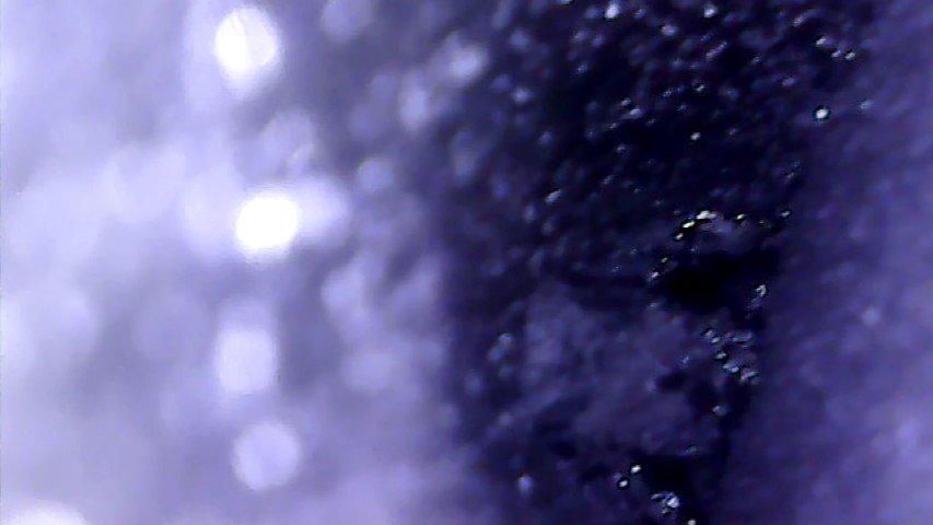

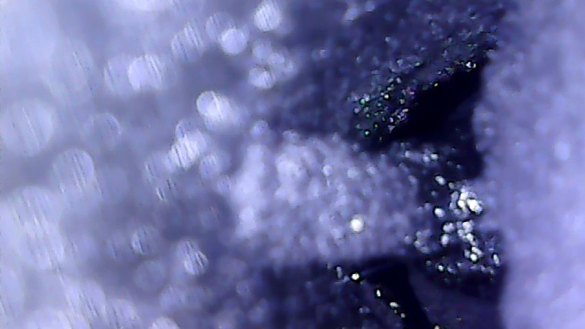

Hey all,
Have previously posted regarding misfires and rough running / poor acceleration on a 1.4 tsi (122 caxa) octavia. We ordered a new injector, and whilst fitting it elected to clean out as much as possible of the carbon buildup in the intake. The car had done 86k miles at that point, and the state of the intake valves was pretty horrific. I've attached a few photos, which aren't the clearest but came from a cheap endoscope camera - it may tempt some of you to check yours! Whilst we couldn't reach all of the valves due to the fixed runners, the valves had significantly less build up afterwards. The car since has accelerated significantly better, fuel economy seems to have improved and it's just generally a nicer drive.... or it was.
