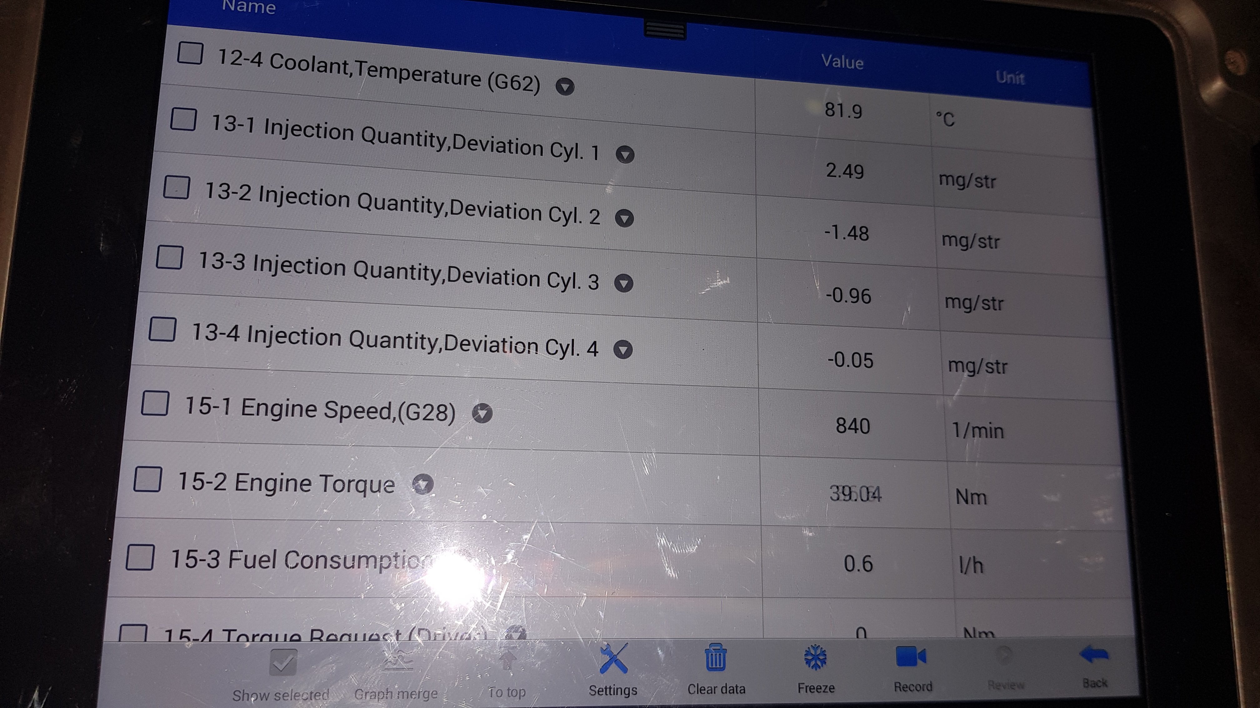

I've taken if to a local friendly garage who have put if on their diagnostics and the attached pic shows what the injectors are doing on tickover.
I did a video of them as well. And they are ranging as follows over a 30 second period at tickover (820 rpm).
Injector 1 ranges 2.33 to 2.52 mg/str
Injector 2 ranges 2 -1.39 to -1.53 mg/str
Injector 3 ranges -0.89 to -1.04mg/str
Injector 4 ranges -0.09 to 0 mg/str
None of that means a thing to me :blink: but I assume it ain't normal.
