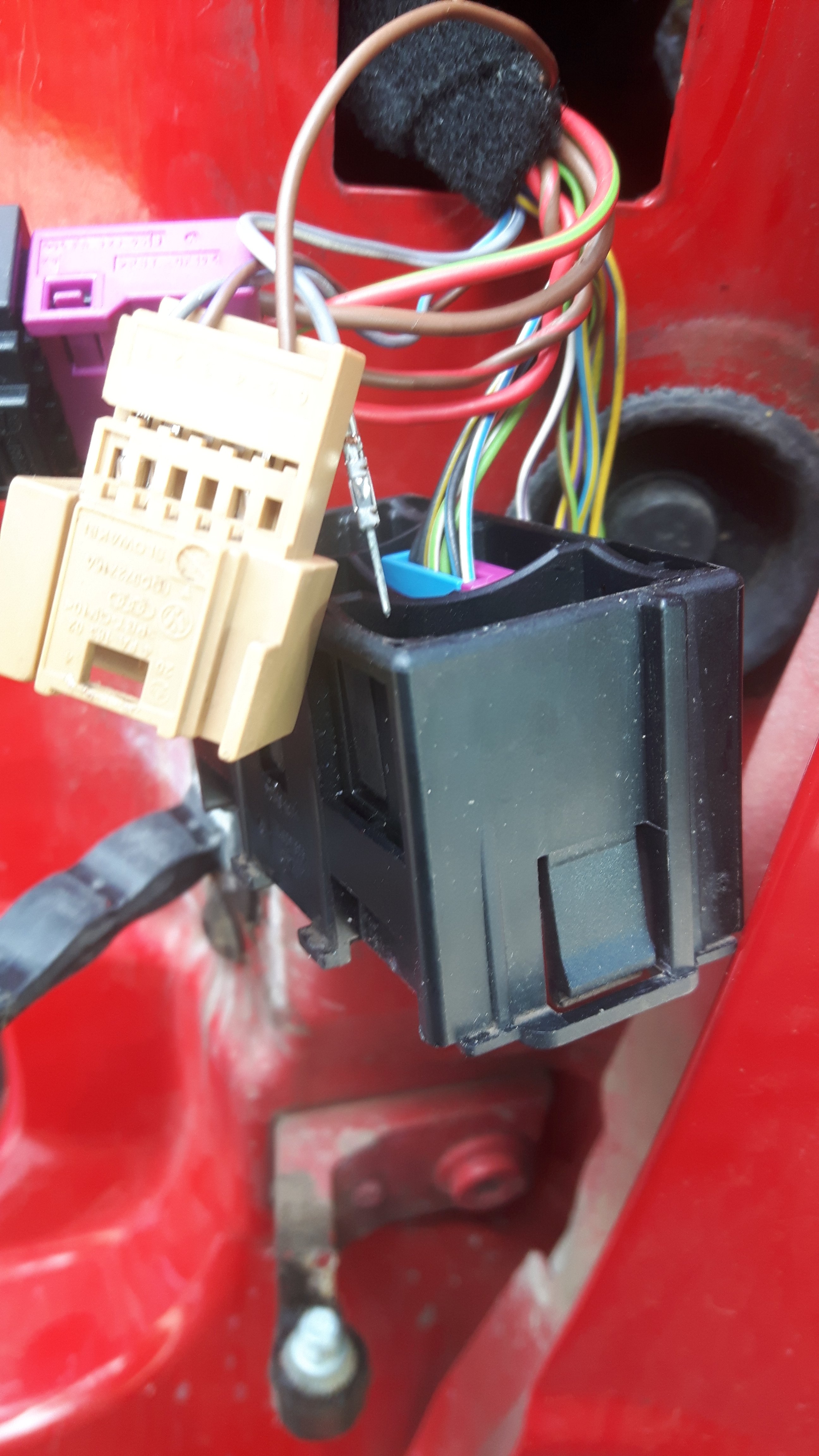

I even took pics, apparently. Different arrangement on the mk1 Fabia though, four separate male connectors within the overall black 'carrier', which - unlike yours - appears to itself have to be inserted from the outside.  So on the Fabia it looks like the (4 individual) loom connectors get posted out through the hole, clipped into the back of the carrier and then that clipped into the hole from outside inwards.

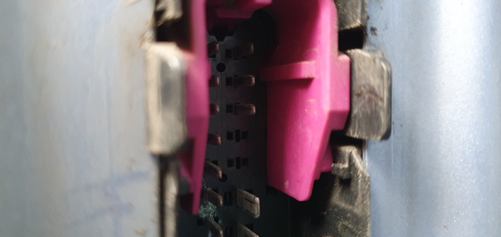

Why the need to replace the male conn?
Corrosion (some evidence at bottom of your pic) or pin breakage? Is there a problem with door function that is being attributed to pin corrosion/damage?
