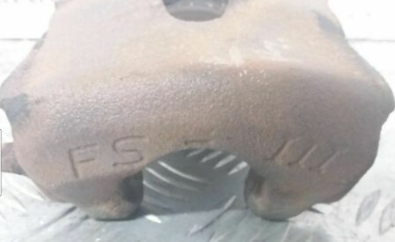

Do you know what size your front brake discs are? 256mm discs have calipers with "FS III" stamped clearly in the outer face:

Really need to eyeball a front brake caliper. If you jave alloys you may be able to see through a gap?
Standard wheels on nights tonight will have a look tomorrow 👍
