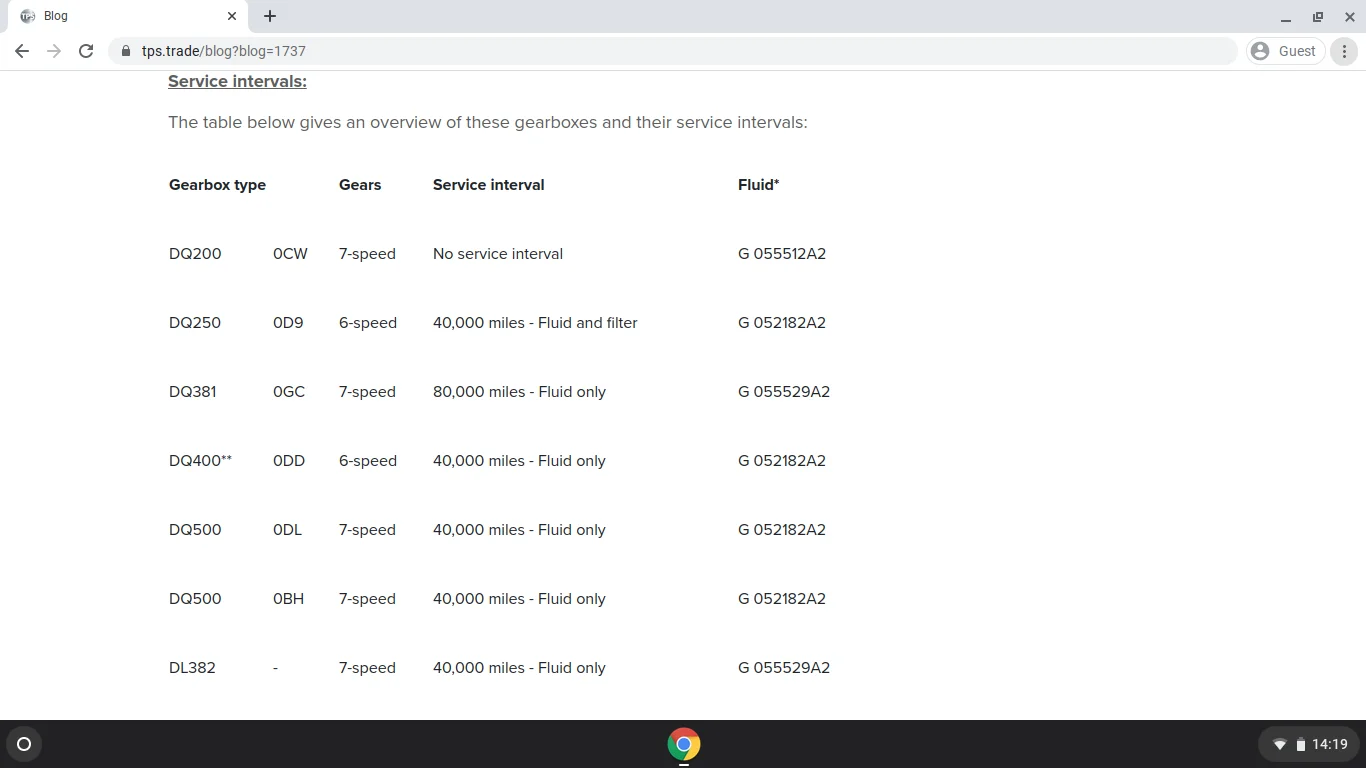

^^^ As above, it is DQ200 DSG 7 Speed Twin Dry Clutch DSG's that have no service intervals, no recommendations for Oil Changes.
(Fitted to FWD (front wheel drive) vehicles with 250 Nm or under and 192ps or under, 1.0,1.2,1.4, 1.5,1.8 TSI or 1.4,1.6 TDI's.)
The DQ200 DSG is not used with AWD's so cars with Haldex.
** so 1.4 or 1.5 TSI with Haldex do not have a DQ200 DSG.**
