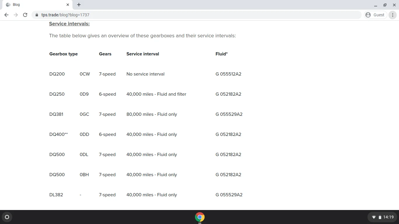

The Oil Change interval is @ 40,000 miles / 65,000 km.
It would be nice if it is a battery on connection issue. Best find where the leak is from and if it is from the MCU and there is any pressure issues.
Your box has the same oil in the box and mcu.
The DQ200 DSG's that do not get oil changes have 2 oils, 1 in the MCU and different oil in the dry clutch box.
