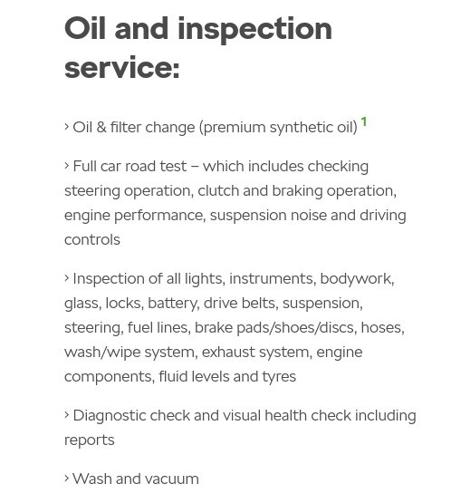

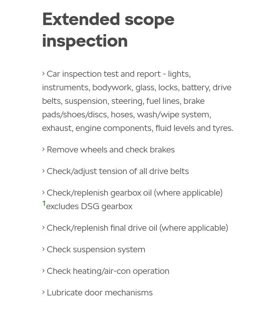

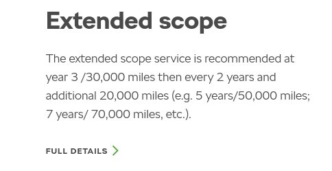

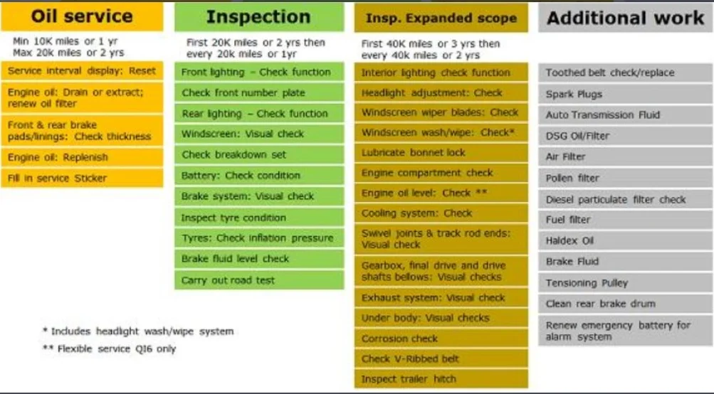

This gives an idea of what Skoda shows for year 3 on.  (Fixed Servicing)
Not that Skoda Main Dealer Servicing means it is done, the customer pays for what they want changed.
Years 1, 2 or 3 might have little done even if there was a service plan.
If there is a FMDSH you want it to show the history of what actually has been done at workshop visits.
1168293554_37335614_Screenshot2021-09-14at07_38_18(3).webp.ee5b8a609f78b3b2f42441d7532010fa.webp.03b06c85571b53b664b7942fca3ad3bc.webp
