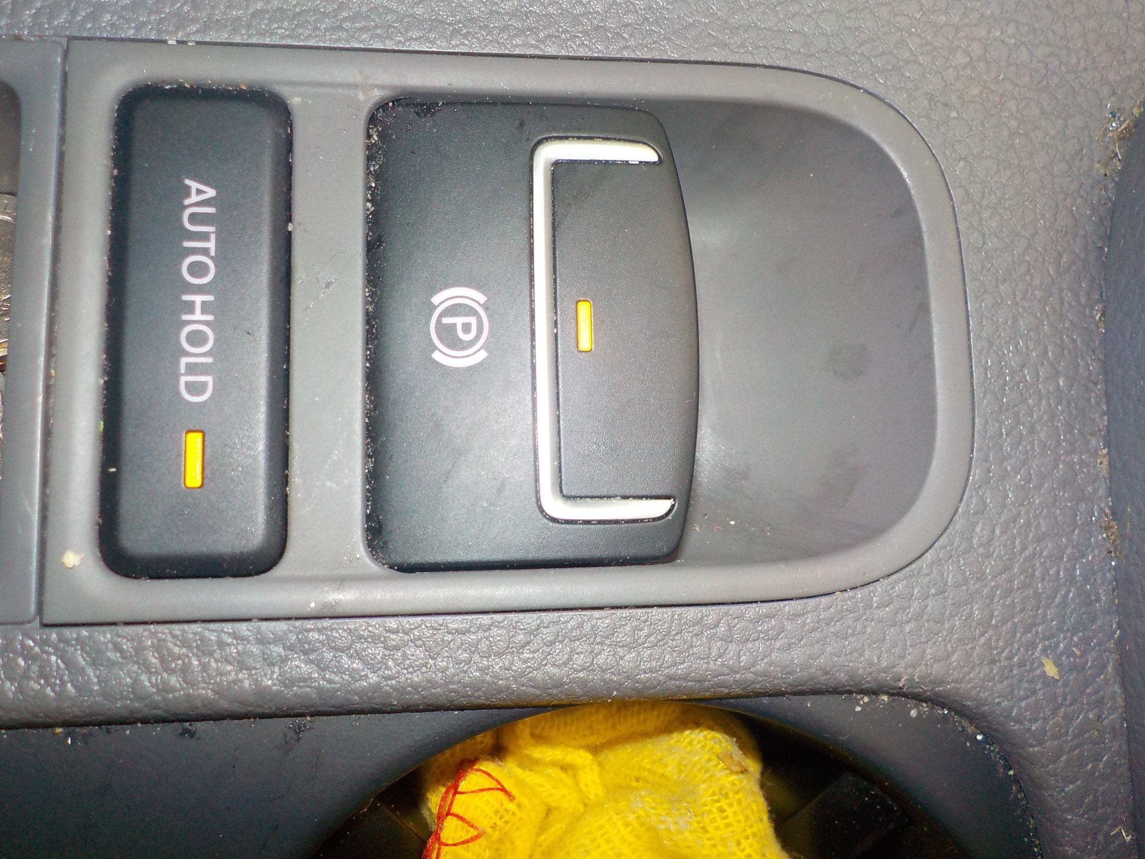

@j caffBecause i have drive VW Group cars with DSG's and e-Brakes that did not need 'Autohold' on to have the e-Brake activate.
Well, the superb does...
Apparently so as we know having read this thread and the linked one.
