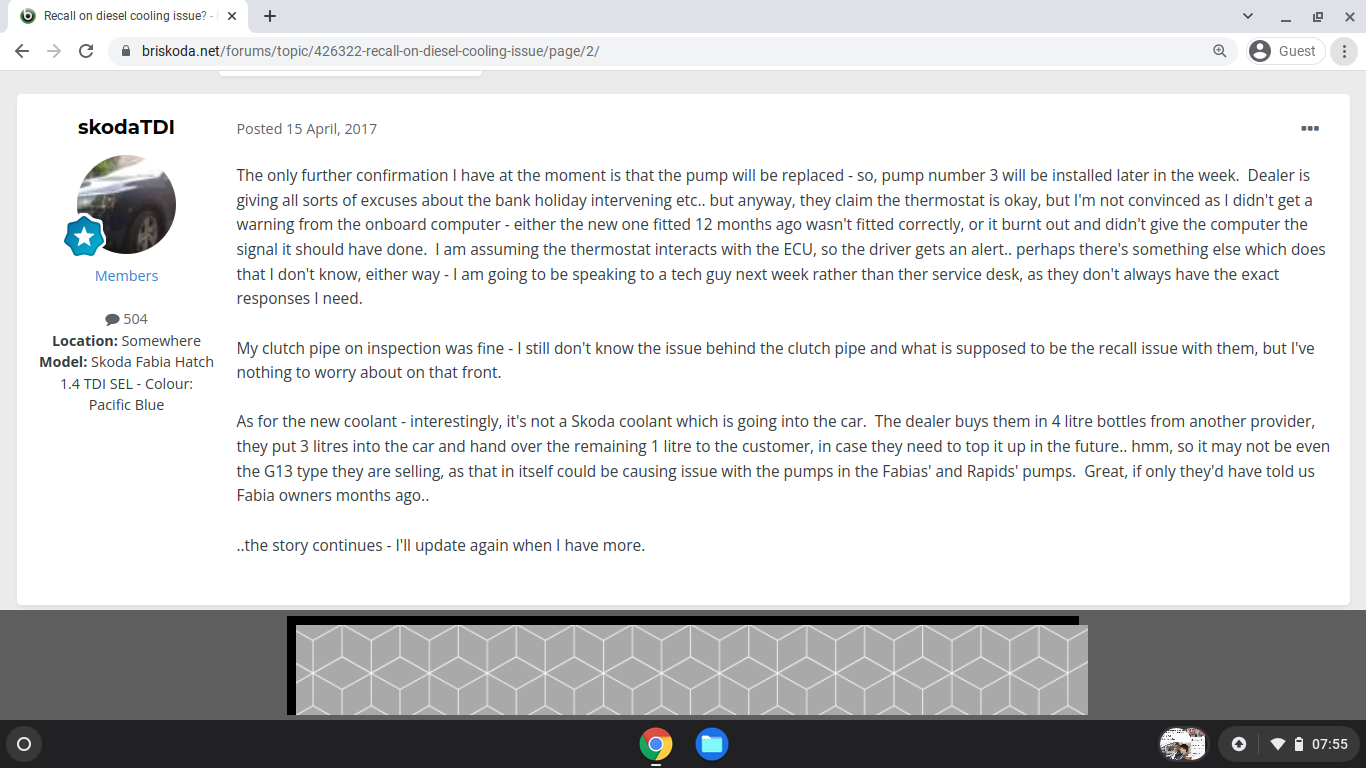

What engine does your car have & how old and why is the coolant dropping?
(I know coolant can be lost but is it slowly over a long time with your engine)
Is it a 1.4TDI?
If so see the linked thread at the top of the section.
Edited by roottoot
