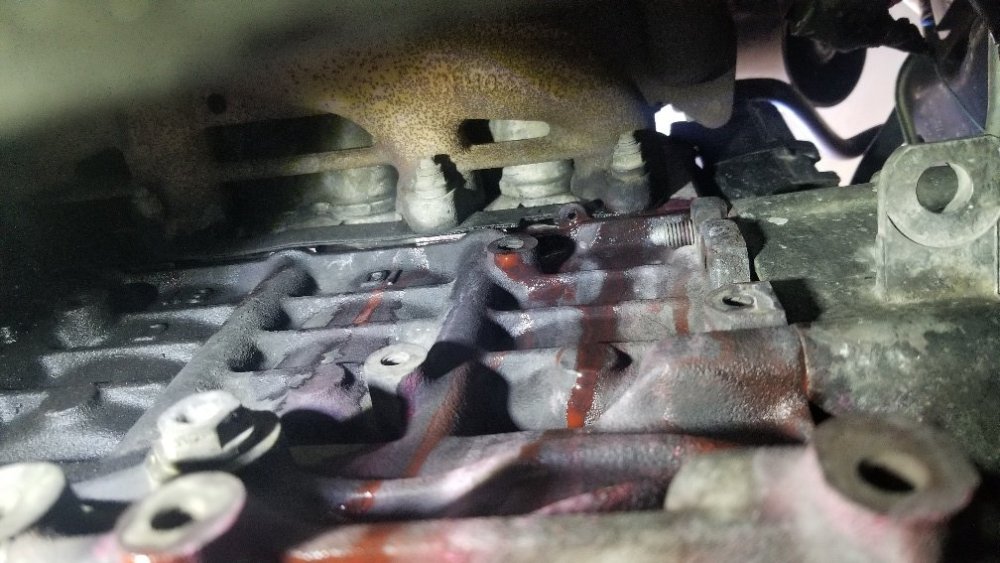

The amount of time ive been working on cars... I can assure you using the wrong coolant causes 2 things - jelly like substance or corrosion to the cylinder head if ally - not a quick process and happens over 1000s of miles and years.
What youre doing here is conformation bias, youre looking for things that support your line of inquiry rather than facts - random websites and forums with out dated information and people with 'trust me bro' knowledge is not a reliable source.
The reason youre chasing leaks is simple - a leak allows pressure to be lost, pressure will leave via the easiest point, the weakest. You fix the leak which is the weakest, that pressure then finds the next weakest spot to escape and it carries on.
The photo you posted its hard to tell but its either leaking from the side of the head and running round or that head gasket is fubar. My guess is the latter. If your head gasket had failed this badly as you say from incorrect coolant, all the seals would be falling apart and water pump, thermostat, headgasket to oil and to cylinder would all be leaking.
