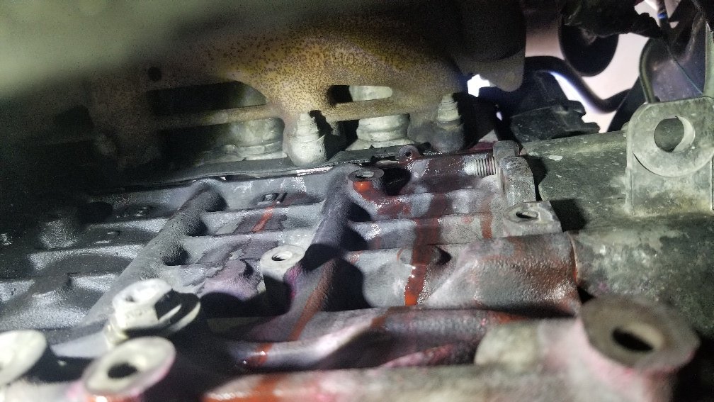

3 minutes ago, Kharl said:
And  there are the leaks…
Where?
1 minute ago, Pete_Ex-Wino said:
Where?
oh, yeah, hahaha sorry! 🤦‍♂️
here are the leaks
  • Sponsor
So that's looking upwards towards the head/block joint?
Looks like you need a new gasket if it is. :crying:
but the gasket is new, has less than 30k km, i have been told several times here that that coolant causes that, i just ignore them because past bad experiience with them.
and other users with perfect running engine with the same situation after using that coolant.
  • Sponsor
Well, change the coolant and see if things improve. Much easier than changing the gasket!

The photo looked like a head gasket leak but hard to tell, I agree find all the other leaks, I would pressure test the cooling system, if that reveals no leaks then I would retorque the head retaining bolts, I know that you are not supposed to but if they were not done correctly in the first place...............................
Someone may intervene to say that is wrong advice for a reason unknown to me, possibly liner related so wait a while as despite my instincts I would be double checking that what I proposed to do would not actually cause more problems

Wow, why is there silicon sealant in your head gasket joint?
