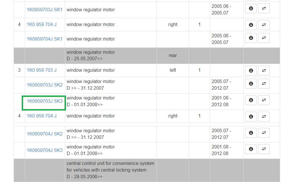

I think you'll find the part number as indicated here, possibly minus the SK3 suffix (not always printed on the part number label, in my experience of other VAG models). Eyeball confirmation would be wise before spending.
