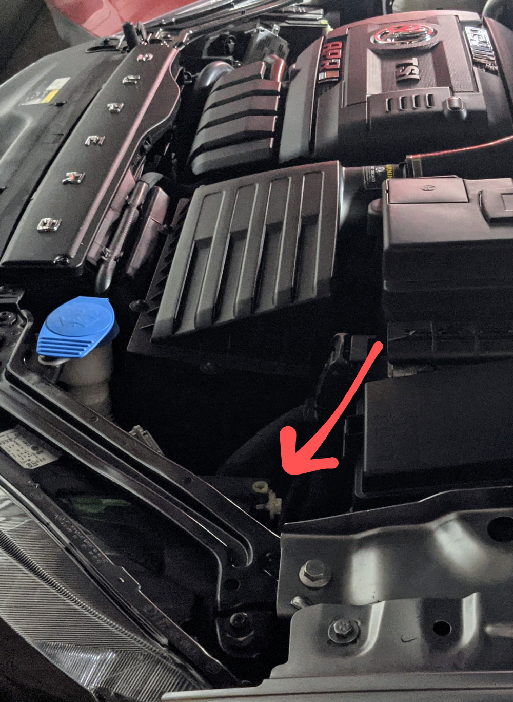

U can make minor tweaks/adjustments of the vertical throw of ur low beams, using the adjuster shown in the pic.
Park ur car approx. 7m away from a wall, on level ground.
Using an allen key, make very small turns of the screw - u'll c the beam either lift or drop.
Repeat the same with the other headlight.
This is how mine looks.
